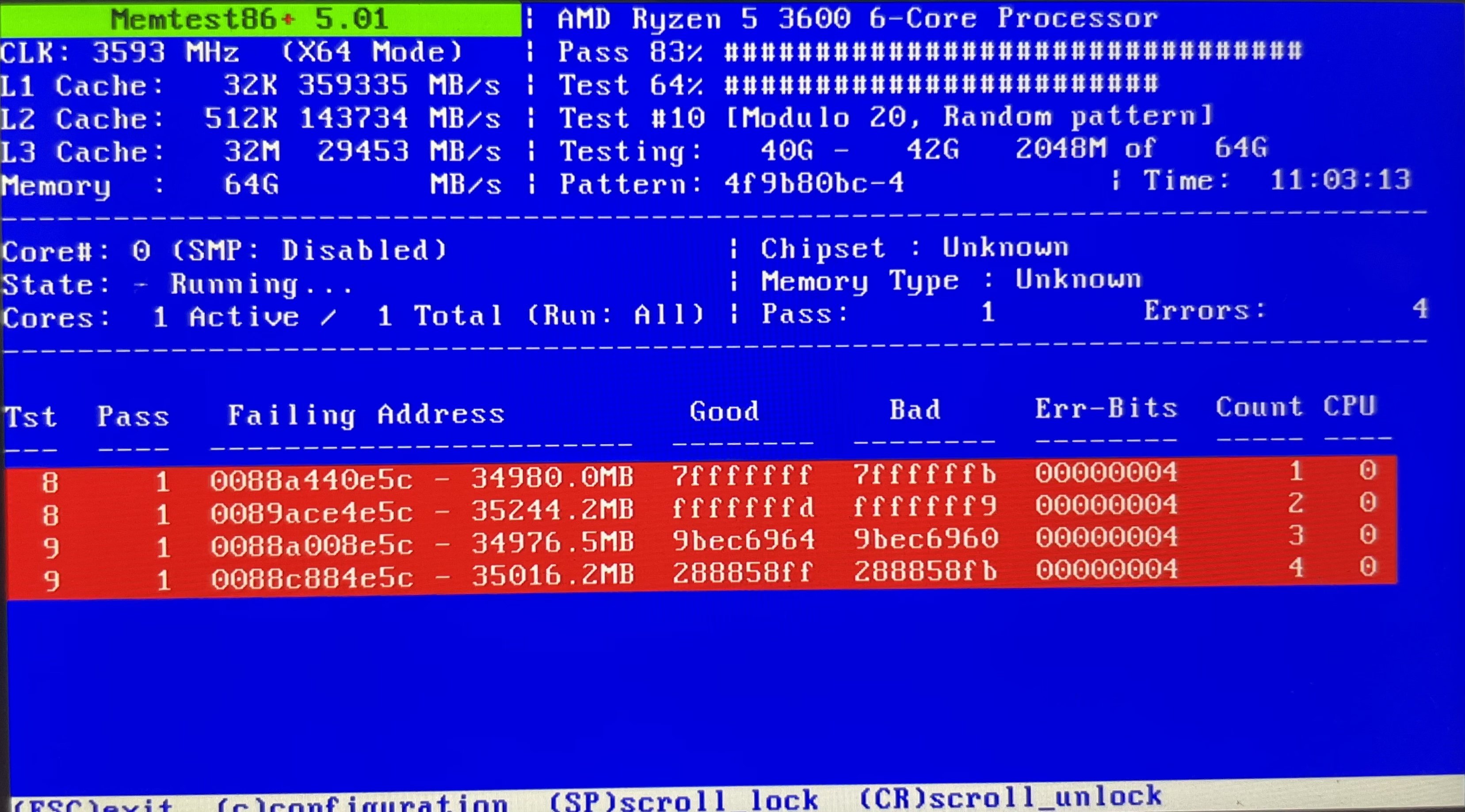

I installed a graphics card. Shall I run MemTest on SMP mode or standard?
this is what I got. Is the ram faulty.
EDIT: @JorgeB Thanks for all the help I think Ram is faulty as you advised earlier. Shall I go ahead and get these replaced. Thanks once again.
Edited by theWhitewizard
No doubt about it, there can't be any errors, replace and run memtest again.
