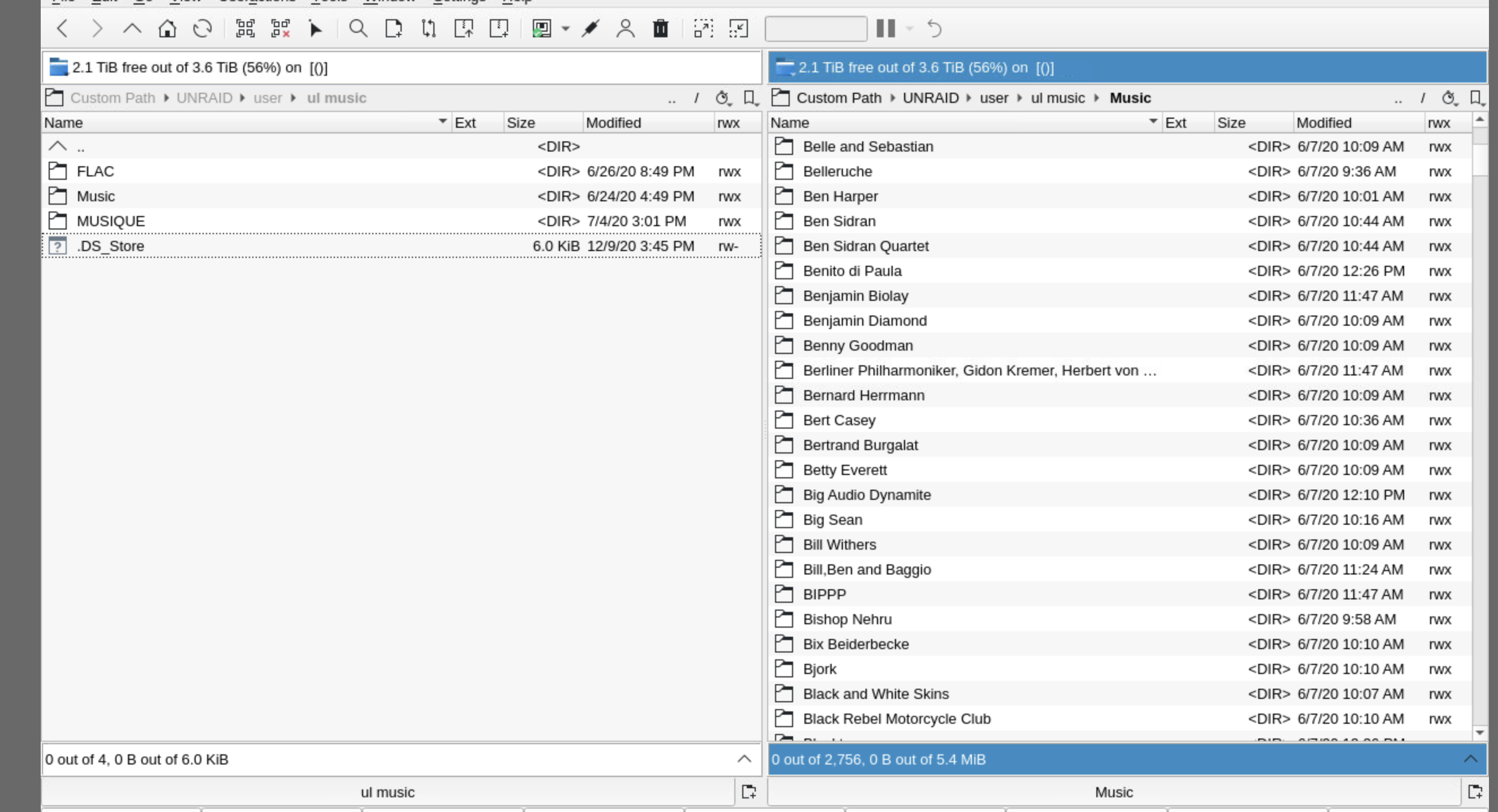

I recently decided to build myself a NAS and quit with all the external SSD. I went with Unraid and am currently in my trial period. Everything went smoothly, a nice learning curve and great videos from spaceinvader_one... until I finished copying all my external drives on my array.

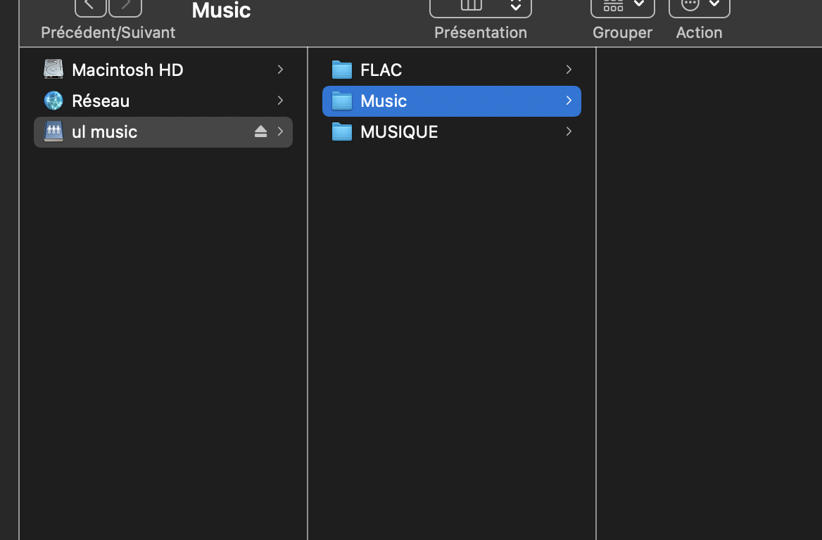

I configured my users and shares, and when I wanted to access some of the files on my computer (Mac OS Big Sur), I noticed that some of my folder are empty, while others, on the same share, appear and show content. I checked the SMB settings, everything seems to be fine; I checked the file system in maintenance mode, no problem; I restarted the array, and then the NAS; I "forced quit" finder, and relaunched my computer... Still the same folders are empty. I know the files are on the disk, as when I open the Krusader plugin in the webGUI, the files are present. I know it is not a problem with my shares, as I have access to some of the files on the shares via my MacBook, while others are missing. I checked the files names, and although some could pose a problem with SMB, I have more than 20 000 tracks in the "empty" folder, so if it was a problem with the name of the files, at least some of the files would appear.
The share is "Music" (I have access to that share from my MacBook) - 3 folders are on that share : FLAC; music; musique - I can see the contents of the FLAC and musique folders; only the "music" one appears as empty.

Found the answer to the problem. Problem came from the indexing on the Macbook. Had to manually delete all the DS_store and ._ files stored on the unraid shares via the following script :
#!/bin/bash
# Version .1 - remove .DS_Store files and ._* files
# Program Body                                                               #
echo "Removing .DS_Store and ._.DS_Store files"
find /mnt/disk1 -name .DS_Store -print -delete
find /mnt/disk1 -name "._*" -print -delete
I also vetoed all these files in the samba extra configuration
everything went back to normal and I can now access all of my files via the finder.
