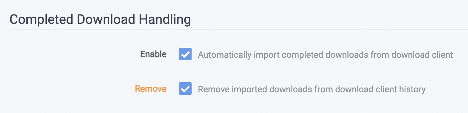

4. Ensure Sonarr -> Settings -> Completed Download Handling enabled

4. Yup it is, see screenshots below.
685276574_ScreenShot2021-02-15at11_58_39AM.thumb.png.81c8b9f9fa1991a9dbe87c5c7a86e2f4.png

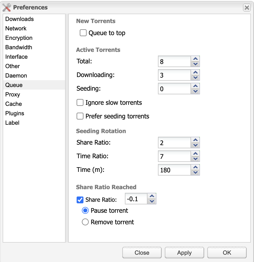

Is my Share Ratio set up correctly?
569221089_ScreenShot2021-02-15at11_08_24AM.thumb.png.7c691ab514ec4eebf4871b9721665450.png

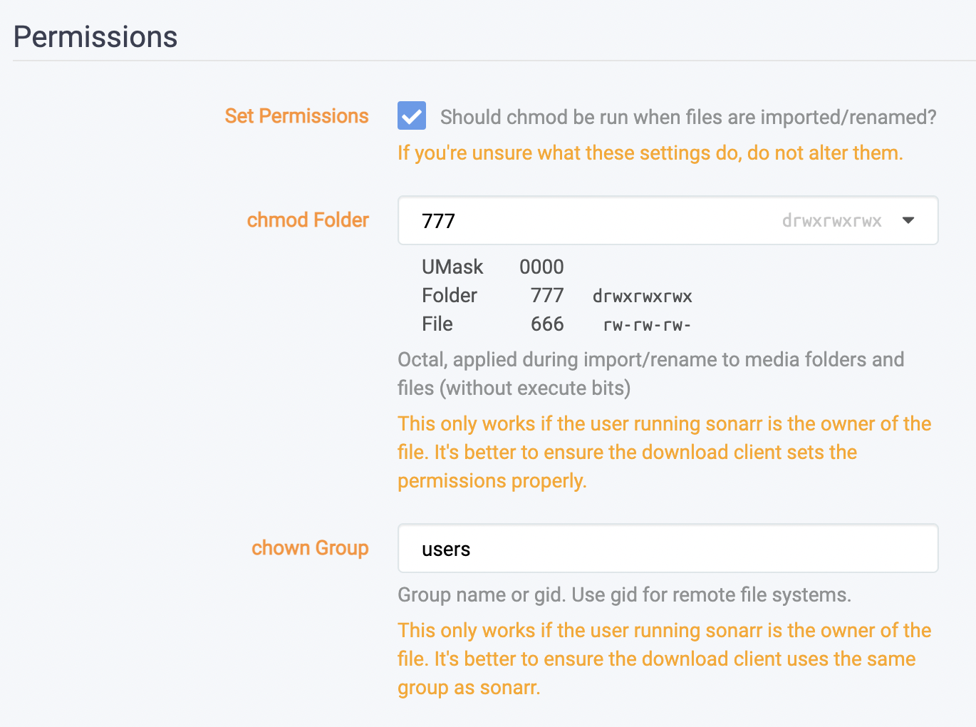

I enabled the Set Permissions in Sonarr.
478748588_ScreenShot2021-02-15at11_11_01AM.thumb.png.1d8865ae6010fe69fb8c33b65346cf60.png

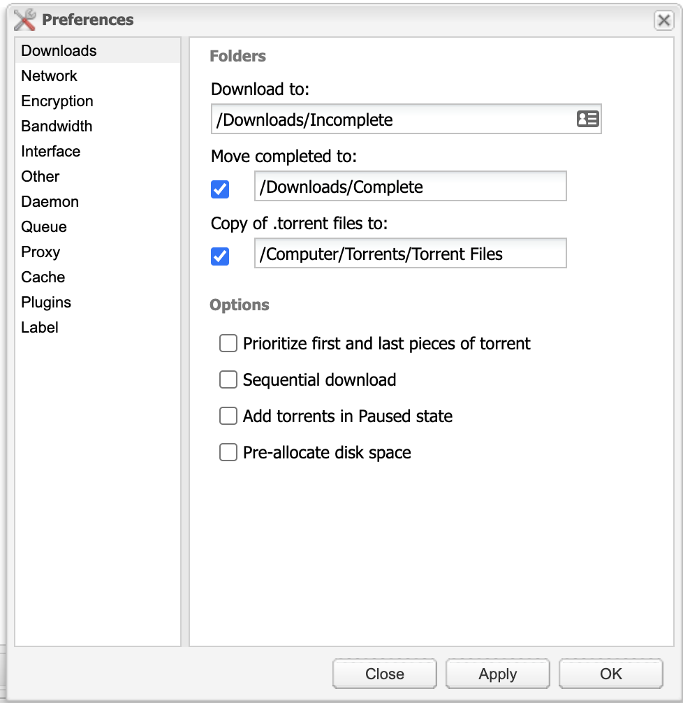

Alright let's try to change one thing at a time, test it, and see if it works.
  1. Deluge
    1. Downloads: make sure folder structure downloads/incomplete ----- and "move completed to" ----- downloads/complete
    2. Queue: Share Ratio 0; Time Ratio 0; Time 1
    3. Queue: Share Ratio Reached 0; pause torrent
  2. Restart and test if working

  4. Permissions in Sonarr: Uncheck the set permissions (it works for me without having to change permissions)

Tried it with those settings and they didn't import! Freaked me out a bit when I switched it back and at first they didn't either. But after a second time they did after I switched back. Then tried switching it from my cache drive to one of my array shares and that didn't do it either. Turned off the permissions settings also. The Downloads Folders paths are always working right. It's just when the torrent finishes in Deluge it won't delete the torrent there, nor delete the original file on the Cache Downloads share drive. Should also mention I did replace the Disk 1 HDD, that failed. Best part of Unraid not losing any data haha. Any other things/screenshots you want me to try/take? Really appreciate the help!
472440107_ScreenShot2021-02-16at5_22_37PM.thumb.png.0cba1df5c934f6fd823afcf256e8ea8d.png

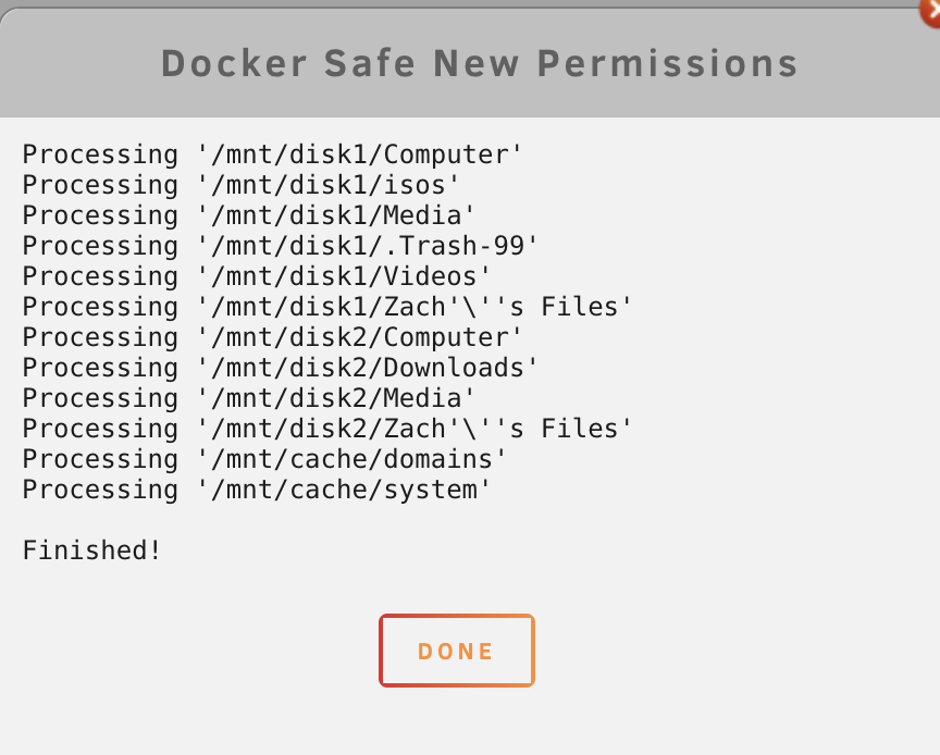

How about the Tools -> Docker Safe New Permissions option? Maybe this will fix some permission issue that might be stopping us from importing.

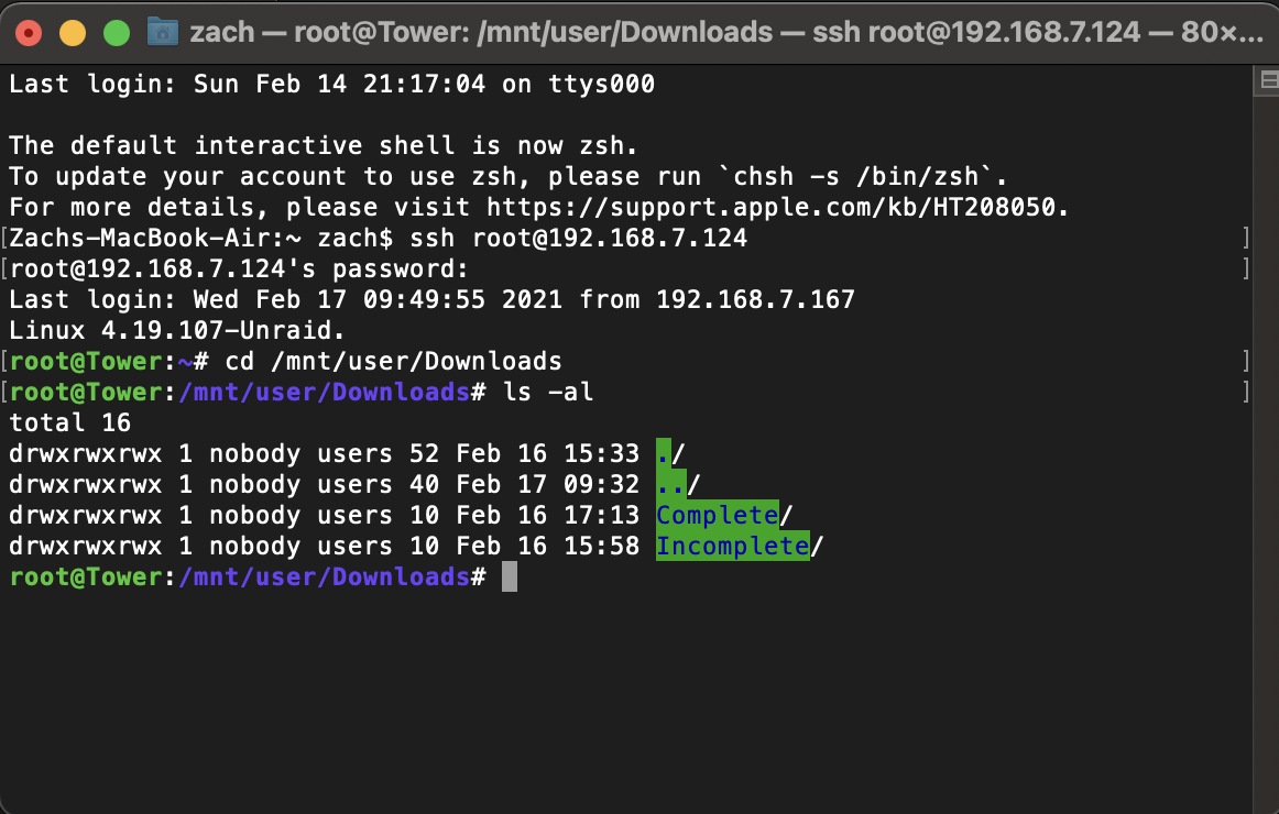

The other settings SHOULD work to import...but use what works for now. Who are the user:owners of the downloads folder? (Terminal, then cmd to parent folder, then "ls -al")

Okay, tried it again with your settings again and now it's importing! No idea why it wasn't before and now it is. Perhaps it was after running the Docker Safe New Permissions? But still not auto deleting in Deluge and the original file as well.
Tried the user/owners Terminal lookup, and able to do that I think. Here's a screenshot of that for you.
48641683_ScreenShot2021-02-17at5_28_40PM.thumb.png.58bce86af6a596f2c7e613bf03fd392d.png

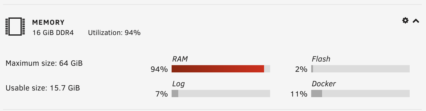

I now seem to have a memory issue I haven't had before. It's up to 94-95% and I shouldn't be up that high, no VM's running or anything like that. Can you guys take a look at my logs to see if you spot anything?
1507387142_ScreenShot2021-02-17at22_33_10PM.thumb.png.cefaf9604fd493005d4d2c138bd1e2a8.png

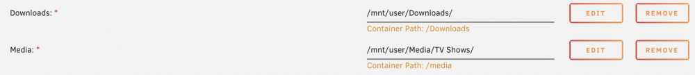

What are your volume mappings? Does the container path match between sonarr and deluge?

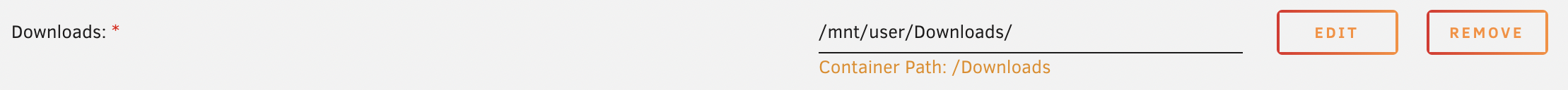

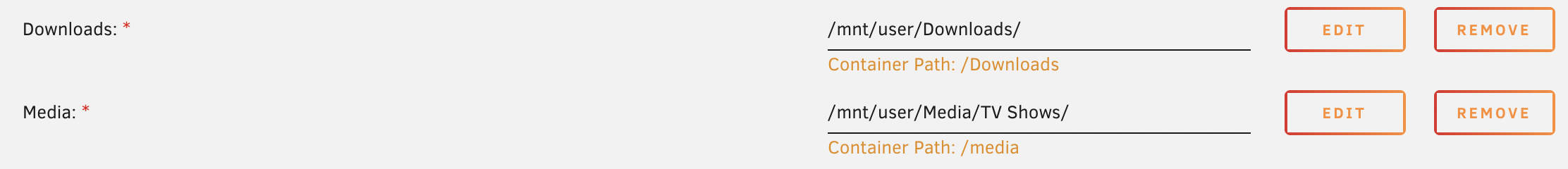

Are you using a socks5 proxy?
And is your sonarr spitting out any errors?
Yup, they match and seem to be working between sonarr and deluge. It's just when it finishes, it doesn't delete (in sonarr and the original downloaded file after it imports).
Deluge:
628654561_ScreenShot2021-02-18at11_06_42AM.thumb.png.b689ecb82fb5f876f36a9ac489d80b66.png
Sonarr:
274414814_ScreenShot2021-02-18at11_07_13AM.thumb.png.c0bb741dc0b72634bbb48418e635703c.png

Now my memory usage is up to 99%. Kinda freaking me out haha.
UPDATE: Memory spiked and then Overall Load completely spiked and everything crashed. Rebooted and Memory usage seems to be back at a normal state around 22%. No idea what caused that. Tested downloading a new torrent and same thing though.

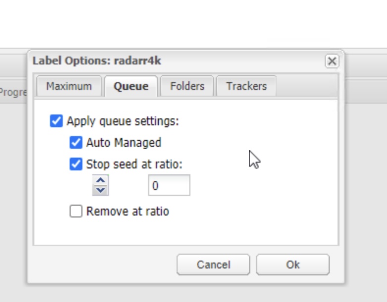

@yanksno1ive managed to fix my regular radarr. Waiting on a 4K download to confirm but basically I applied an override on the radarr label to stop seed ratio at 0 seed as a test (I’ll adjust this later) and now radarr is doing it’s thing properly :D
i haven’t applied ‘remove at ratio’
maybe try that?
I swear I’ve tried this same line of troubleshooting before but for whatever reason it’s behaving tonight

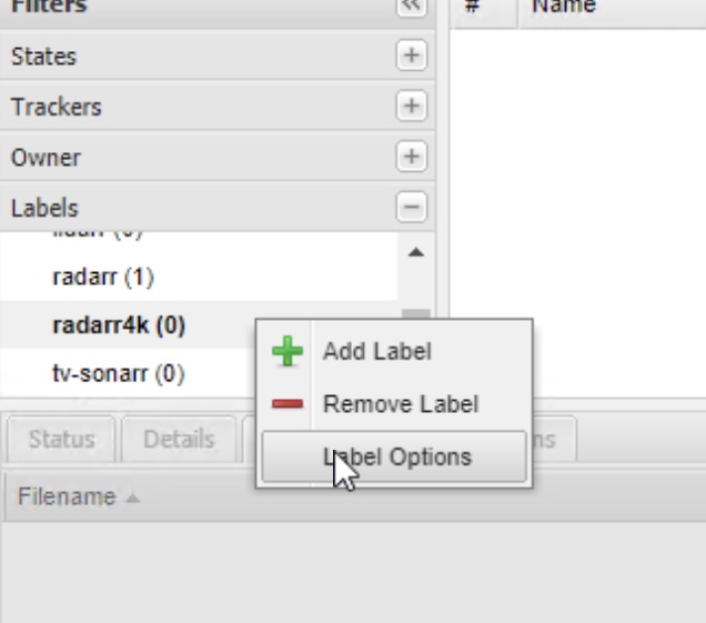

Right click the labels in deluge
@LintHart Thanks! I adjusted those and I'll see how it works. Testing a file now.
