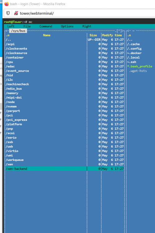

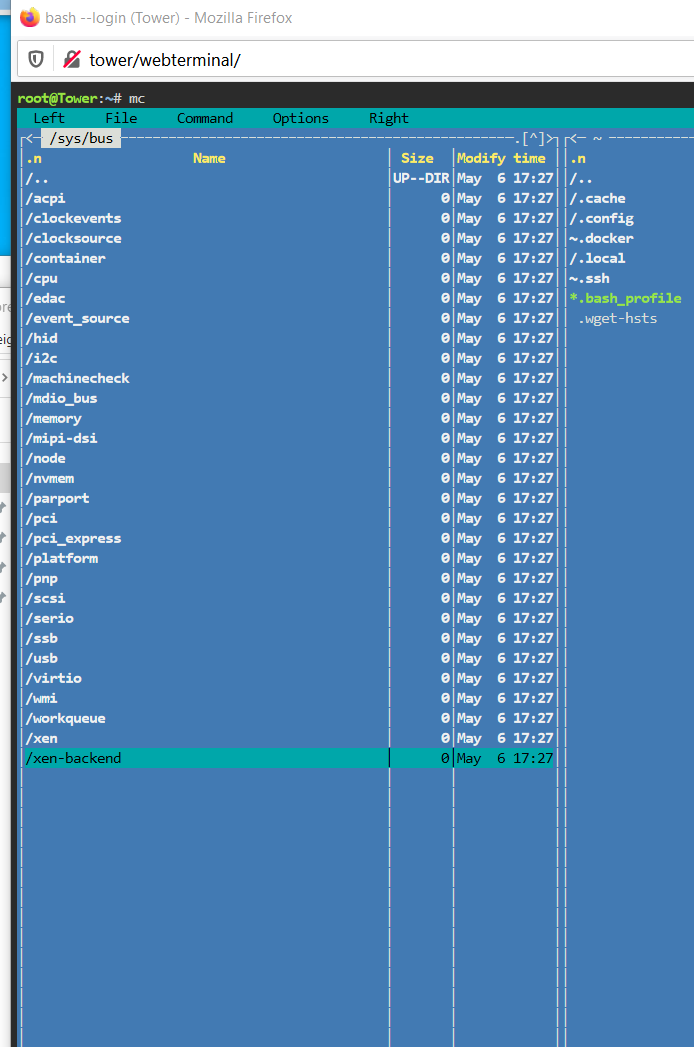

May 6, 20215 yr Not working ! I believe some Steps left out ... when i read here https://www.kernel.org/doc/html/v4.13/admin-guide/thunderbolt.html "If the security level reads as user or secure the connected device must be authorized by the user before PCIe tunnels are created (e.g the PCIe device appears). Each Thunderbolt device plugged in will appear in sysfs under /sys/bus/thunderbolt/devices. The device directory carries information that can be used to identify the particular device, including its name and UUID." But that folder "thunderbolt" does not exsist ... Edited May 6, 20215 yr by Dtrain update
May 6, 20215 yr 30 minutes ago, Dtrain said: I believe some Steps left out ... when i read here Some of that might be out of date. Anyway I noticed in researching this the other day there are both CONFIG_THUNDERBOLT and CONFIG_USB4 kernel options. The USB4 settings are not enabled in the kernel for 6.9 but are for 6.10.
