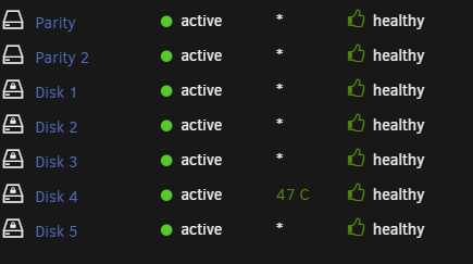

Only disk 4 is showing a temp, * is showing for the rest. They are all WD shucked drives.

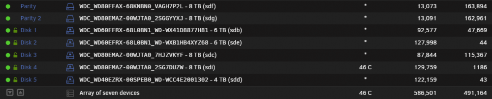

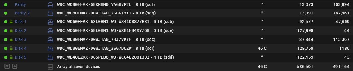

Yes all drives are spun up. I've been watching these temps for 2 days as it's hot here. Has never showed anything except disk 4 and cache since updating. Which may or may not be the issue, but I do watch temps regulary

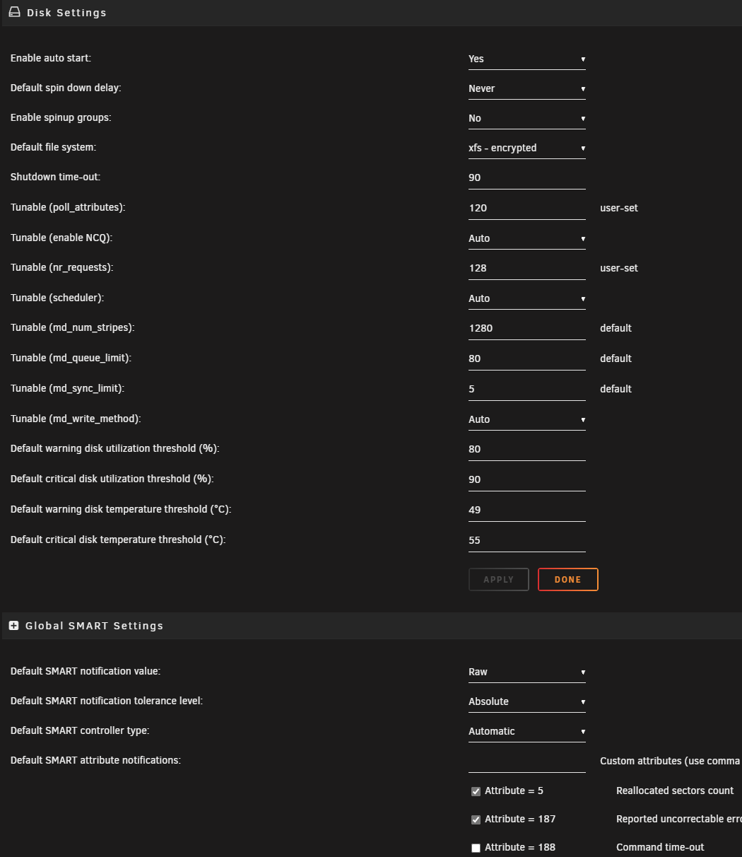

I've tried smartctl '-A /dev/sdX' and i get a message back telling me smart status is enabled.. however when i go into the hdd settings it tells me this:
SMART support:Available - device has SMART capability.
SMART support:Disabled
Very confused!
