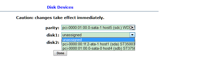

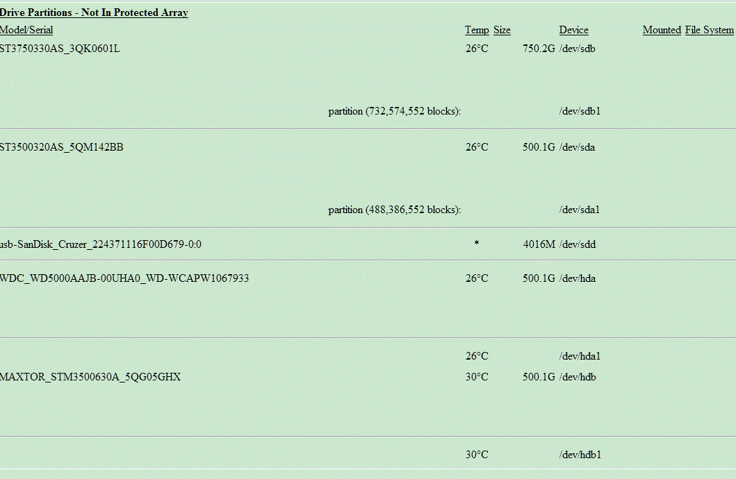

upgrade from 5.0-beta2. as following screen captures shown unraid can not detect IDE disks, no issue at 5.0-beta2.
Device list from webGui shown no IDE disks however list from unmenu shown all disks.
MB : MSI P43 Neo3-F
Syslog shown system had successfully detcted both IDE disks, so looks like a presentation issue in webgui?

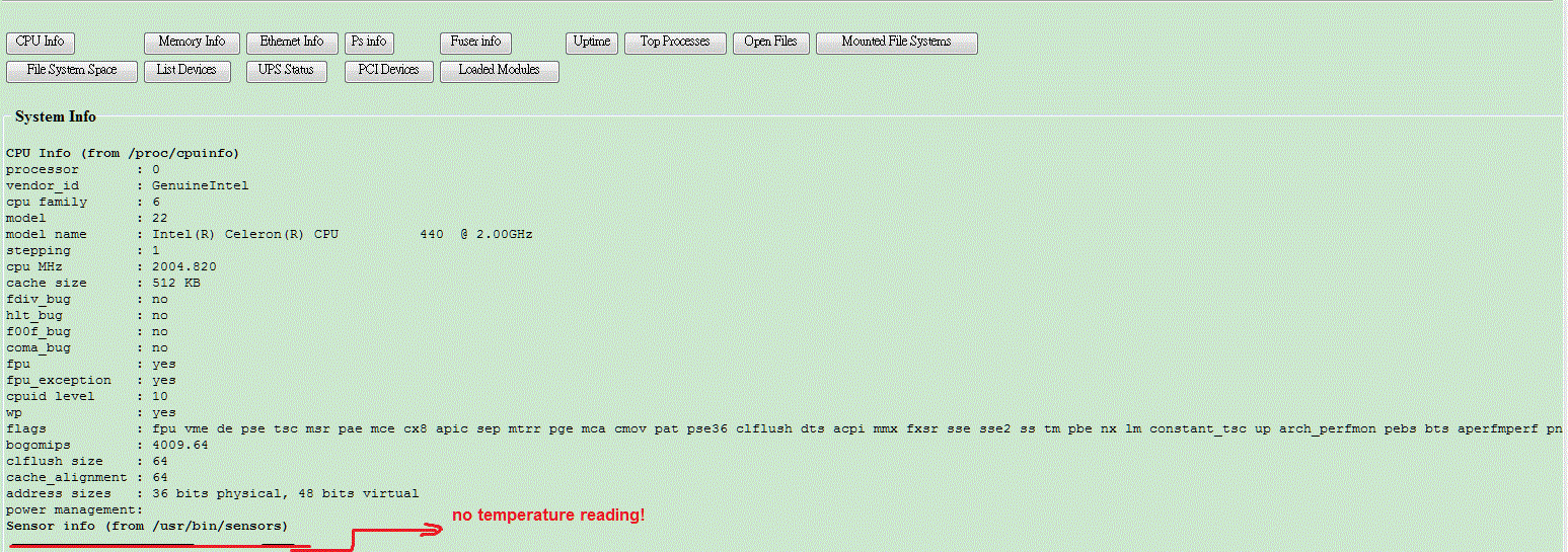

CPU temperature reading is missing from "CPU info" at unmenu at 5.0-beta3, no problem at 5.0-beta2.
Syslog shown following messages, looks like sensor driver has been removed at 5.0beta3?
Feb 1 00:09:55 TestTower unmenu[1187]: Try sensors-detect to find out which these are.
Feb 1 00:10:02 TestTower unmenu[1187]: No sensors found!
Feb 1 00:10:02 TestTower unmenu[1187]: Make sure you loaded all the kernel drivers you need.
The advanced power management related features have been made modular.
Could you try logging in to a linux command prompt to issue a "sensors-detect", run through the prompts, then issuing "sensors" to see what your output is? Then if it tells you to modprobe any drivers, such as f71882fg, lm75, to give it go, then reissue a "sensors" command?
If you get any sort of reading out of that, then try reloading the webpage to see if you get any info from that as well.
MB : MSI P43 Neo3-F

I second this motion...
My Test Server with UnRaid 5.0_beta2 works great.
I upgraded it to 5.0_beta3 and no longer does it show the IDE drives.
All SATA are there but no IDE.  :P
Downgraded to 5.0_beta2 and all is perfect again. Good thing is only a test server...  ;D
You guys with undetected IDE drives: please exeucte this command from telnet session & post output:
ls /dev/disk/by-path
I will try to get 5.0b3 installed on my test server tonight and run the above command.  The test server has 2 IDE and 1 SATA drive in it.

Did you read the part in the Release Notes where it says:
"If any of your hard drives appear missing or wrong, you can either go to Settings/Disk Devices and re-assign all your hard drives, or you can go to Utils/New Slots and execute that utility to change the device assignments for you. Depending on your hardware configuration this step may not be necessary."
