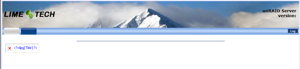

Clear the cache on your browser and also hold the shift button when you press the refresh button in the web browser.
Firefox
What are you typing in the address bar of the browser?  If coming from 4.7, can not use:
//tower/main.htm
(the main.htm part will not work with 5.0). You need to type:
//tower
or
//tower/Main
