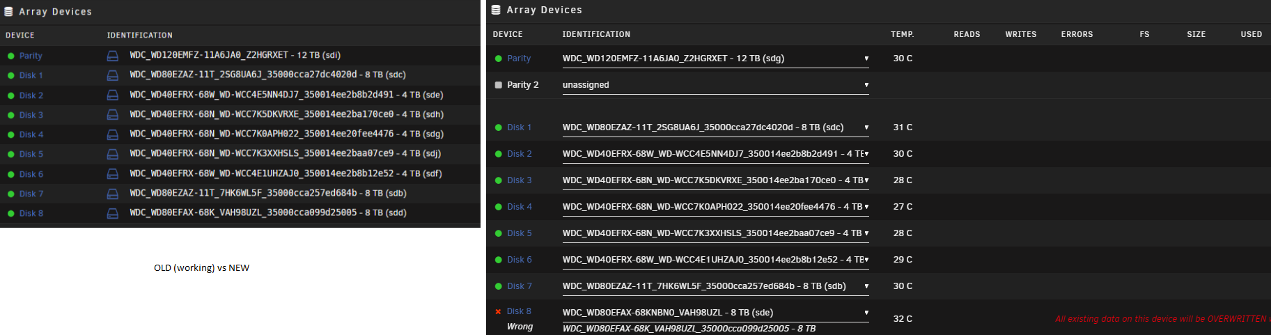

I decided to upgrade my intel G5400 to new 10700k and Gigabyte Vision D setup and move compltely to VMs. I have been running my server for over a year now without any issues. After the upgrade I had to use 6.9.0-rc1 in order to recognize new NIC on my card (it was invisible for 6.8.3 version). I have a problem with one disk (normal WD Red 8TB, not shucked).
I have 9 drives in my array:
1 via SATA (Parity)
8 via Dell H310 (as I remember I flashed it before making my setup, don't remember which version probably newest)
All working well, but one Disk - normal WD Red 8TB, not shucked. Unfortunately for whatever reason now it's missing when connected via DELL H310 (and I tested all the cables) and it's only visible via SATA, but then it changed the name as you can see on attached screen.
What would be the best solution to this? Also I am super curious why the disk decided to not work with te H310 anymore...?

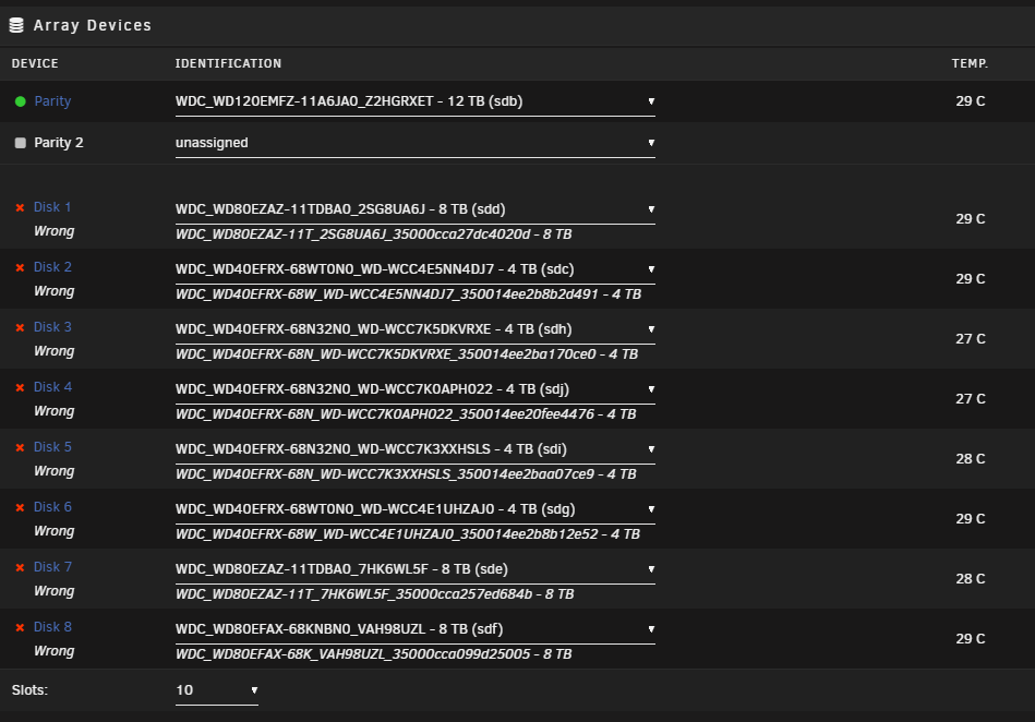

It’s funny that all of my shucked drives are fine, this one is the only 8tb „regular” WD Red. I even tried it with the the tape mod, but no change. 5x 4tb are WD Reds no problems, same with shucked 8’s.
What’s the easiest way to check firmware on my Dell H310?
Posting the diags.
It's in RAID mode:
02:00.0 RAID bus controller [0104]: Broadcom / LSI MegaRAID SAS 2008 [Falcon] [1000:0073] (rev 03)
    Subsystem: Dell PERC H310 [1028:1f78]
    Kernel driver in use: megaraid_sas
    Kernel modules: megaraid_sas

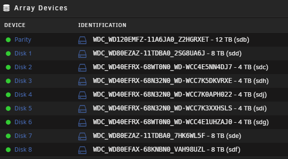

What a ride, all drives are visible now :) I hope this topic will help someone in the future as well
edit 4:
I went to Tools -> New Config -> Selected Preserve "all" and following "Trust the Parity Drive" selected "Parity is already valid" and finally I see all greens :) thank you for your help @JorgeB
