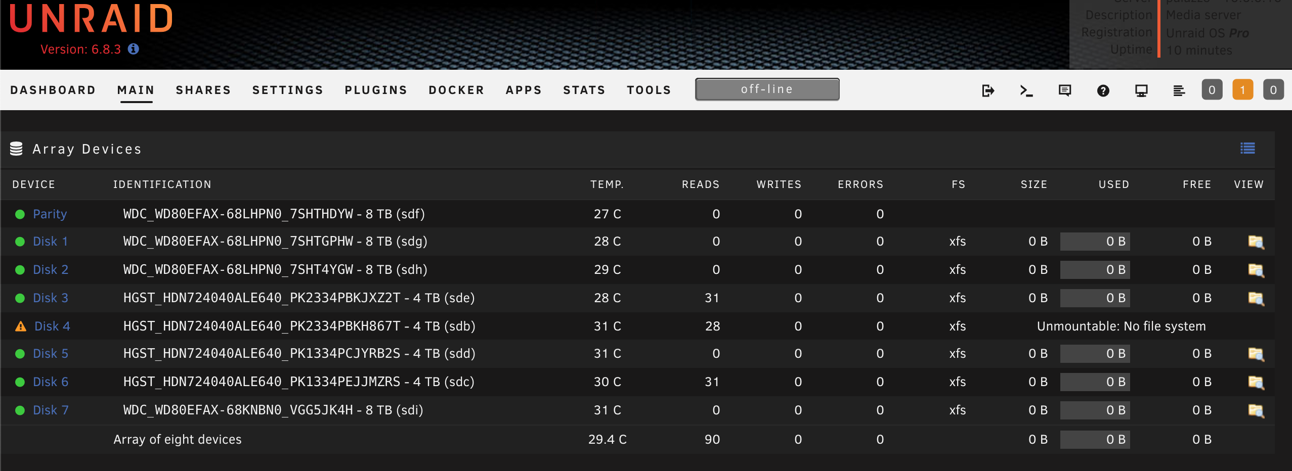

SMART attributes for Disk4 look OK but the emulated disk is unmountable. Bad connections are much more common than bad disks. Are any of your disks showing SMART warnings on the Dashboard page?
There are some problems with disk4 in syslog besides the unmountable filesystem though. Not sure if it's only a connection problem or actual disk problem. Check all connections, SATA and power, both ends, including any splitters. Then reboot and post new diagnostics.

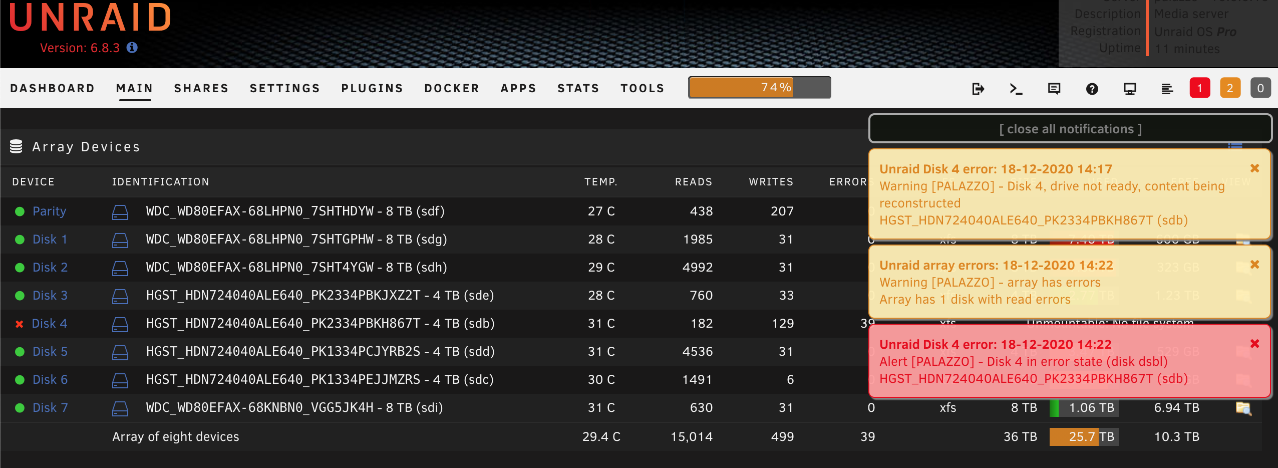

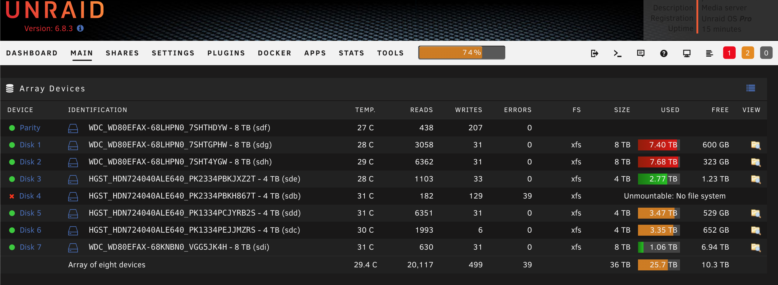

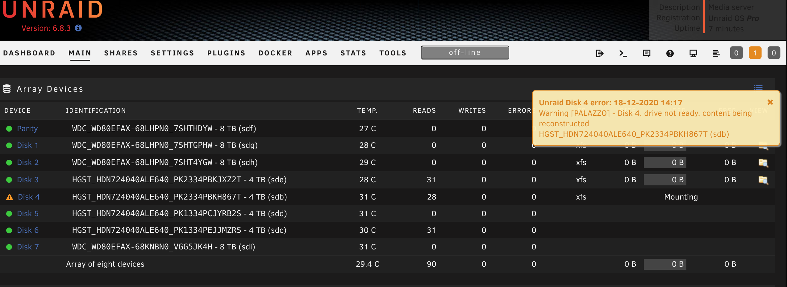

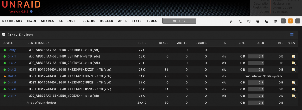

I think drive 4 is really going bad. It hung on mounting when starting the array (screenshot) I'm attaching logs after reseating the drives and cables, before and after starting the array. It does appear that I can view items directly browsing disk3 again though. This gives me hope that I can just swap out disk 4 tomorrow when my new drive arrives.

Just had this notification pop up:
Unraid Disk 3 SMART health [7]: 18-12-2020 15:11
Warning [PALAZZO] - seek error rate (failing now) is 4849854
HGST_HDN724040ALE640_PK2334PBKJXZ2T (sde)
You went way beyond my advice. Instead of rebuilding my next advice was going to be to repair the filesystem of the emulated disk before attempting rebuild. Rebuilding an unmountable filesystem will just get an unmountable filesystem even if the disk is good and the rebuild succeeds.

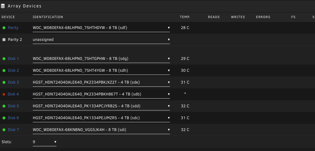

What are you looking at to see the failing disk? I'm pretty sure both 3 and 4 are failing. I couldn't even mount disk 4 on it's own went I took it out of the array.

It says Disk3 is failing, which is coming from SMART for Disk3. Disk4 was disabled and unmoutable but not failing.
Disk4 needs to be rebuilt. But reliably rebuilding every bit of a disabled or missing disk requires reliably reading every bit of all other disks. If you had dual parity you could rebuild both but as it is the failing Disk3 is going to compromise the rebuild of Disk4.
We might be able to get it to rebuild the failing Disk3 instead of Disk4 and then try to fix the filesytem on Disk4. Do you have a replacement for Disk3?

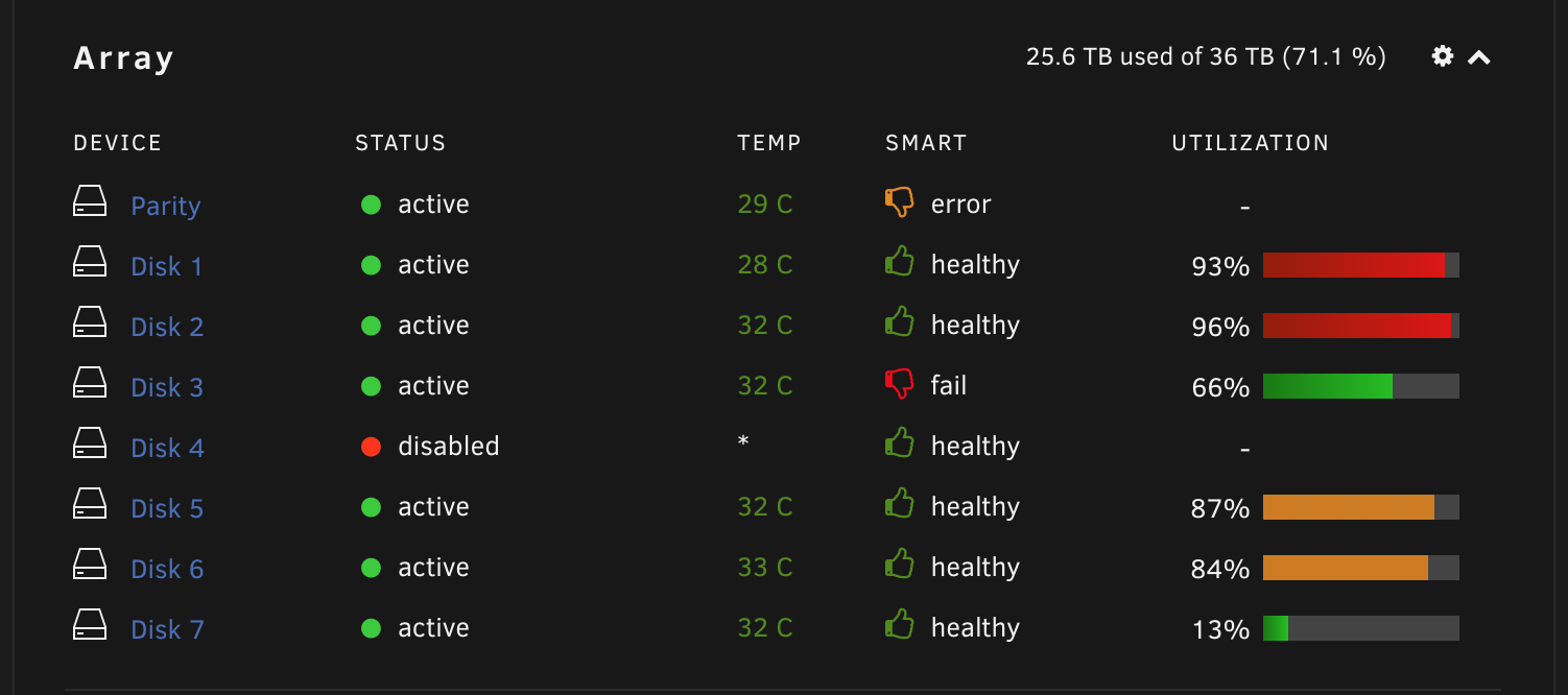

Should I stop the array or anything? Shut down the entire server? On the main page it does say that disk 4 has 39 errors, but on the dashboard it shows as healthy? I'm guessing the new 8TB won't be here until ~1 or 2pm PST tomorrow.

Looks like that thumbs down on parity is just a single CRC. If you mouseover it will let you acknowledge that.

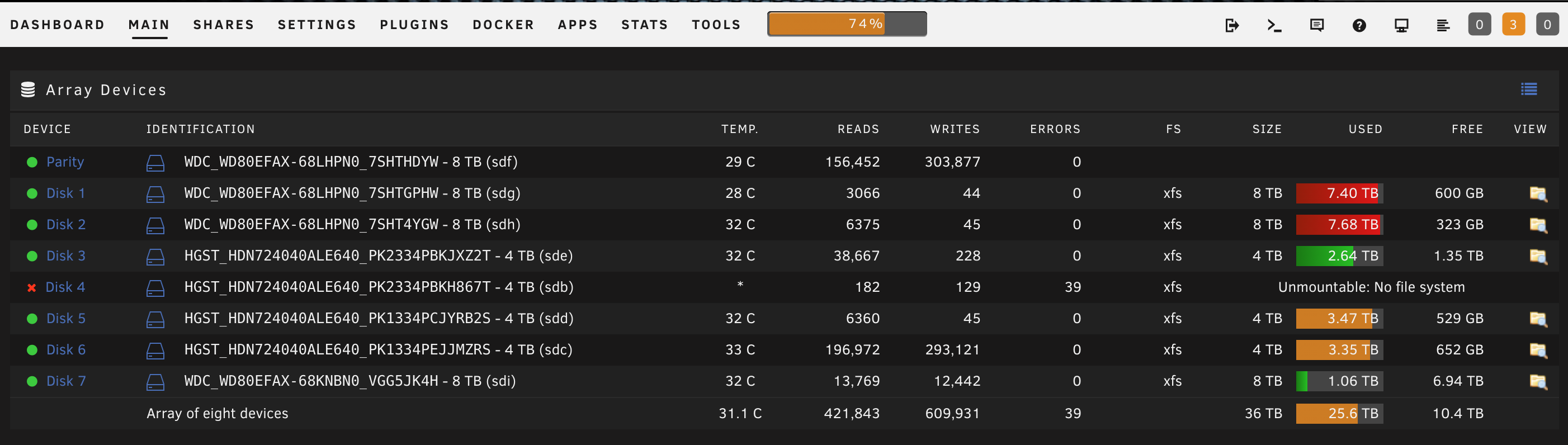

Thanks for the check disk filesystem link. It appears the check filesystem on disk 4 just finished. I am attaching a zip with the diagnostics after the check filesystem run. I'm also including disk 6 smart download since it was showing bad on the dashboard now. There is also a few screen shots.
- when I started the run
- a status hour and a half later
- dashboard showing drive 6 says it has issues now
- the finish out put of disk 4
Not sure if I need to re-run check without the `-n` option now or not.

Same FAILING NOW as disk3 so I guess not critical and at this point with multiple disks in this state I think you have to go forward with repairing the emulated disk and see what happens. So

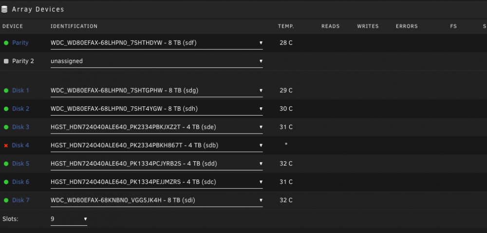

If you start the array in normal mode is emulated disk4 mountable now?
Should I try starting it before running any. Smart checks and/or preclear. It's still showing a red x next to the disk.
