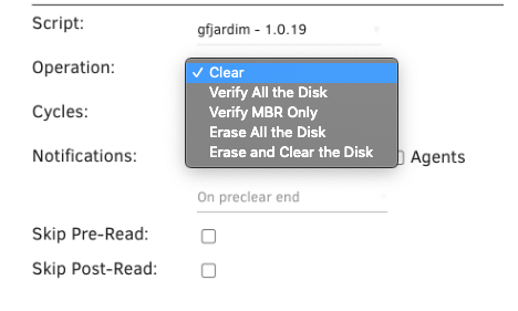

Well there was some stuff I had come to grips with loosing. I'm going to try and copy it off to another server. Should I run one of the preclear functions on the new disk in the meantime? If so which preclear option?
Post a screenshot of those preclear options
Clear should be good enough, one cycle, don't skip anything. You can do that while copying things from the server. How much do you plan to copy?

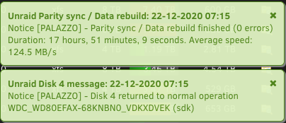

@trurl thanks for all your help. I'm back up and running, and it has rebuilt disk 4.
