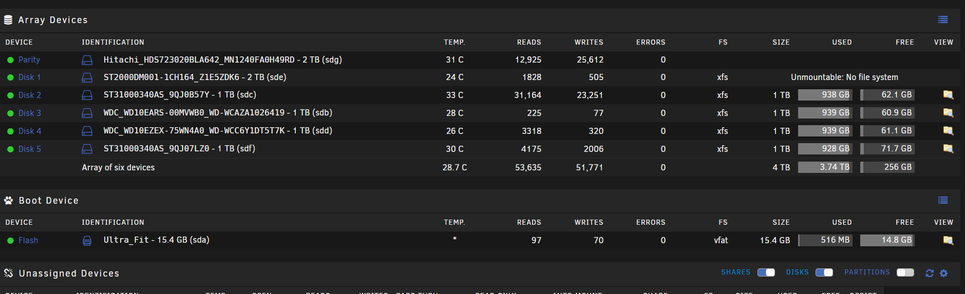

Getting conflicting information from those diagnostics. Post a screenshot of Main - Array Devices
Here it is
