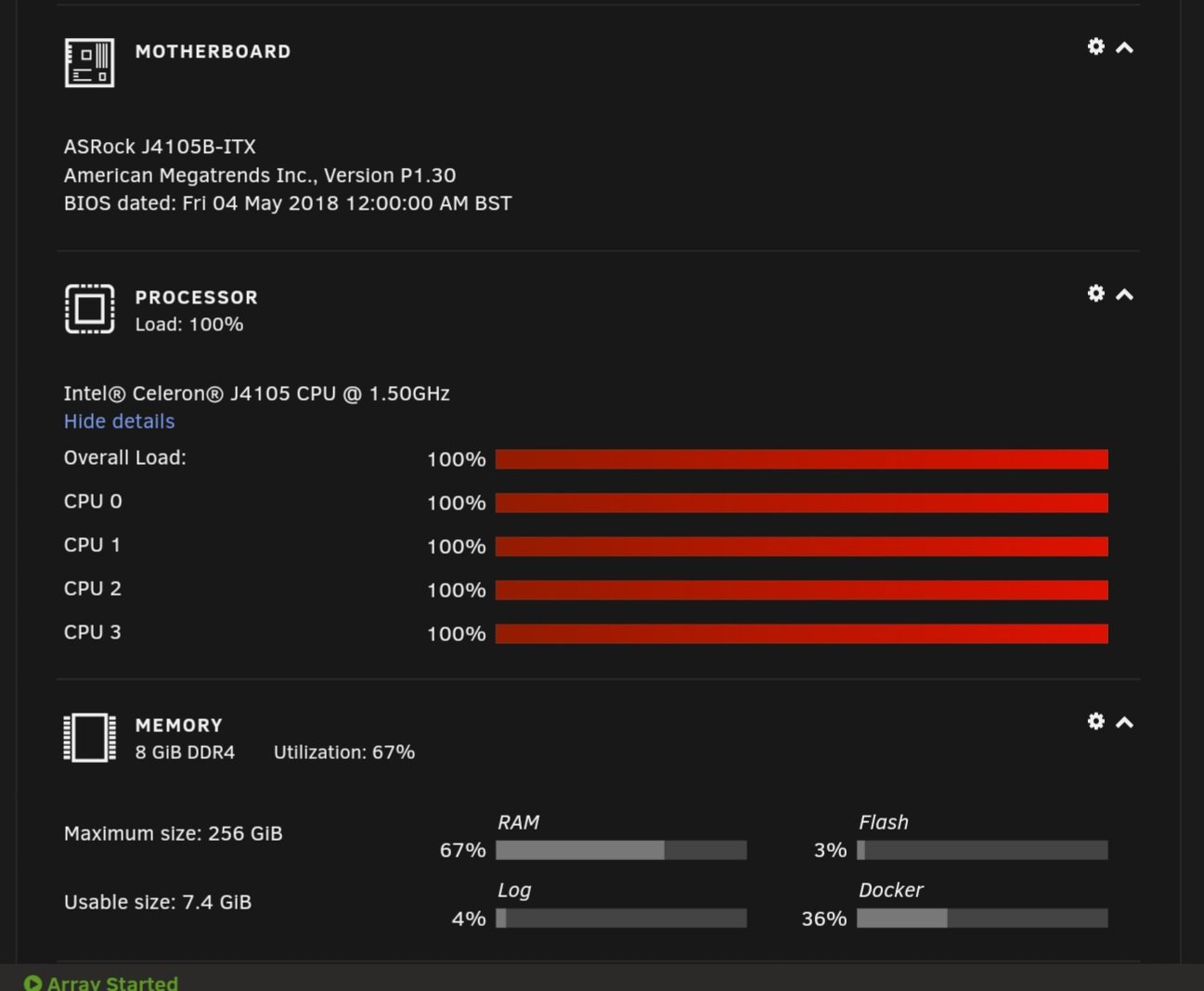

I always ensure that I am not using any other service(s) (Nextcloud, Sabnzbd etc) at the same time as Emby (I've tried PLEX too) to give it the best fighting chance, however my CPU usage normally maxes out and if it drops, it only goes down to around 70%. I always play directly when at home and do not transcode. I must admit, I've just tried playing the 4K content on my tablet (Galaxy Tab S7+) in order to get a few screenshots for you of the issues, however things do play better (not perfect) on the tablet than my the TV's.

I just assumed it was my system that was the bottleneck as the simplest of tasks will use 50-80% of my total RAM, which is only 8gb.
Here's a quick screenshot of when just Sabnzbd is running.

...I don't use or know sabnzbd, but I think this is just for downloading files and not touching the files content?
If your CPU gets maxed out on this, do you have enabled disk encryption, by any chance?
Or maybe you did enable to many download threads (if that is at all possible).
As you do seem to have a cache drive as well, this should not impose such a load on your system, I think.
Regarding emby (which I don't use either), the transcodinbg could take place without you knowing, depending on Source (codec for audio and video) and destination capabilities along with the video/audio bandwidth needed. Even if only the audio codec (I believe Samsung TVs don't support direct HD Audio, but AAC or AC3) is wrong, transcodinbg will take place and yes, this can max out your little CPU easily.
Can you see someting in the logs from emby or sabnzbd, what actually is happening that might give a hint?

I do have system wide disk encryption, could this be causing the spike in memory use? If that was the cause of all my issues, I could live without it as I encrypt my backups to Google nightly, however if it is only a small performance hit, I'd prefer to keep encryption and move forward with an overall system upgrade.
Looking around on the CPU front, I keep coming across the i5-10500 as potentially the way to go, it seems to have the best price/performance ratio.
...although the J4105 comes with hardware acceleration for encryption, my best guess is, that this is what results in a high CPU load....RAM usage will also be a bit higher. I do have an older AMD opteron 3350HE (4 cores) driving an encrypted array of 11 disks +1 cache....and without anything else RAM usage is approx 20% from a total of 16GB.
CPU load however goes up to 80/90% sometimes, during writing to the array.
