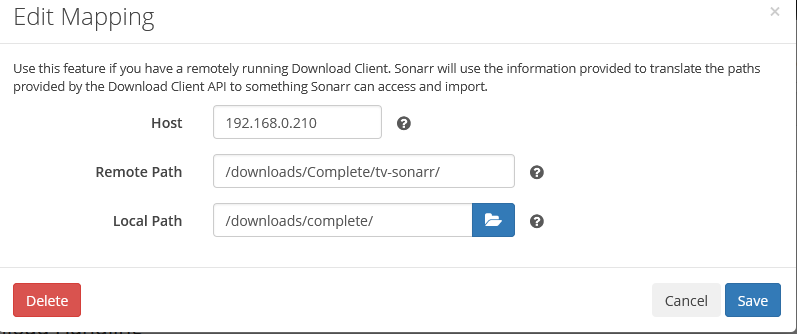

do you have remote path mappings set up under sonarr > download clients > remote path mappings? if so, screenshot those too

they are on the same host and below/attached is the screen shots
for the remote path mappings, this was working as well before whatever happened.

I'd remove the remote path mapping, as with properly configured paths it's not required anyways, and in the context of the container it doesn't really make sense what you have in there.
let me remove the mappings and see if that helps
just tried unfortunately the same error.

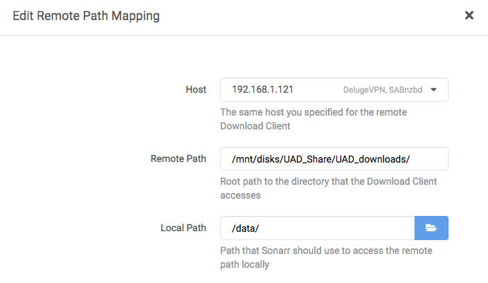

sorry for the delay @thefozzybear, somehow i missed the notification response on here.
anyway, i think i see the problem, based on comparisons of my mappings. i'm using deluge, but the principal should be the same. here's my screenshots for you to compare with:
think your remote path should be /mnt/disks/Sonarr/, and your local path should just be /downloads/ instead of /downloads/complete/. try that and see if it makes any difference.
