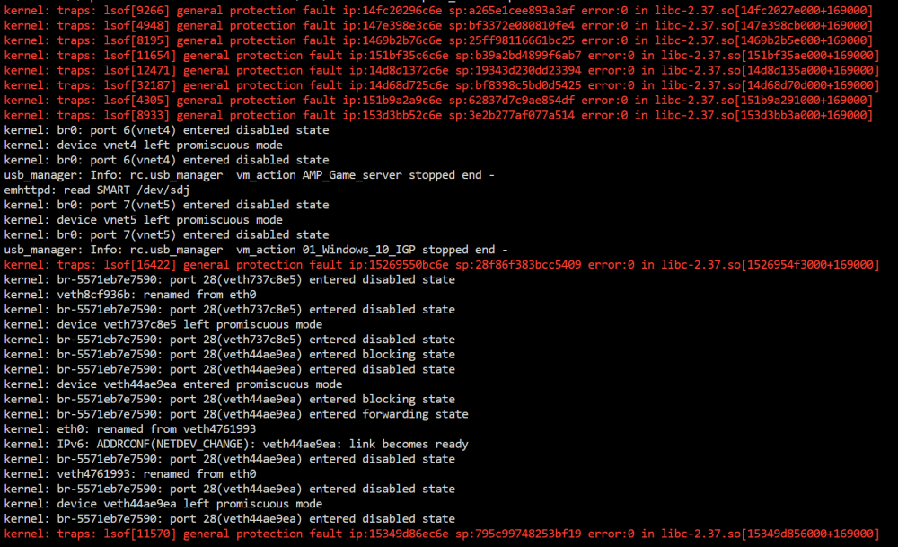

I started getting a some of these messages on one of my servers. They have appeared both on unraid 6.9.2 and 6.10.0-rc4 I noticed identical timestamps for traps lsof faults to messages related to an SMB share I have mounted through unassigned devices plugin. I switched to NFS and saw the same thing, identical timestamps like these:
Apr  9 09:12:26 server1 kernel: nfs: server server2 not responding, still trying
Apr  9 09:13:57 server1 kernel: nfs: server server2 not responding, still trying
Apr  9 09:25:16 server1 kernel: nfs: server server2 OK
Apr  9 09:25:16 server1 kernel: traps: lsof[28800] general protection fault ip:14789875068e sp:d00e994a5e9bf867 error:0 in libc-2.33.so[147898737000+15e000]
The errors are not isolated to these remote share events however. I see them over night every few minutes sometimes. They go away when I disable all dockers that write data to the array. The dockers that I have set up writing data to the array are set up to skip cache and write directly to disk by making use of the user0 path. Dockers writing to cache directly appear not to cause these errors.

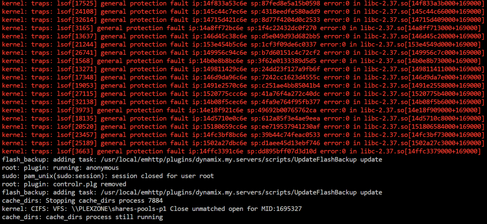

I am see these exact errors with kernel reboot / Server freezes during times or errors
Sep 15 12:52:16 Tower kernel: traps: lsof[30936] general protection fault ip:14ab683016ae sp:5ed3085355a3d6ef error:0 in libc-2.33.so[14ab682e8000+15e000]
Sep 15 12:55:11 Tower kernel: traps: lsof[4503] general protection fault ip:153bf4e216ae sp:3ee1d5d776d367d error:0 in libc-2.33.so[153bf4e08000+15e000]
Sep 15 12:59:00 Tower kernel: traps: lsof[12204] general protection fault ip:1467326906ae sp:47cfa8c536c38691 error:0 in libc-2.33.so[146732677000+15e000]
Sep 15 12:59:26 Tower kernel: traps: lsof[21465] general protection fault ip:14bc088f96ae sp:9e86563466307937 error:0 in libc-2.33.so[14bc088e0000+15e000]
Sep 15 13:11:23 Tower kernel: traps: lsof[30874] general protection fault ip:152e845a36ae sp:b687d2ef31080728 error:0 in libc-2.33.so[152e8458a000+15e000]
Sep 15 13:12:27 Tower kernel: traps: lsof[2231] general protection fault ip:14eeeadf16ae sp:8dc80c4b63e3019 error:0 in libc-2.33.so[14eeeadd8000+15e000]
Sep 15 13:14:17 Tower kernel: traps: lsof[5300] general protection fault ip:14ca620ea6ae sp:7d2a238c850265d7 error:0 in libc-2.33.so[14ca620d1000+15e000]
I do not have unplugged usb keyboard and mouse, Krusader is not running or installed, read/write (slave) has been changed to simply Read/Write, memtest reported no errors.
The last thing to do is reimage or replace usb flash drive.
Edited by jasonbigler

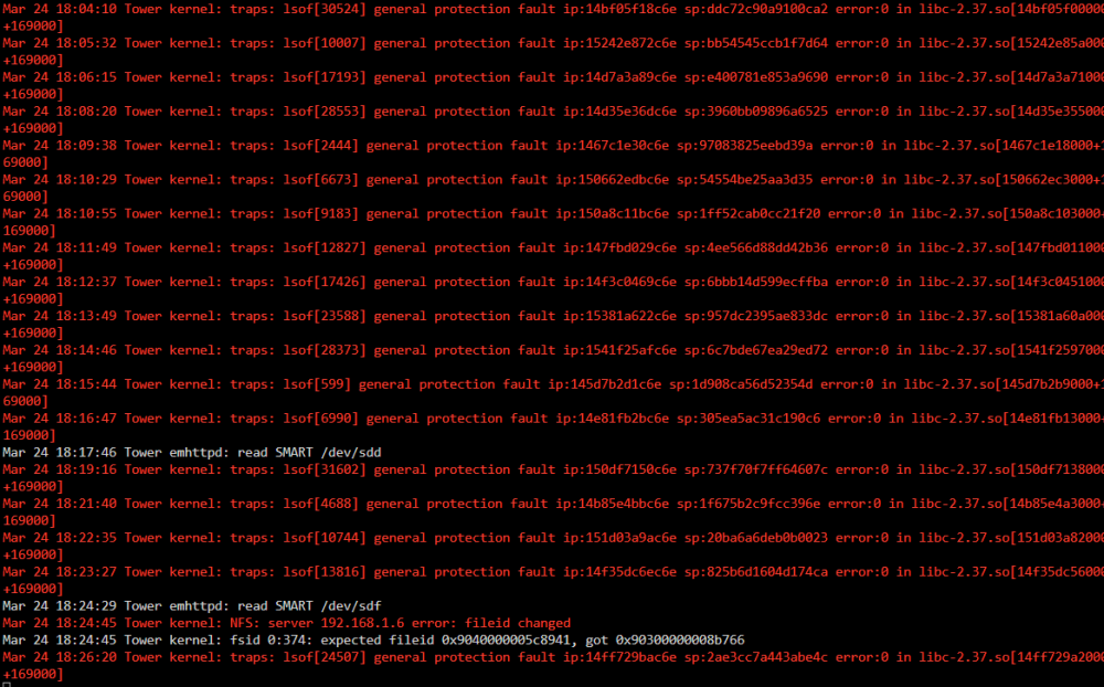

Hello,
same issue on 2 of 3 unraid servers. I guess it is because trying to access (nfs) the 3rd server.
one of the 2 server is new and has not much on it.
but it has some difficulties with nfs shares...

Hello,
I am seeing this problem as well when I am on 6.11.5, on one of my two unraids. If I go back to 6.10.3 the problem disappears and everything works fine. I have had this problem on all 6.11.X and I always had to roll back to 6.10.3.
When the problem arises, around 4 AM, all docker and VMs are missing on the dashboard. The server kind of works, but not completely. I can't even download Diagnostics, it's just stuck on collecting logs.
I also see the following in the logs which match the time pretty good,
Dec  1 03:46:31 unraid01 kernel: traps: lsof[20478] general protection fault ip:14710dae84ee sp:c1321d13210db561 error:0 in libc-2.36.so[14710dad0000+16b000]
Dec  1 03:59:20 unraid01 kernel: traps: lsof[12947] general protection fault ip:151c2d9224ee sp:75ab240d9cab0f3c error:0 in libc-2.36.so[151c2d90a000+16b000]
Dec  1 04:16:12 unraid01 kernel: traps: lsof[24904] general protection fault ip:14af0616b4ee sp:965b46bd90838f67 error:0 in libc-2.36.so[14af06153000+16b000]
Dec  1 04:31:44 unraid01 kernel: traps: lsof[26965] general protection fault ip:14b5a75c44ee sp:4050197e3a84082e error:0 in libc-2.36.so[14b5a75ac000+16b000]
Dec  1 04:32:13 unraid01 kernel: traps: lsof[29523] general protection fault ip:153d668114ee sp:2b9458963a4a01db error:0 in libc-2.36.so[153d667f9000+16b000]
I get similar issues since a few versions back, server starts to max the CPU then stuff like this gets spammed in log.
After a some time, it calms down and everything is back to normal. Seems to happens alteast once every day.
kernel: traps: lsof[14343] general protection fault ip:1504971c54ee sp:1fa708f06a2f1a3 error:0 in libc-2.36.so[1504971ad000+16b000]
kernel: traps: lsof[26932] general protection fault ip:14df495714ee sp:cd45860846c31f97 error:0 in libc-2.36.so[14df49559000+16b000]
kernel: traps: lsof[32411] general protection fault ip:1527d92984ee sp:6526393b4abc9f47 error:0 in libc-2.36.so[1527d9280000+16b000]
Ive upgraded most hardware in server, thinkig it was ram issue. But problem remains with new hardware aswell.
anyone have any light to shed on this??
I got the message too, but only when backing up from Unraid to an SMB share
Feb  2 09:07:58 Zeus CA Backup/Restore: Using command: cd '/mnt/user/appdata/' && /usr/bin/tar  -caf '/mnt/remotes/RASPBERRYPI_unraid/Appdata/[email protected]/CA_backup_PlexMediaServer.tar.gz' 'PlexMediaServer' >> /var/lib/docker/unraid/ca.backup2.datastore/appdata_backup.log 2>&1 & echo $! > /tmp/ca.backup2/tempFiles/backupInProgress && wait $!
Feb  2 09:07:58 Zeus CA Backup/Restore: Backing Up: PlexMediaServer
Feb  2 09:10:01 Zeus kernel: traps: lsof[27292] general protection fault ip:1545e1c8c4ee sp:2671bcf0f5eda277 error:0 in libc-2.36.so[1545e1c74000+16b000]
Feb  2 09:13:00 Zeus kernel: traps: lsof[3838] general protection fault ip:14e7050494ee sp:650e1fbe4da98bf6 error:0 in libc-2.36.so[14e705031000+16b000]
Feb  2 09:13:28 Zeus kernel: traps: lsof[5592] general protection fault ip:149963e844ee sp:7baf20f44494db8e error:0 in libc-2.36.so[149963e6c000+16b000]

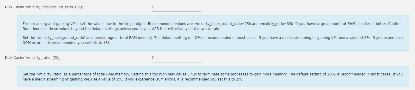

**EDIT:
So i recently upgraded to 6.11 - and i found a ton of things that were not updated on my server.  I have an Nvidia graphics card, and the driver was not updated to account for 6.11, and I also have a Dynamix Local Master plugin for SMB shares, and that was way out of date... it started up much smoother after i updated all the plugins and fixed the graphics card.  Something to check just in case.
Edited by wdenny

Not sure if that will help anyone, but it appears to have helped me.  Will continue to monitor the logs and see if the message reappears.
I'm getting these as well periodically. Best I can tell is that they seem to happen when my backup share (over Tailscale) starts seeing some issues (possibly packet loss somewhere?) and "du" or "df" (can't remember) starts failing to that remote share. But once it happens there is no recovery - even when the remote Tailscale node recovers, which I can see from my laptop on my same home LAN. The main issue I start seeing is that my docker apps won't restart and throw an exception. The only way to recover Unraid is a reboot.
Yeah, I know the Tailscale container states that it is intended to provide remote access to Unraid only (not any gateway functionality).
