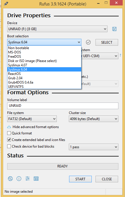

Just now, death.hilarious said:
What should I choose for the boot selection?
Non bootable should work, we are trying to get the best possible blank slate for the USB creator tool to work on.
Thanks for the help @jonathanm!
I used RUFUS to do a proper full write format as well as a bad sector check on the USB. I then re-made the USB drive using the USB creator and copied over the config backup... and ran into the exact same problem as before. I was so sure it was going to work.
