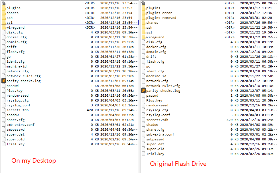

1. Can you read anything of the old flash drive?   Everything that is specific to your system is stored in the 'config' folder on the flash drive.
I've managed to copy some of the config files from the flash drive. Most of the text files seem to be intact. But I can't say the same for other binary files. Is Plus.key the license file? It seems to be encrypted.

The plus.key file will be your licence file.    It is encrypted so not human readable.    The super.dat file is also not human readable.     The rest of the configuration files will be text files.

config/super.dat has your disk assignments and it looks like your backup of that file is OK so you shouldn't have to reassign anything. Just in case, edit config/disk.cfg and change it so it doesn't autostart and you will be able to check the assignments before starting.
