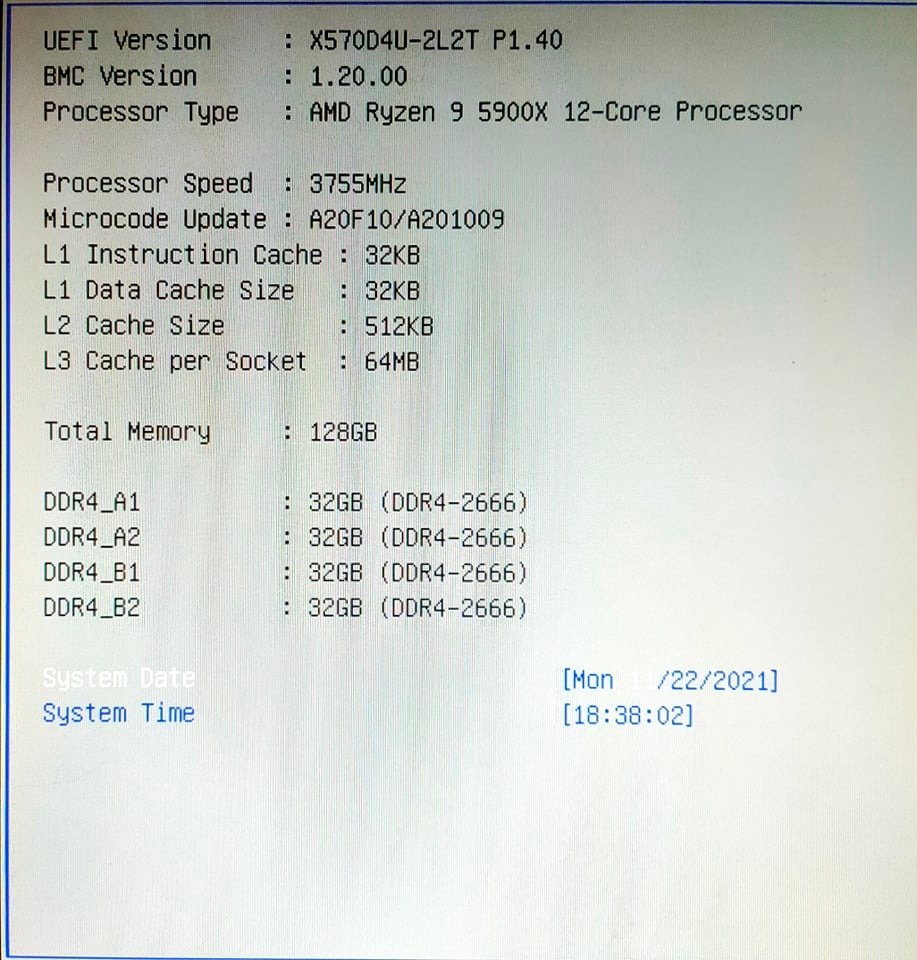

For the moment, everything is great since I purchased the KSM32ED8/32ME
Is there anything else I need to do in the BIOS to make my setup perform better?
Thanks

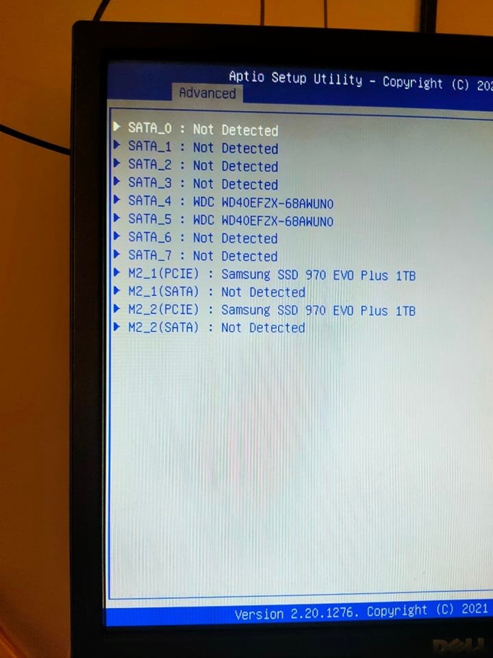

Great to see that your system is running well now. Are you only using 2 disks and 2 NVMEs?
Please check the memory speed in the Bios, it should be set to 1600MT (which is 3200mhz). You can also try to set the CPU to Eco if you want to play around with lower power consumption - performance should still be more than great with the 5900X.

Ok Thanks for the suggestion. I will do the same.
Yes, indeed, I have 2 NVME Disks 1 + 1 TB and 2 (4TB) SATA Disk

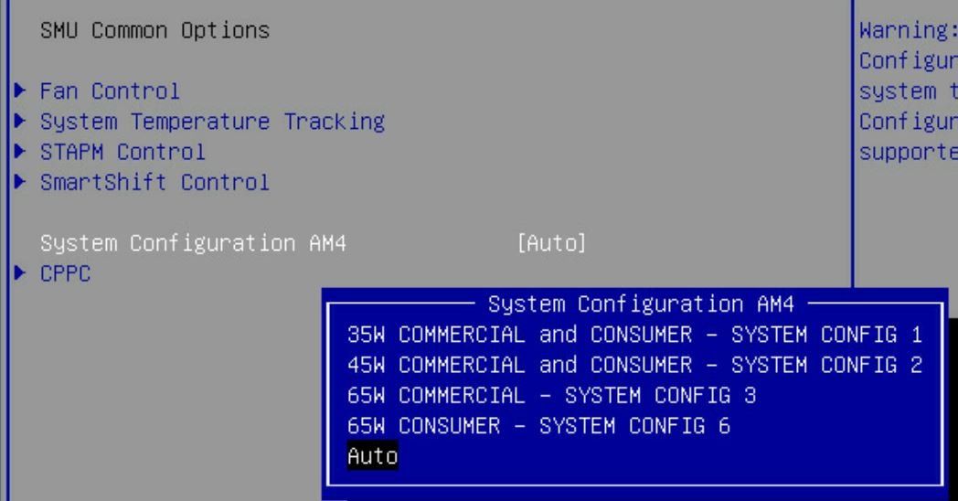

I have system reset/"unsafe shutdown"(it is reset) once per 24h of running server. I just updated BIOS/BMC and disabled global C-STATE. Any other recommendations?
Ram is ECC, I checked it anyway, no problems.
BTW where is exactly ECO mode in BIOS 1.20? I saw only general option: Power plan - Performance mode or Energy efficient mode. Is it the same?
Edited by CobraPL

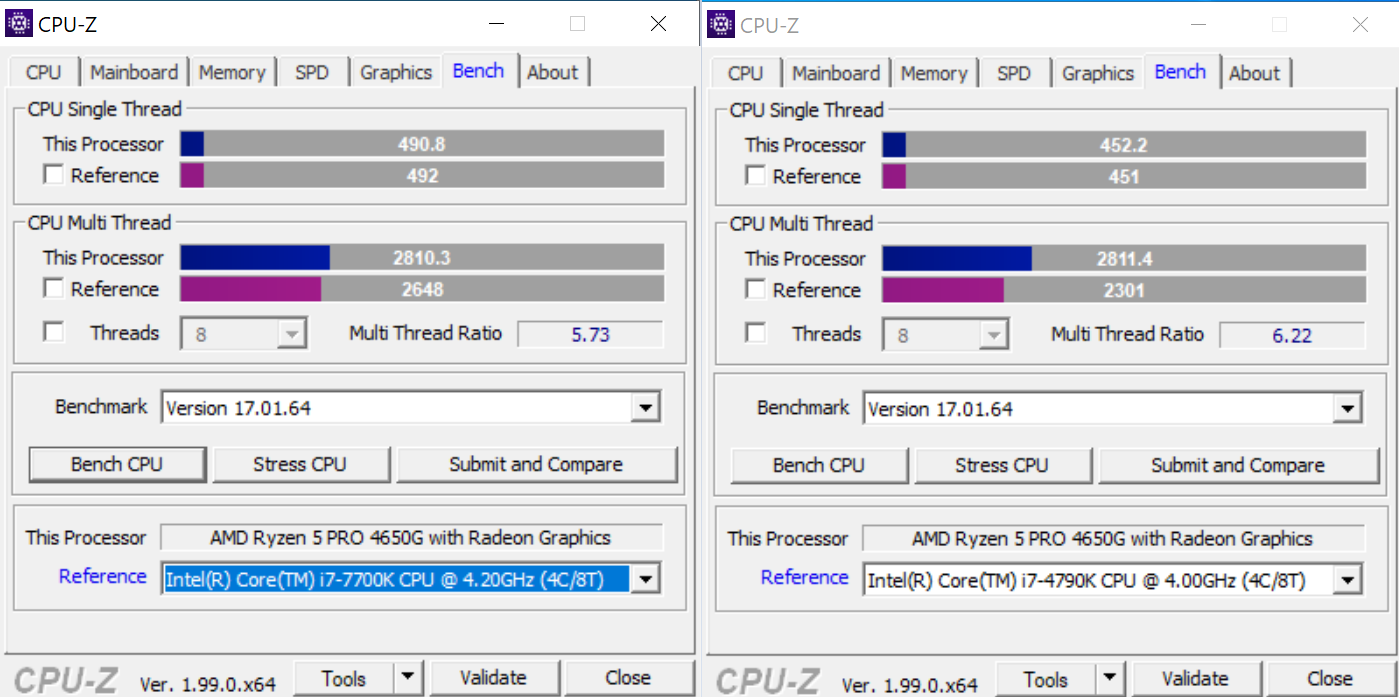

Here is same processor two times (two cores for unRAID, 4 cores for VM).
"power plan" "performance" to the right, energy efficient to the left. 8.5% single core performance.
I'll check wattage after I obtain the proper device to check it.
I cannot recall where that feature was hidden, since I sold that board already. My current config is in the EPYC watercooled thread.
Regarding your system resets - Did yo reset the bios and did a memtest to see if there are any configuration issues or a faulty memory module?
updated BIOS/BMC, disabled global C-STATE, disabled aggressive SATA, disabled CPPC. I think it stopped resetting, need more testing. RAM is multi-byte ECC, it passed all tests
I am using the onboard M.2 for two 512GB SSDs in a Raid0 cache, which I am using as a fast backup target. During the night the Mover moves the backups to the Disks.
Do you remember how you set up the M.2 RAID0? I've set it up in the bios - but unraid keeps seeing both NVMEs.
