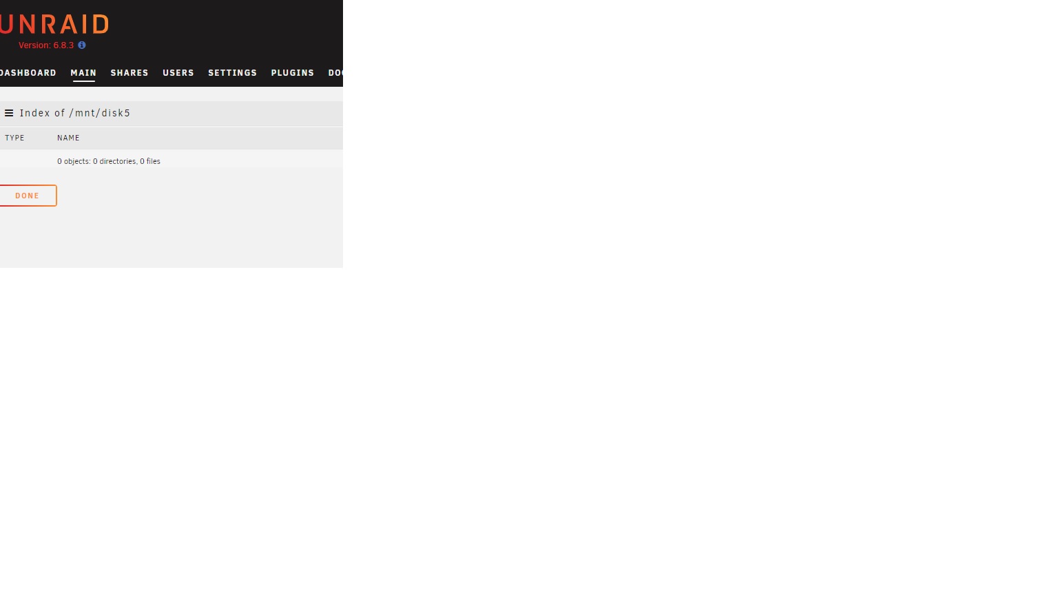

i am still getting this error there is not files on them so i am not sure how to remove them safely if i shut down and then take out and restart says missing disk please help i am sorry i might sound thick but i am find some things hard thanks, the picture below shows one of the disk empty the other is the same thanks again
To remove a disk from the array you have to New Config without it and rebuild parity.

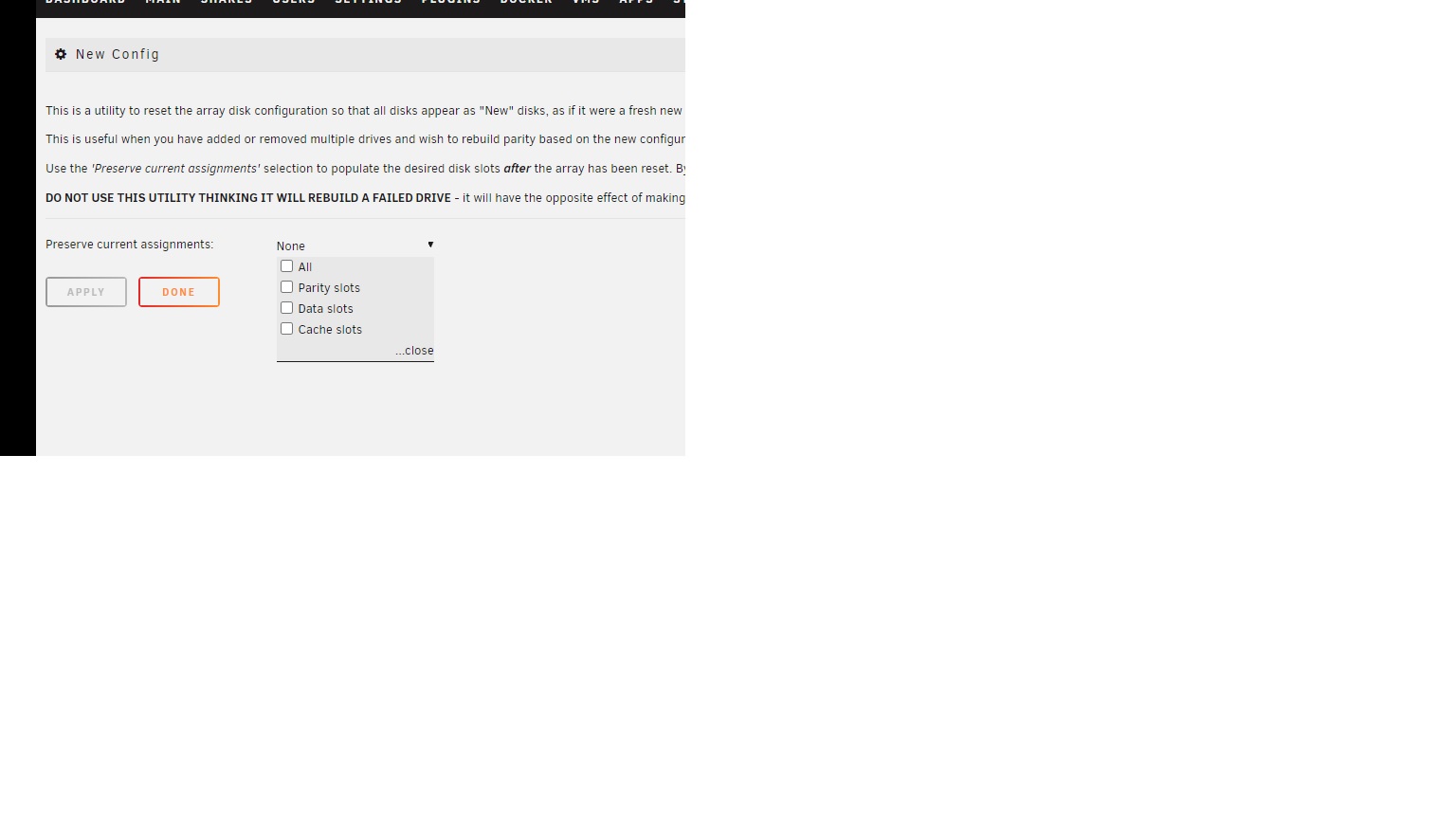

is this the page i need if so which option do i need so i do not lose any data on any of the other drives thanks
Preserve All, Apply, unassign the disk you don't want, start the array to begin parity rebuild.

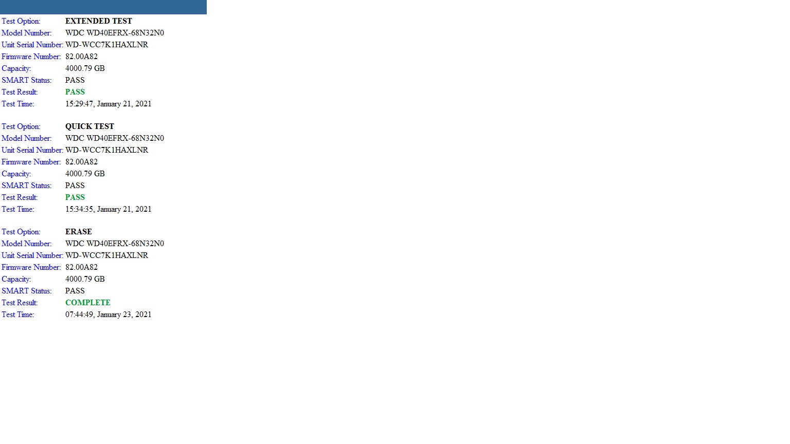

Ok so i have a update on the 2 Hard drives been having the problems with i spoke to WD and they gave me a program to test which has been running for last 3 days on both drives results below so i do not know what is wrong SATA card new cables new HDDs fine ??????

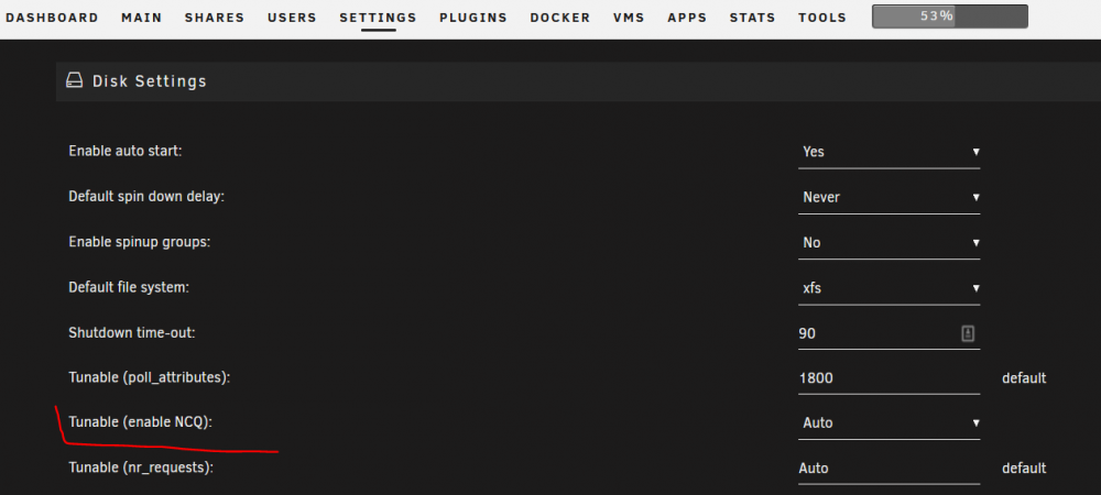

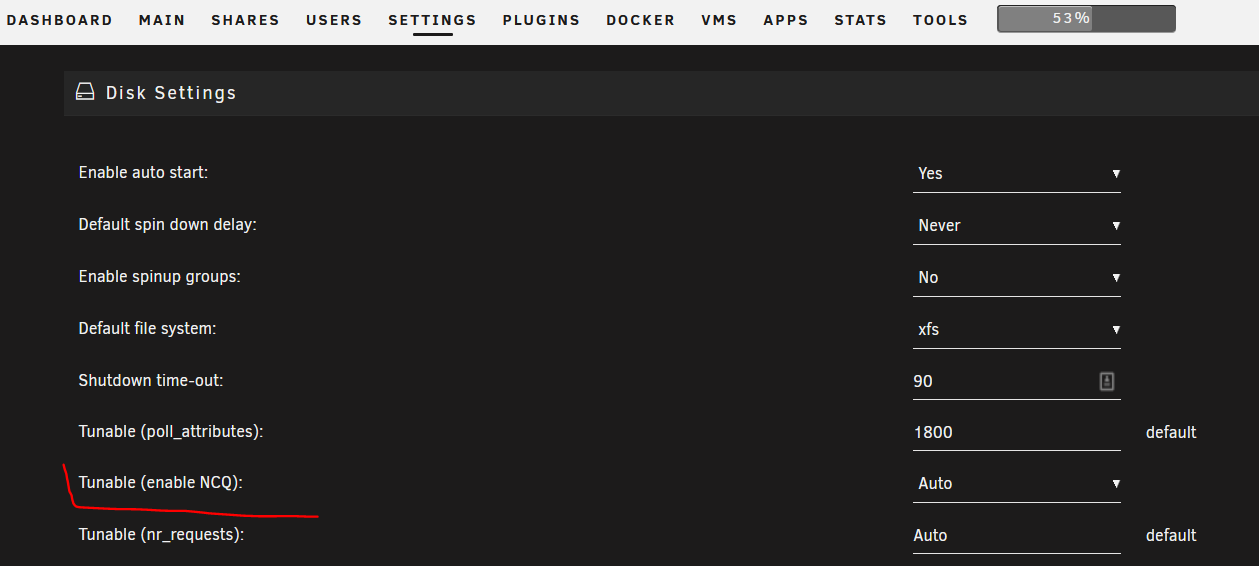

Hi sorry could you tell what NCQ is and where do i find thanks
I would think that it is an option available in Settings / Disk settings.
