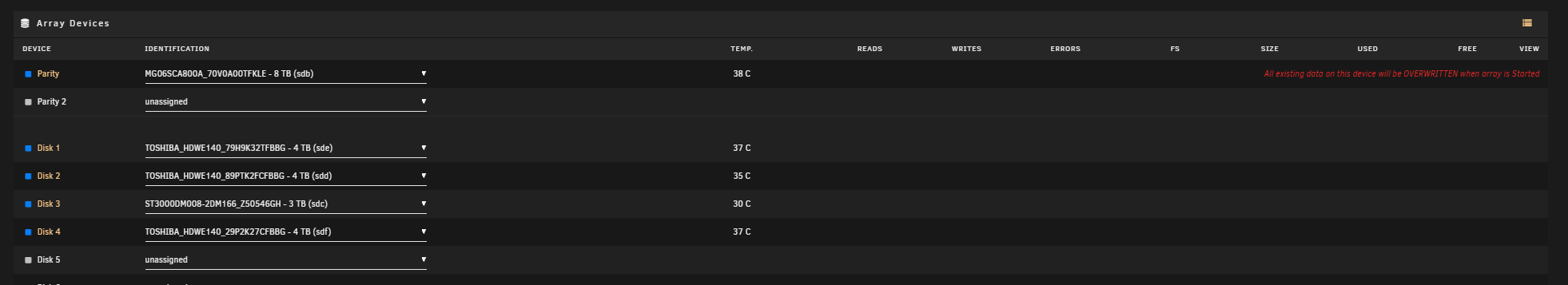

I restored the USB drive from the backup but my disk configuration disappeared.
I know where the disks belong thanks to the Disk Location plugin, but I don't know how to run the array so that I don't lose data.

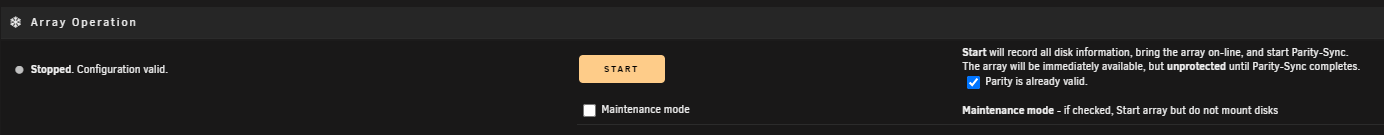

I'm scared by the sentence at the parity disk - All existing data on this device will be OVERWRITTEN when array is Started
Should I check that the parity is valid and start the field?
If parity was valid and you check that box it won't be overwritten, good to run a parity check anyway.
So why does it say that the data will be overwritten?
So can I run the field like this? The parity was previously valid.

So I ran the array without losing data.
Your disks assignments are in config/super.dat on the flash drive. If this was a flash backup made by CA Backup plugin, that plugin renames super.dat so you won't accidentally start up with the wrong disk assignments in case you had changed them since the backup was made.
Some people have reused a parity disk for a data disk then later used an old backup that thought their old parity was still parity and so it starting overwriting the data with parity.
You have to rename that file back to super.dat so Unraid will use it.

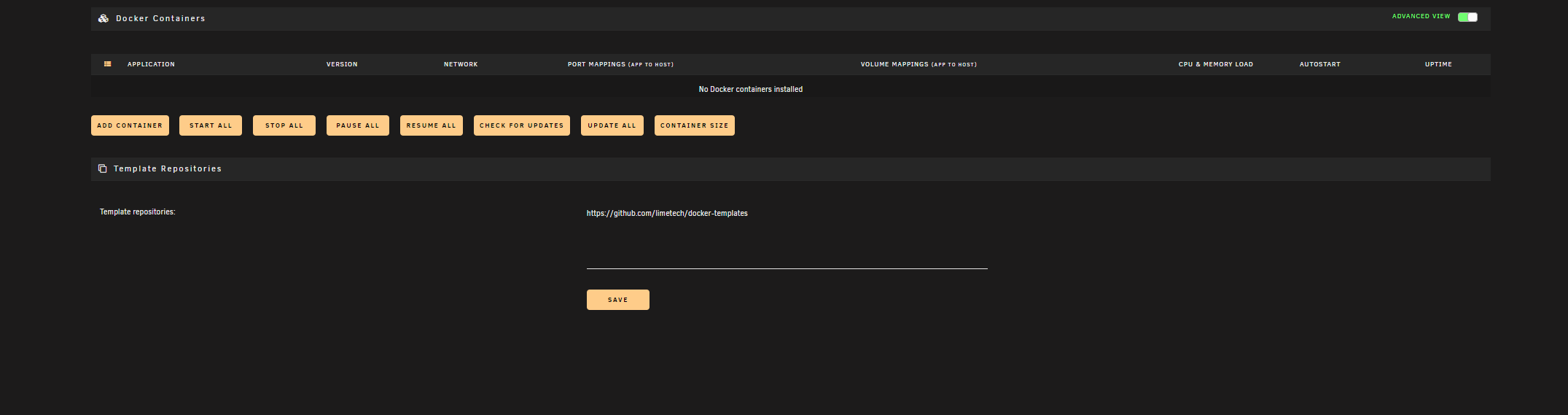

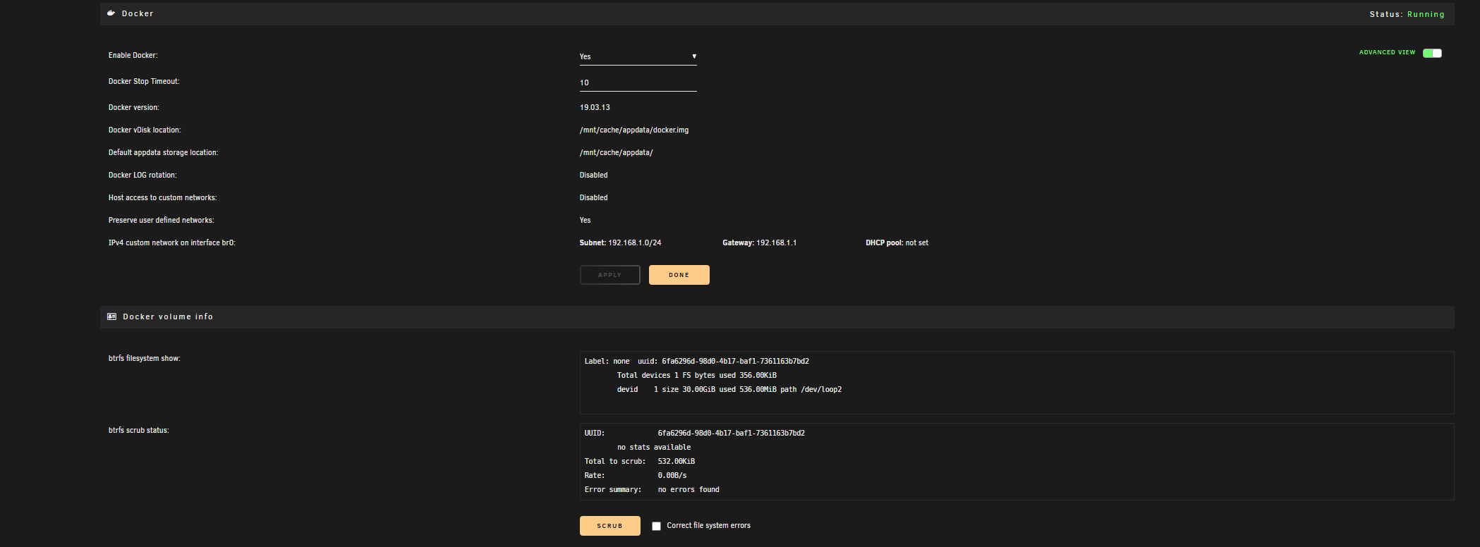

But now I have a problem with dockers.
It all came about because I wanted to create a cache pool, but I couldn't do it according to some instructions and all my applications disappeared.
Then I just tried to restore the flash and I had that problem with the array. But it is already solved and the array is fine.
I don't see dockable panels on the dashobard.
I'm sending some photos.
Is there a Docker page in the webUI?

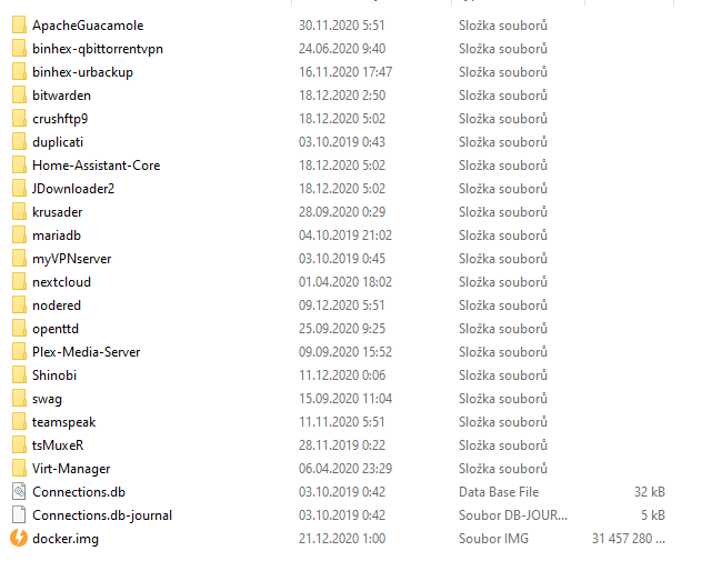

I have the appadata restored on the cache disk and I see it
Go to the Apps page and see if you have anything under Previous Apps. If your restored flash has the templates for your dockers then Previous Apps will use them to reinstall your dockers exactly as they were.
Omg it works very thank you👍.
