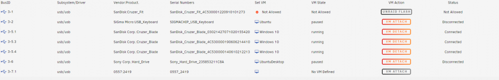

I have started writing a plugin for usbip support, and was looking for ways to identify if usb devices are allocated to other services to restrict people from adding to usbip. I have already disabled the boot flash drive. But there doesn't seem to be an easy way to see USB devices allocated or in use at a host level for VMs, but came across this thread whilst looking for solutions.
Within the plugin I have all the details about the USB devices including serial number if the device uses it as some do not like the keyboard and BMC(kb and mouse) on my system. So I have started to see if I can add VMs.

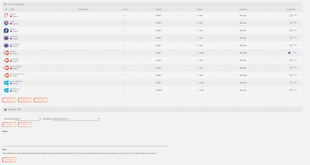

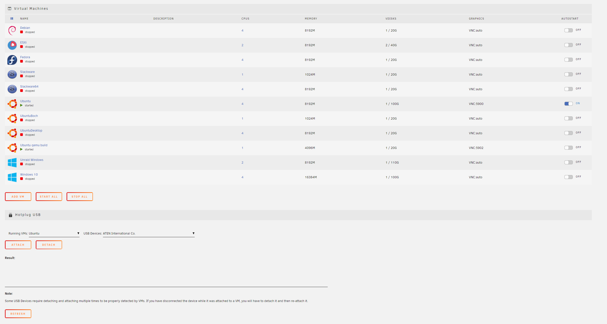

Currently working on the processing of udev rules to support updates to my list if someone plugs in devices, but this could also be enhanced to include attaching to the VM if it is running. I will use dlandons libvirt-hot-plug plugin to assist with this so you will need to have it installed also. And likewise remove from VM if unplugged.
If I can find a way to be informed of a VM being started I may also be able to allocate devices after it has started.
My plugin is still in beta but I have added VMs to the screen so far but it is way off being ready for use.

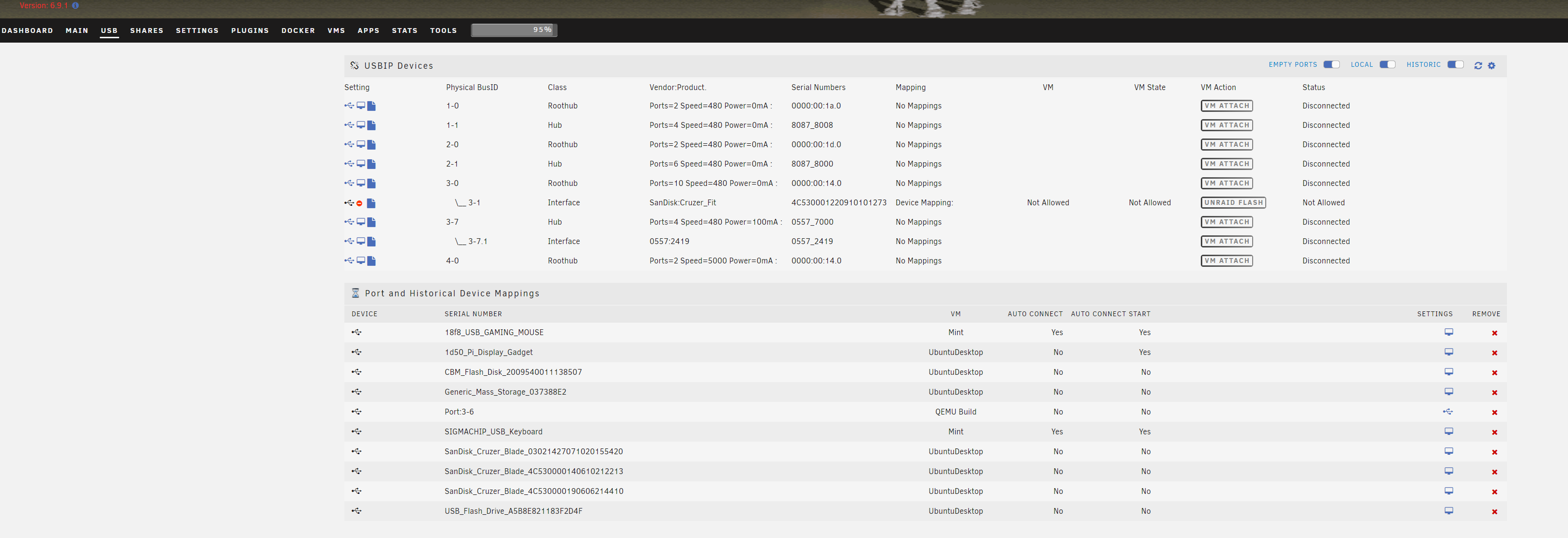

My current VMs defined on this system.
I am still working on this, but now have the option to connect multiple devices of the same vendor/product to a VM.
Currently it is still dependent on USBIP commands which I am planning to change. Also not released yet but its will auto connect to a VM when the usb is plugged in and the VM is running.
Whilst it is using USBIP commands it is limited to > 6.9.0-rc2 but hopefully soon I will release version that will run on 6.8.

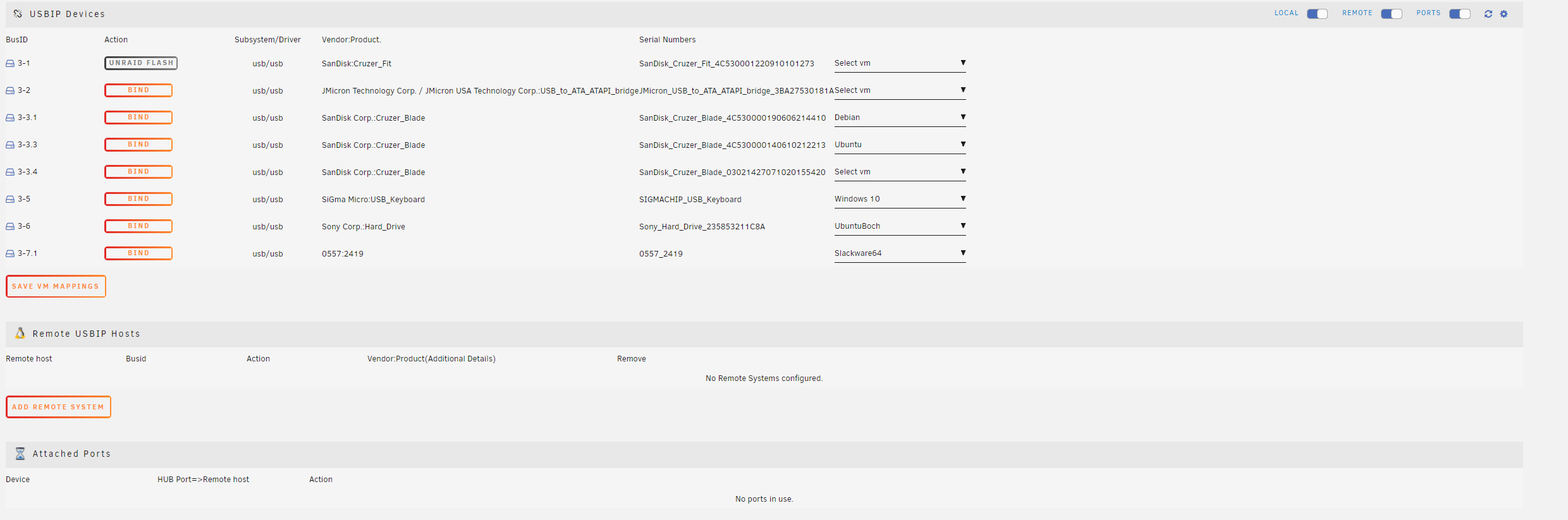

Version 08.02.2021 released today. This is still a beta release.
udev rules are in now place. If VM defined and Autoconnect is set USB device will be connected to the VM when plugged in. Minimum release level changed to 6.8.

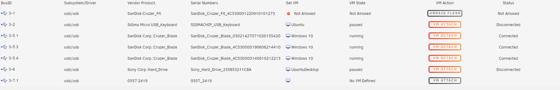

Screen from 6.9.1
Edited by SimonF
49 minutes ago, SimonF said:
Yes runs on 6.9, 6.8 is minimum release.
Screen from 6.9.1
