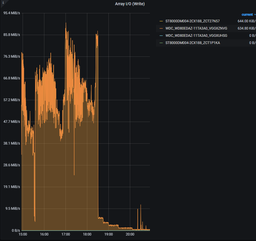

Did some more testing, this time I rebooted the system and left the vm manager completely disabled.  Over time ended up with the same result file transfers slowed to under 300KB/s.
This is a screen shot from grafana.  I was copying a bunch of large movies and it was fast for a long time then suddenly dumped down to 5MB/s and trailed off to the speed it is now while I'm posting this under 300KB/s.
Not sure what to try next, I guess I could uninstall plugins, or maybe upgrading to 6.9.x?
