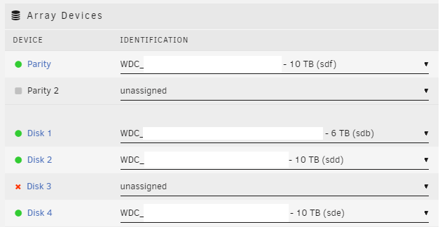

Currently where I'm at right now, my setup looks like this:
I did start the array and then stopped it after I saw it was emulating the drive and not attempting to do any rebuild. So it seems as though I've covered the first 6 steps from that link you provided.

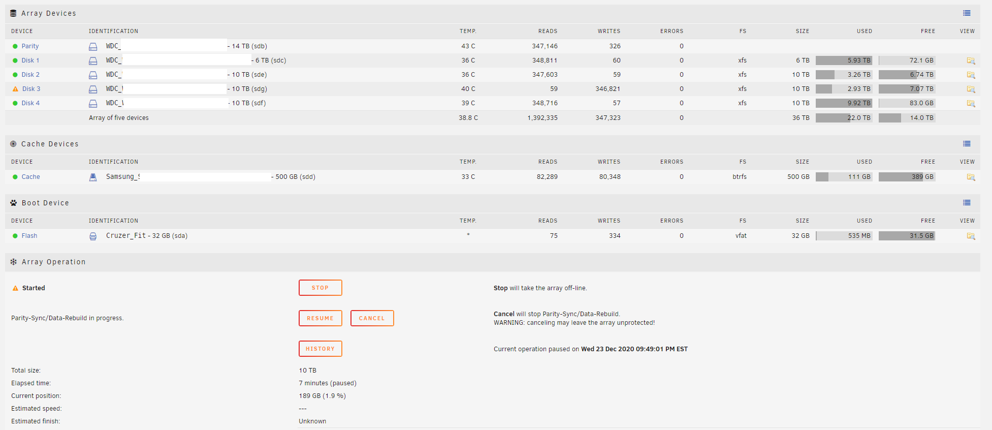

So, I'm reviving this topic a bit here... I've done the parity swap, it recently just finished copying the contents of the one parity over to the next, and I've now started the array and it's going through attempting to do a Parity-Sync/Data-Rebuild... the problem is that it keeps pausing itself every ~2minutes. I have no idea why it pauses. I can click Resume, and it'll continue for another couple minutes, then pause again.
I really don't want to be sitting here for 20 hours clicking Resume every couple minutes.
Post diagnostics
I think I just figured out what was happening. I have Parity Check Tuning installed, and it was configured to pause the parity check when it was within 3 degrees below the warning disk temperature threshold. The warning threshold was at 45, and you can see even in my screenshot the parity drive was at 41c.
Makes sense since these two drives have been running nonstop for the past 30 hours.
I've inched that warning temp up to 50, and will keep an eye on it and see where it goes from there.
Edit: Just grabbed the syslog file and I see parity drive temp warnings in there and the pause state being enabled. Sure looks to be it.

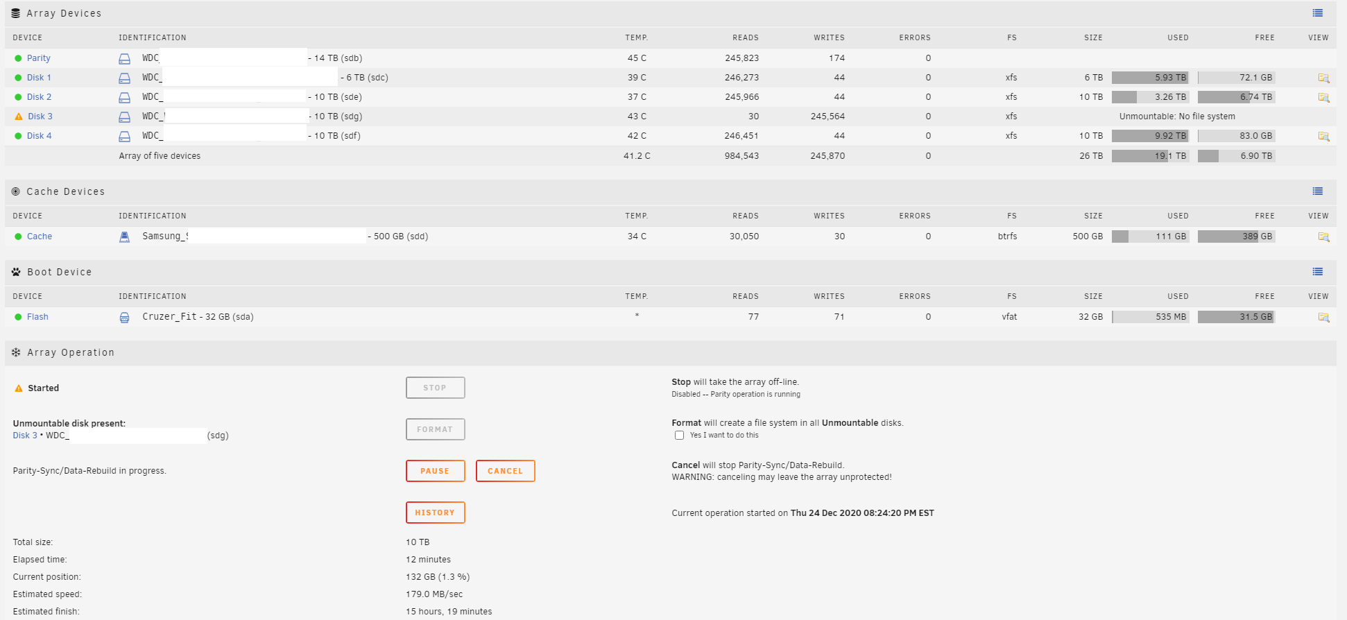

Running into another issue now though... During this rebuild process I've had my system do a hard reset about 5x now. Each time it does this, it's completely reset all rebuild progress and starts back over with an estimated 16 hour rebuild time and 0% progress... Just recently it was at about 55% and then I got a notification about the restart, and sure enough it's back to 0% and only been running for 5 minutes.
Now after this latest reset I see the following:
I've not seen that warning about an unmountable disk before... I assume it's because it was the one being written to and getting in sync and now it's corrupted due to the restart, but I have no idea.
Unfortunately after restarts the syslog gets completely cleared so I'm not sure how to tell what's going on.
I've not had any issues with restarts, or anything until this one disk failed, and this just seems to have caused a rolling shitshow of one issue after the issue now.
