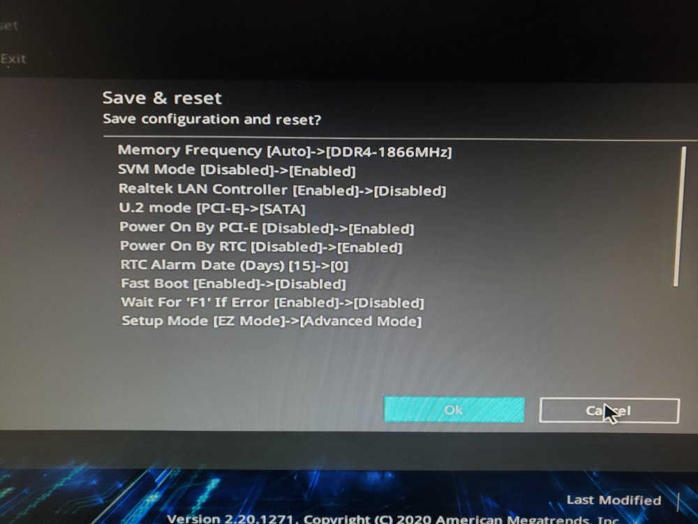

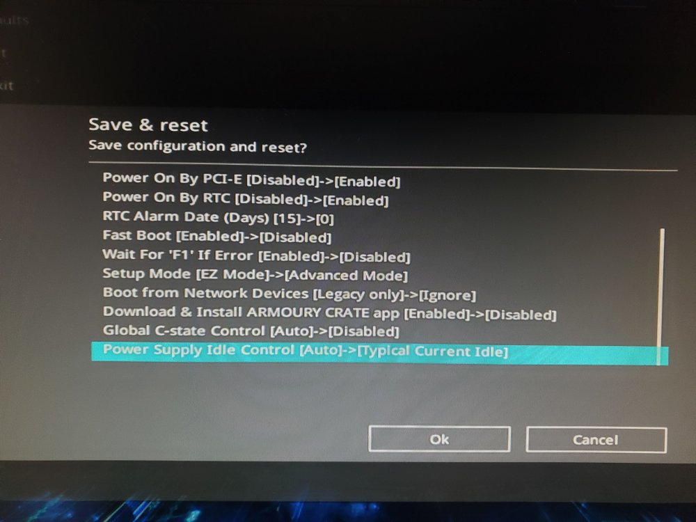

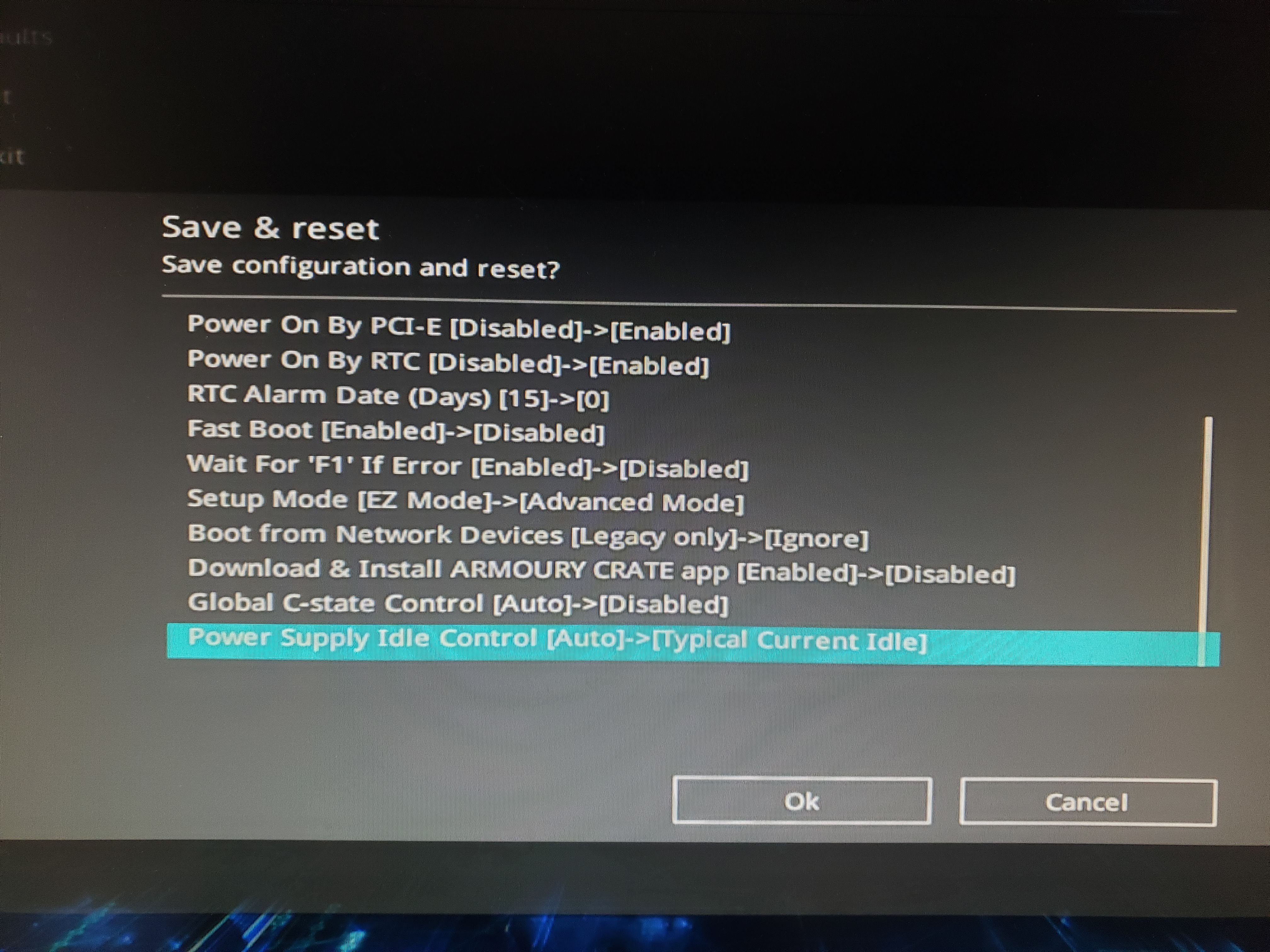

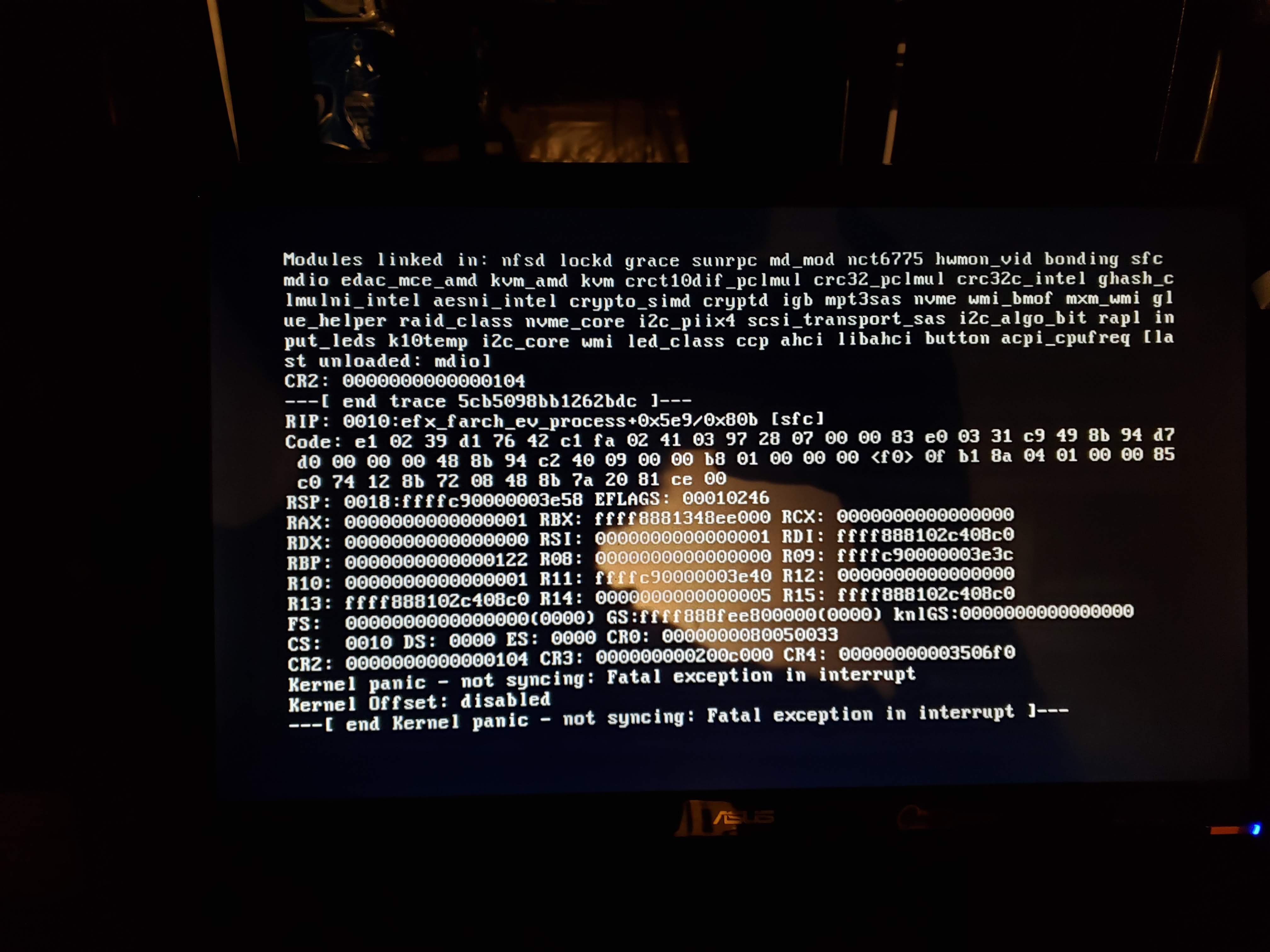

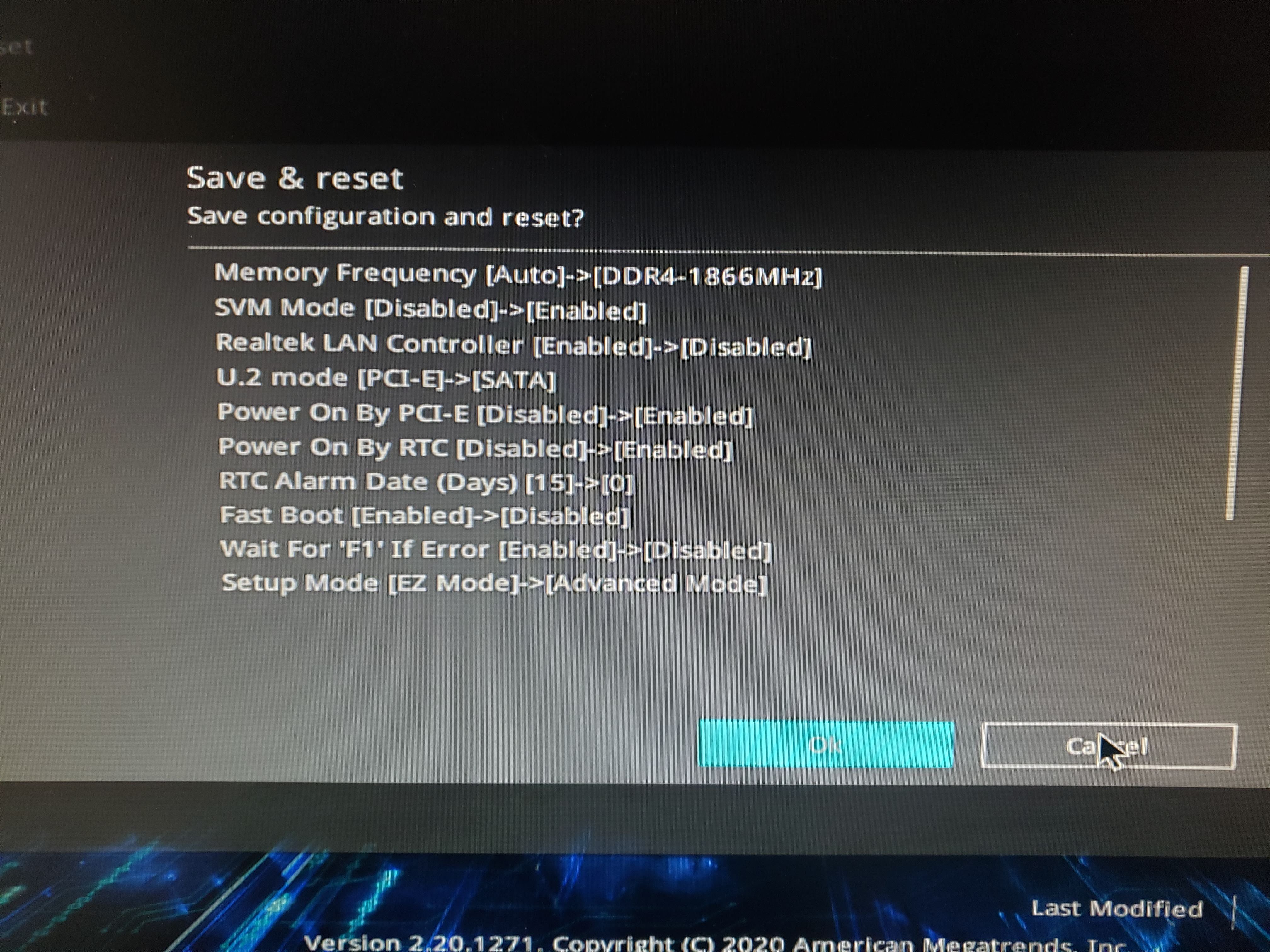

I don't know what I'm doing wrong. I've attached a video of it crashing and screenshots of my bios settings.
Am I missing something in the bios? Did I do something wrong? I'm at my wits end with unraid constantly having issues. I've never been stable for more than 7 days. I'm about to give up.

- researching efx_farch_ev_process right now
Just tried safe mode, same error.

A simple suggestion, pls try unplug the GPU and check panic or not.

restored back to 6.9.0-rc1, seems to be working :/ Guess I'll post this in the issues for rc2.
