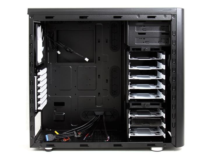

Get a Fractal Design Arc Midi R2 used.  Can do 8 x 3.5 drives and has 2 x 5.25" drive bays.
