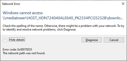

I retired this 4TB drive from my array and would like to use it as an unassigned device.
Is there any way to rename the Top Level Share name?

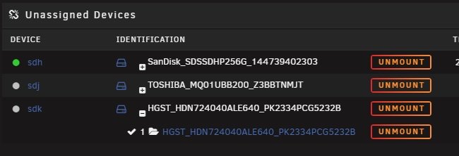

Currently it is HGST_HDN724040ALE640_PK2334PCG5232B
It's too cryptic to use right now windows won't even recognize that.

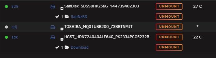

First unmount the drive and then Click on the name field and you should be able to edit it to something more manageable.   Press Enter after making the change.
Ok I did that and re-mounted the drive.  When I try to access that share from Windows I get the "Cannot access share" message.  I also tried accessing the share directly(\\mediatower\download) - that didn't work either.  I don't understand what my issue is here.  I have another UD with a share that I'm able to access(SabNzbd) without any issues.
Edited by a12vman
Ok I got this sorted out.  I didn't have the "Share" option toggled.
I toggled Share on and waited a few minutes - all good now.
