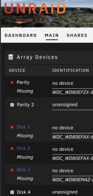

I apologize if this has been discussed before, I did try a search, but couldn't find an exactly similar situation.  I had four (4) 8 TB WD drives that all experienced what I believe to be a power spike / failure.  No disks would spin up when power was applied.  I've since sent them to a repair shop to be looked at and only two (2) of the drives are able to be recovered.  My setup included three (3) drives for data with one (1) in parity.  With two (2) drives failing, I believe I have a total loss of data at this point.  I'm trying to come to grips with this, as it truly is what it is, 2020 has struck... This configuration also included a SSD cache drive which still shows as available / good in unRAID and in BIOS.  I have purchased one (1) new 2TB drive for now, simply to get things back operational (I was utilizing, HomeAssistant, MQTT, Plex, Unifi, etc dockers and would prefer them to be working sooner than later).
Also, I'm hopeful, but honestly cannot remember if I had it setup to backup my appdata folder to the cache drive or the array or both.  The more I think about it, I think it was only the array, which sucks for obvious reasons...  I haven't re-started the array to check, because it is showing all of the drive failures and I didn't want to go down the wrong path.
Is there any reason to wait until the two (2) drives are recovered to do anything with the current unRAID array setup?
I've come to grips with the loss of data and have a better plan moving forward, but would really love some coaching as to the 'easiest' way to get things back to 'normal'.  Ideally, I'm able to start a new array and 'apply' my appdata from the existing cache drive to the new 2TB drive?

Is the repair shop aware that you need bit perfect copies of the drives and not just the files? If not, they may be writing off your parity drive as failed since it has no files. If you can get three out of 4 drives bit perfect, you are golden, as you can emulate the remaining drive.
The good news is each data drive is independent, so if they recover 2 data drives, you will have those files.
Do you have any diagnostic files from before the failure? They would contain helpful information.

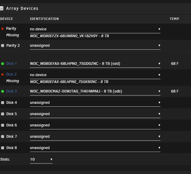

Unfortunately anything you generate now probably wouldn't be very helpful. I was hoping that maybe you had downloaded the diagnostics zip file prior to everything falling apart. If you boot the server, and don't attempt to start the array, you should still be able to go to tools, diagnostics, and download the diagnostics zip file as things currently stand.
Do you at least have a full copy of the screenshot you posted in the first post? You truncated the serial numbers, which are the important parts to identifying which drives were assigned to the slots.

Alright jonathanm, I'm looking to you for coaching.  Drives came back and unfortunately, they were right only 2 drives came back useful...
The parity and Disk 2.  It appears unRAID will NOT let me start the array with 'too many missing disks', what is the recommended strategy from here?  Any use in trying to access the drives somehow to recover files / things?  Or just blow it all up?  Again, I'm hopeful that I have good info on the cache drive, but don't know that either yet because I haven't started the array.  Much appreciated in advance!
Well, the good news is one of the bad drives is parity, so no direct data loss there. However, anything on disk2 is likely gone forever. Disk 1 and 3 may have data corruption, but you won't know that until you start the array.
Go to tools, new config, keep all. Go back to Main, and remove the faulty drive assignments, parity and disk2. You should then be able to start the array. Hopefully disk1 and disk3 will mount properly, UNDER NO CIRCUMSTANCES should you format anything if asked.

Well, you are TOTALLY right.  I may kiss someone, I had an additional 8 TB drive and in reality don't think I had used it much at all.  Started the new array, no errors, mount issues, or asking about formatting... I've already opened up some personal photos and SHOCKINGLY, they all seem to be there.  Apparently I was lucky this time around. Thanks again so much!  Maybe 2020 wasn't such a bust.  Happy New Year!
This characteristic of Unraid is one of the extreme differentiators from other RAID systems. With traditional RAID, when you exceed the redundancy level, you lose everything. With Unraid, each parity protected array drive is a separate filesystem, so normally you only lose the content actually on the failed drives, all the intact drives are readable.
Just be very glad one of the failures was the parity drive, otherwise you would have lost the contents of 2 data drives instead of one. This was a very hands on lesson on why parity is arguably the LEAST important drive in the array, as it holds no data by itself, only if all the remaining data drives are healthy can the parity drive actually rebuild a missing drive.
