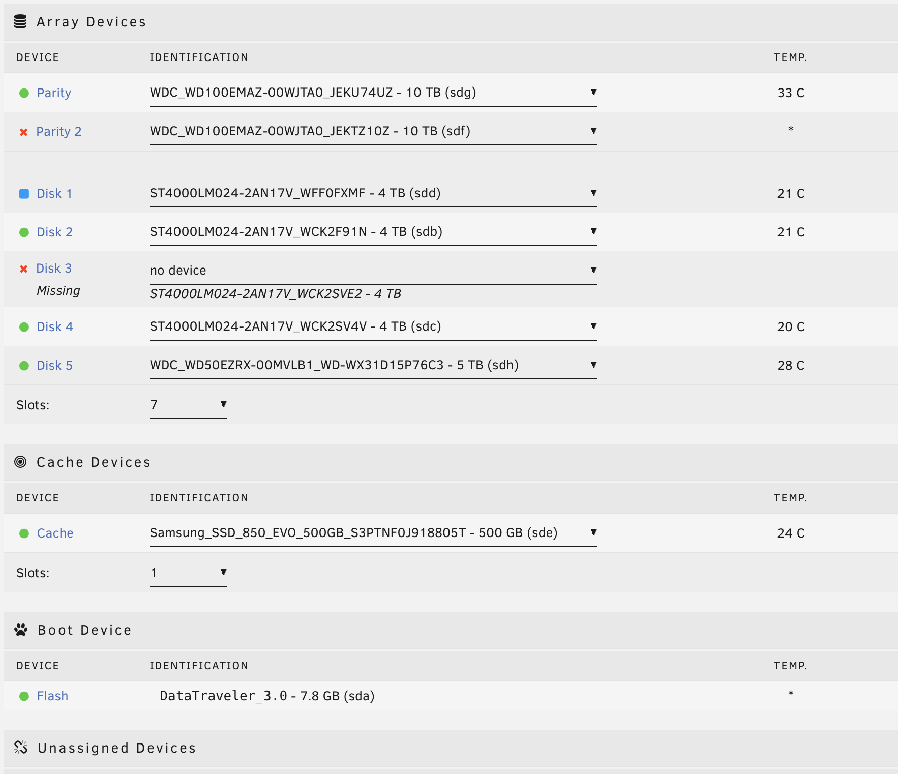

13 minutes ago, rawfuls said:
I figured a reboot would fix it
Once a disk gets disable it needs to be re-enable/rebuilt.
Please post a screenshot of main to see current array status.
Sorry, I meant reboot, start array with it unassigned, then reassign it. Let parity rebuild and the error go away.
Parity 2 is not showing any yellow abnormalities for disk attributes. I rebooted before I could find out what the error was on it getting disabled.
Disk 1 is showing available (it does power on and read), but it's error is UDMA CRC error count - this was a known issue, I was waiting for me to arrive home (today) to pull the drive. I should have unassigned the drive first and rebuilt the array around it, but alas.
Disk 3 isn't powering back up, at all, this seems like a catastrophic failure.
So current disk1 is also new correct?
No, Unraid is seeing it as new because the array has been started/stopped without it prior.
So now replugging it back in, Unraid sees it as new; however the disk still has data and has never been wiped.
But if the array was used without it parity won't be valid if you re-enabled it now, you'd need to rebuild both, again assuming parity2 is still valid, or they won't rebuild correctly.
