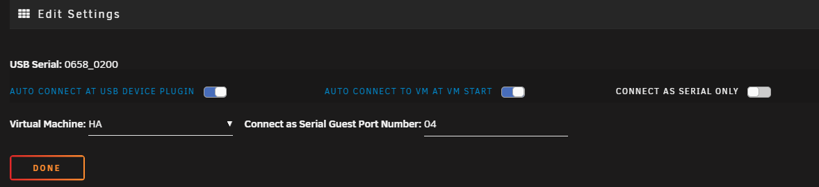

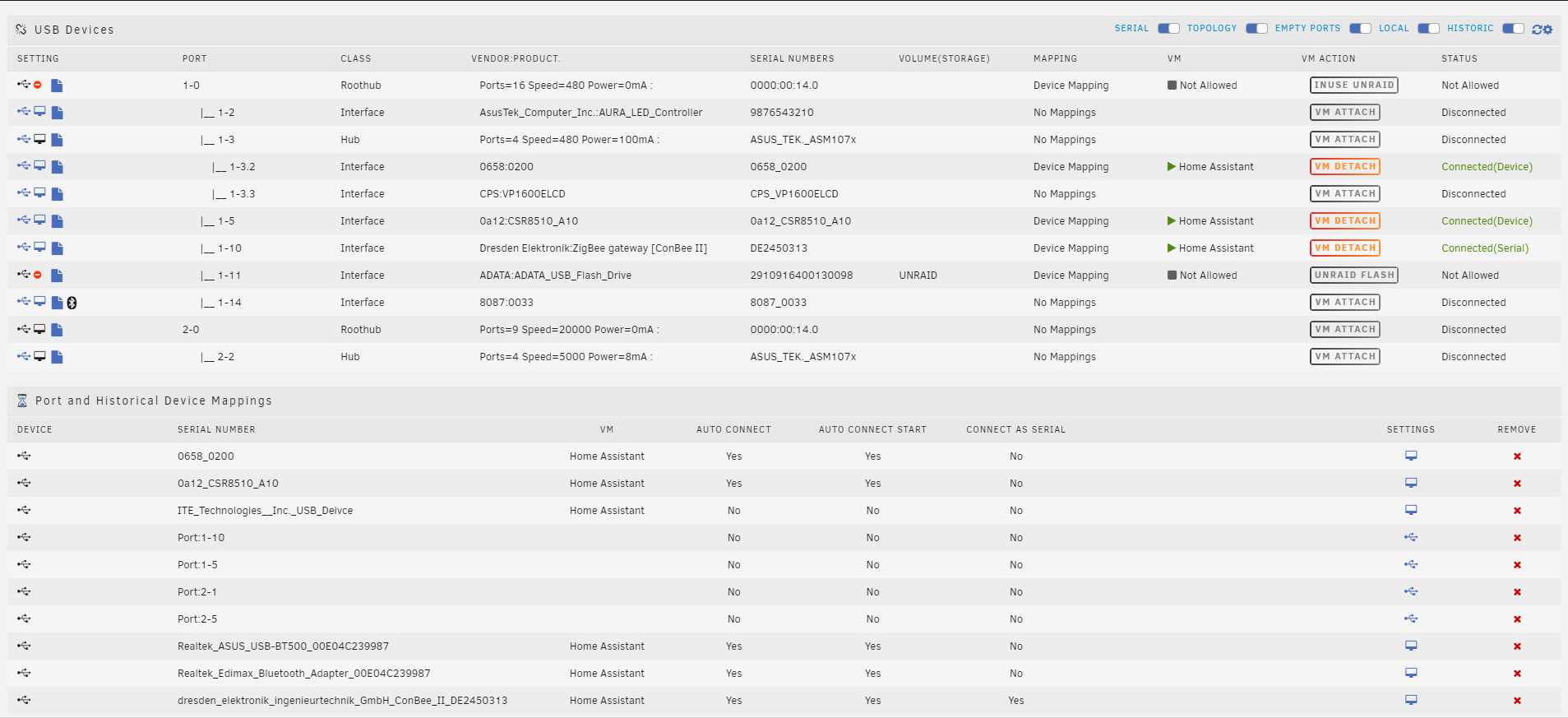

I have recently changed server and started to notice issues with auto-connecting USB devices to VM.
I pass 3 devices to one of my VMs - Zigbee controller (passed as serial device), Zwave controller (passed as device) and bluetooth. They are all configured to auto connect to my VM, but that is not happening. If I reboot, at least 2 show that they are not attached and I have to click the button to attach it.
How can I figure out why is this happening?

Which OS version are you running?
and can you provide output of cat /var/log/syslog | grep usb_manager
It is home assistant OS (VM), unraid 6.11.5

Feb 11 13:24:33 Tower usb_manager: Info: rc.usb_manager Building Connected Status
Feb 11 13:24:55 Tower usb_manager: Info: rc.usb_manager Reset Connected Status
Feb 11 13:25:23 Tower usb_manager: Starting usbip config check...
Feb 11 13:25:53 Tower usb_manager: Info: rc.usb_manager usb_remove  dresden_elektronik_ingenieurtechnik_GmbH_ConBee_II_DE2450313 /dev/bus/usb/001/006 001 006
Feb 11 13:25:53 Tower usb_manager: Info: rc.usb_manager Device Match 001/006 vm:   001 006
Feb 11 13:25:53 Tower usb_manager: Info: rc.usb_manager Removed 001/006 vm:  nostate 001 006
Feb 11 13:25:54 Tower usb_manager: Info: rc.usb_manager usb_add dresden_elektronik_ingenieurtechnik_GmbH_ConBee_II_DE2450313 /dev/bus/usb/001/010 001 010
Feb 11 13:25:54 Tower usb_manager: Info: rc.usb_manager Add device with more than one interface & connect serial yes  .
Feb 11 13:25:54 Tower usb_manager: Info: rc.usb_manager unable to connect device as Serial device details unknown for dresden_elektronik_ingenieurtechnik_GmbH_ConBee_II_DE2450313.
Feb 11 13:25:54 Tower usb_manager: Info: rc.usb_manager tty_add dresden_elektronik_ingenieurtechnik_GmbH_ConBee_II_DE2450313 /dev/ttyACM1
Feb 11 13:25:54 Tower usb_manager: Info: rc.usb_manager Processing tty attach dresden_elektronik_ingenieurtechnik_GmbH_ConBee_II_DE2450313 /dev/ttyACM1 001 010
Feb 11 13:25:54 Tower usb_manager: Info: rc.usb_manager Add device with more than one interface & connect serial yes 1 1.
Feb 11 13:25:54 Tower usb_manager: Info: rc.usb_manager Autoconnect vm state:running dresden_elektronik_ingenieurtechnik_GmbH_ConBee_II_DE2450313 running 001 010
Feb 11 13:25:54 Tower usb_manager: Info: connect as serial guest port is:04
Feb 11 13:25:54 Tower usb_manager: Info: virsh called Home Assistant 001 010 Device attached successfully
Feb 11 13:25:58 Tower usb_manager: Info: rc.usb_manager usb_remove  dresden_elektronik_ingenieurtechnik_GmbH_ConBee_II_DE2450313 /dev/bus/usb/001/010 001 010
Feb 11 13:25:58 Tower usb_manager: Info: rc.usb_manager Device Match 001/010 vm: Home Assistant  001 010
Feb 11 13:25:58 Tower usb_manager: Info: connect as serial guest port is:04
Feb 11 13:25:58 Tower usb_manager: Info: virsh called Home Assistant 001 010 Device detach request sent successfully
Feb 11 13:25:58 Tower usb_manager: Info: rc.usb_manager Disconnect  001/010 vm: Home Assistant running 001 010
Feb 11 13:25:58 Tower usb_manager: Info: rc.usb_manager Removed 001/010 vm: Home Assistant running 001 010
Feb 11 13:25:58 Tower usb_manager: Info: rc.usb_manager usb_add dresden_elektronik_ingenieurtechnik_GmbH_ConBee_II_DE2450313 /dev/bus/usb/001/011 001 011
Feb 11 13:25:58 Tower usb_manager: Info: rc.usb_manager Add device with more than one interface & connect serial yes  .
Feb 11 13:25:58 Tower usb_manager: Info: rc.usb_manager unable to connect device as Serial device details unknown for dresden_elektronik_ingenieurtechnik_GmbH_ConBee_II_DE2450313.
Feb 11 13:25:58 Tower usb_manager: Info: rc.usb_manager tty_add dresden_elektronik_ingenieurtechnik_GmbH_ConBee_II_DE2450313 /dev/ttyACM1
Feb 11 13:25:58 Tower usb_manager: Info: rc.usb_manager Processing tty attach dresden_elektronik_ingenieurtechnik_GmbH_ConBee_II_DE2450313 /dev/ttyACM1 001 011
Feb 11 13:25:58 Tower usb_manager: Info: rc.usb_manager Add device with more than one interface & connect serial yes 1 1.
Feb 11 13:25:58 Tower usb_manager: Info: rc.usb_manager Autoconnect vm state:running dresden_elektronik_ingenieurtechnik_GmbH_ConBee_II_DE2450313 running 001 011
Feb 11 13:25:58 Tower usb_manager: Info: virsh called Home Assistant 001 011 Device attached successfully
Feb 11 13:26:40 Tower usb_manager: Info: virsh called Home Assistant 001 005 Device attached successfully
Feb 11 13:26:42 Tower usb_manager: Info: virsh called Home Assistant 001 004 Device attached successfully
Edited by stefan.tomko

4 minutes ago, stefan.tomko said:
Yeah I figured that out late. Updated post above. I am on 6.11.5
Have the ports numbers changed on the new system?
Can you screen print the usb manager page?

I just updated some of my USB Coordinator sticks for my Home Assistant VM running on unraid.  I needed to install this plugin (which is amazing) because all three of my new coordinators were being identified as the same hardware which was causing issues with the Standard USB Pasthrough and as a result my Home Assistant would not start and displayed an execution error.  After fumbling a bit I got this set up using Port mappings and it worked well.  However it seemed if I rebooted the VM, not all the USB devices reconnected properly.  I was able to reconnect them from the USB Manager GUI but I would prefer not to have to remember to do this everytime I reboot?
So I updated my setting and mapped these coordinators as Devices which also worked.  Have not rebooted and will not unless I have some issues or need updates.  I was though curious if others had similar experiences and which version (port or device) you are using to map to Home Assistant?
Lastly, with my coordinators mapped as devices versus ports, if I unplug a coordinator and move it to a different USB Port will it still be recognized and connect properly?  I kinda assumed if I used the port method and connected to a different port when re-plugging the cordinator it might not be recognized.  Thanks!
Did you set them to auto connect in the mappings at VM start?
Sliders at the top.
If you set mapping as device it will map no matter where the device is connected as long as there is a unique serial.
Port will map that specific port to the VM no matter which device is connected to it. Useful if duplicate USB and duplicate serials or no serial.
Thanks so much for the quick reply.  I am glad to hear that if using the device mapping it does not matter what port my coordinators are plugged into.  That puts that concern to rest!  On the question of "Did you set them to auto connect in the mappings at VM start", I am pretty sure I did but when tinkering at the time I was first setting this up maybe I made a mistake?  I will see how it goes for now and let you know if I see any additional issues.  Probably user error.....
