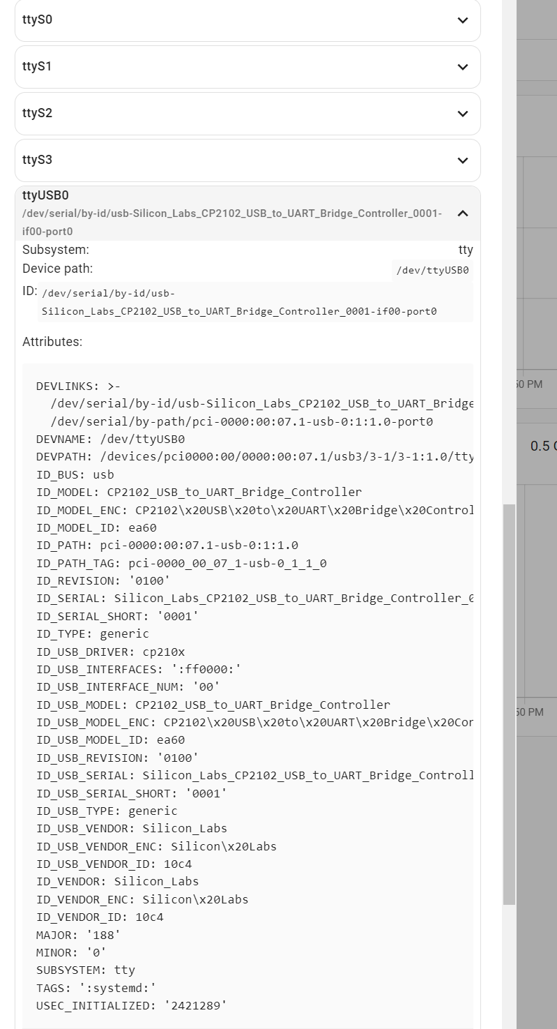

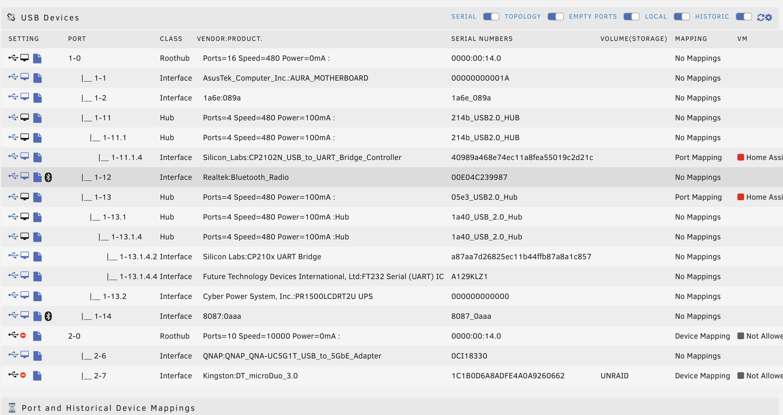

Depends if you need to map as a whole device or as a serial port. I can see the device in HA.

How is it when I would like to pass a whole USB 2.0 Hub to a VM? As Home Assistant like USB 2.0 Hub, especially on zigbee I would like to pass the whole hub though. Is it any reliable way to do that? For me it seems like 1-13.1 -> is the hub as 1-13.2 is the UPS plugged on the USB2 plug next to the HUB.
Also of the three options should I usually choose? Automount on start, or on vm. What does serial do? And lastly dpes Connect as Serial Guest Port Number do, and why is it always 4?

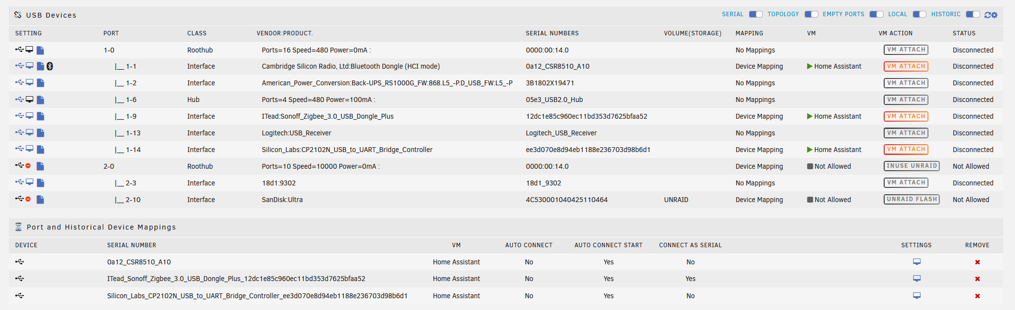

It is not possible to pass a hub through to a VM so the plugin emulates this as passes through each device that is connected to that hub.
Auto connect at plugin will attach a device to a VM if it is running if you physically connect a device i.e. hotplug.
Auto connect at start will connect the device to the VM when it starts.
Connect as serial changes the way the device is connected to the VM. it will be connected as serial port rather than a usb device. Conbee II need this option. The port number is the device number on the VM USB hub, so if you had two devices then you would need to set the other one to a different port number, this is only used for serial option.
in HA the serial mapped device will show like this. -4 is the port number

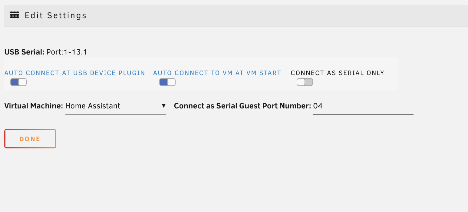

I'm having an issue where Connect as Serial Guest Port Number won't change from 04.  I need to change it to 00, since that is what my HA VM is expecting.  I recently ran into this issue after upgrading Unraid.  I can get it to work if I hotplug the USB devices in the correct order, but ideally I would like to set it and forget it like I had it before.  It works when the device is classified as ttyUSB0.  Here is the hardware info when it works:

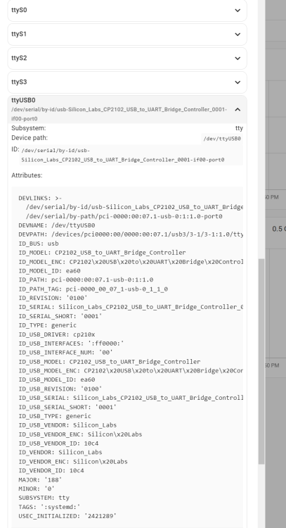

Which port are you using in HA you should map using /dev/serial/by-id rather than tty Id will have qemu in the path.
port number is the device port on tbe usb hub within Ha not related to tty name. Only reason to change port would be if you need two devices or another usb device is i. port 4
/dev/serial/by-id/usb-QEMU_QEMU_USB_SERIAL_1-0000:00:07.7-4-if00-port0
if ($port == "") $port="04" ;
    usb_manager_log("Info: connect as serial guest port is:".$port);
    $usbstr .= "<serial type='dev'>
    <source path='{$isSerialPath}'/>
    <target type='usb-serial' port='1'>
    <model name='usb-serial'/>
    </target>
    <alias name='ua-serial{$usbbus}{$usbdev}'/>
    <address type='usb' bus='0' port='{$port}'/>
    </serial>" ;

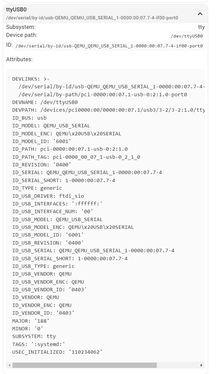

41 minutes ago, clowncracker said:
So I'm not exactly sure what I should do.  Right now I do have three USB devices hooked up to the VM, but Zigbee only works if it's the first device connected.  Do you want me to add that code somewhere?
In HA do you see a device with the following path in the Hardware details?
Use this for the path to the dongle for the integration rather than ttyUSB0
What output do you get in system->hardware

The USB devices were disconnected from the VM when I ran that (the VM was off).  Reran it with the VM on (when VM Attach was still showing) and after manually attaching the USB devices in manager, both led to the same output.
Where is the output of that script?  It didn't display anything after running.
Edited by clowncracker
2 minutes ago, clowncracker said:
The USB devices were disconnected from the VM when I ran that (the VM was off).  Reran it with the VM on when VM Attach was still showing and after manually attaching the USB devices in manager led to the same output.
No it should rebuild the  /usr/local/emhttp/state/usb.ini  file
entries should look like this. Only suggestion I have is to maybe do a reboot if you can?

/usr/local/emhttp/state/usb.ini before restarting server:
[001/005]
VM = ""
virsh = "error: Failed to attach device from /tmp/libvirthotplugusbbybusHome Assistant-001-005.xml
error: internal error: unable to execute QEMU command 'chardev-add': Failed to add chardev 'charua-serial001005': Could not open '/dev/serial/by-id/': Is a directory
connectmethod = "Manual"
connectmap = "Serial"
virsherror = ""
connected = ""
bus = 001
dev = 005
ID_VENDOR_FROM_DATABASE = ""
ID_VENDOR_ID = "10c4"
ID_MODEL = "Sonoff_Zigbee_3.0_USB_Dongle_Plus"
ID_MODEL_ID = "ea60"
USBPort = "1-9"
class = "interface"
parents = "usb1,0000:00:14.0,pci0000:00"
ID_SERIAL = "ITead_Sonoff_Zigbee_3.0_USB_Dongle_Plus_12dc1e85c960ec11bd353d7625bfaa52"
isSerial = "1"
isSerialPath = "usb-ITead_Sonoff_Zigbee_3.0_USB_Dongle_Plus_12dc1e85c960ec11bd353d7625bfaa52-if00-port0"
[001/007]
virsherror = ""
connected = ""
VM = ""
virsh = "Device attached successfully
connectmap = "Device"
bus = 001
dev = 007
ID_MODEL = "CP2102N_USB_to_UART_Bridge_Controller"
USBPort = "1-14"
class = "interface"
ID_SERIAL = "Silicon_Labs_CP2102N_USB_to_UART_Bridge_Controller_ee3d070e8d94eb1188e236703d98b6d1"
isSerial = "1"
isSerialPath = "usb-Silicon_Labs_CP2102N_USB_to_UART_Bridge_Controller_ee3d070e8d94eb1188e236703d98b6d1-if00-port0"
[001/002]
virsherror = ""
connected = ""
VM = ""
bus = 001
dev = 002
ID_VENDOR_FROM_DATABASE = "Cambridge Silicon Radio, Ltd"
ID_VENDOR_ID = "0a12"
ID_MODEL = "CSR8510_A10"
ID_MODEL_ID = 0001
USBPort = "1-1"
class = "interface"
ID_SERIAL = "0a12_CSR8510_A10"
isSerial = ""
isSerialPath = ""
[001/001]
connected = ""
bus = 001
dev = 001
ID_VENDOR_FROM_DATABASE = "Ports=16
 Speed=480
 Power=0mA
ID_VENDOR_ID = "1d6b"
ID_MODEL = ""
ID_MODEL_ID = 0002
USBPort = "1-0"
class = "roothub"
parents = "0000:00:14.0,pci0000:00"
ID_SERIAL = "Linux_5.19.17-Unraid_xhci-hcd_xHCI_Host_Controller_0000:00:14.0"
isSerial = ""
isSerialPath = ""
[001/006]
connected = ""
bus = 001
dev = 006
ID_VENDOR_ID = "046d"
ID_MODEL = "USB_Receiver"
ID_MODEL_ID = "c52b"
USBPort = "1-13"
class = "interface"
ID_SERIAL = "Logitech_USB_Receiver"
isSerial = ""
isSerialPath = ""
[001/003]
connected = ""
bus = 001
dev = 003
ID_VENDOR_ID = "051d"
ID_MODEL = "Back-UPS_RS1000G_FW:868.L5_-P.D_USB_FW:L5_-P"
ID_MODEL_ID = 0002
USBPort = "1-2"
class = "interface"
ID_SERIAL = "American_Power_Conversion_Back-UPS_RS1000G_FW:868.L5_-P.D_USB_FW:L5_-P_3B1802X19471"
isSerial = ""
isSerialPath = ""
[001/004]
connected = ""
bus = 001
dev = 004
ID_VENDOR_FROM_DATABASE = "Ports=4
 Speed=480
 Power=100mA
ID_VENDOR_ID = 05e3
ID_MODEL = ""
ID_MODEL_ID = 0610
USBPort = "1-6"
class = "hub"
ID_SERIAL = "05e3_USB2.0_Hub"
isSerial = ""
isSerialPath = ""
[002/003]
connected = ""
bus = 002
dev = 003
ID_VENDOR_ID = "18d1"
ID_MODEL = 9302
ID_MODEL_ID = 9302
USBPort = "2-3"
class = "interface"
parents = "usb2,0000:00:14.0,pci0000:00"
ID_SERIAL = "18d1_9302"
isSerial = ""
I rebooted the server the and USB devices connected correctly.  Go figure sometimes all you need is a reboot.
Thanks for the help!
EDIT:  I also got the updated serial ID in HA working correctly.  So all of my problems are solved.

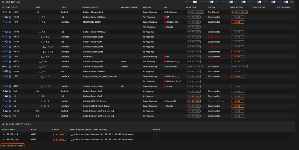

does the plugin shows somehow/somewhere what are the actual speeds of connected devices?
No but may be able to add. Will need to investigate.
wow. good to hear that. i thought that may the plugin shows the hub's speed and/or the exact device (for example a USB drive's) capability. it would be helpful cause sometimes the plastic in the usb connectors are all black while some of them 3.0. and device manufacturers also lazy some cases. it is painful to figure the capabilities.
Edited by ihazcat

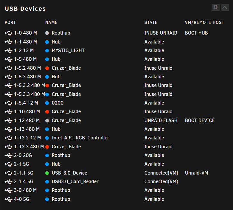

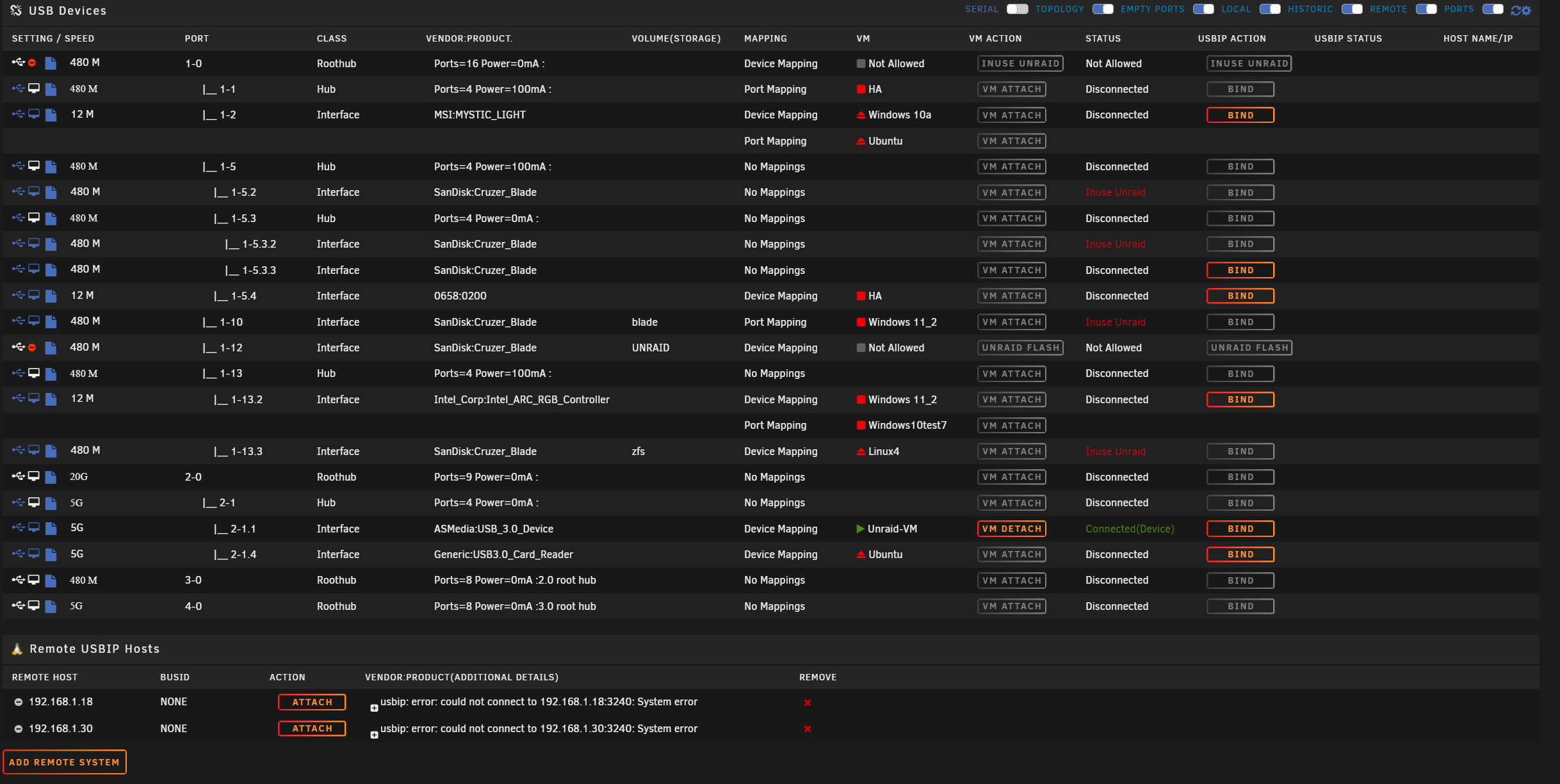

Is this the type of info you are looking for? I have added next to class type.
yes! could you please make it a bit compact? because my guess it won't fit well on dashboard. maybe just a column with the actual protocol or icons. and is it possible to detect the connected devices max supported speeds?
The usb speed icons are not available in the icons used within unraid.
Available values are below, I dont think there is a way to show the max supportable value, just the value it it currently connected at.
root@computenode:~# udevadm info -a  --path=/sys/bus/usb/devices/1-13.2
Udevadm info starts with the device specified by the devpath and then
walks up the chain of parent devices. It prints for every device
found, all possible attributes in the udev rules key format.
A rule to match, can be composed by the attributes of the device
and the attributes from one single parent device.
  looking at device '/devices/pci0000:00/0000:00:14.0/usb1/1-13/1-13.2':
    KERNEL=="1-13.2"
    SUBSYSTEM=="usb"
    DRIVER=="usb"
    ATTR{configuration}==""
    ATTR{bMaxPacketSize0}=="64"
    ATTR{bDeviceClass}=="00"
    ATTR{bcdDevice}=="0110"
    ATTR{bNumInterfaces}==" 3"
    ATTR{bConfigurationValue}=="1"
    ATTR{manufacturer}=="Intel Corp"
    ATTR{bNumConfigurations}=="1"
    ATTR{authorized}=="1"
    ATTR{speed}=="12"
    ATTR{idProduct}=="01b5"
    ATTR{urbnum}=="22"
    ATTR{devnum}=="10"
    ATTR{product}=="Intel ARC RGB Controller"
    ATTR{maxchild}=="0"
    ATTR{bmAttributes}=="e0"
    ATTR{bDeviceSubClass}=="00"
    ATTR{bMaxPower}=="100mA"
    ATTR{rx_lanes}=="1"
    ATTR{removable}=="removable"
    ATTR{idVendor}=="2516"
    ATTR{version}==" 2.00"
    ATTR{avoid_reset_quirk}=="0"
    ATTR{bDeviceProtocol}=="00"
    ATTR{tx_lanes}=="1"
    ATTR{ltm_capable}=="no"
    ATTR{devpath}=="13.2"
    ATTR{busnum}=="1"
    ATTR{quirks}=="0x0"

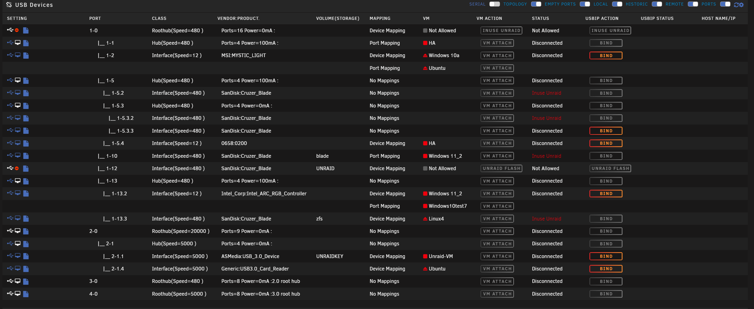

I have moved the location but not sure will be able to put onto dashboard as does not look great or a place to put it.
So can add as hoover text which would look better.
oh okay. i thought it is easy to add graphical elements or shorter/more relevant strings. is it out or polishing it?
