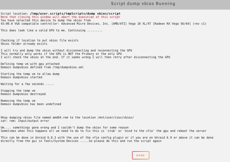

Got the following error:
cat: rom: Input/output eror
Did powerdown the server stopped docker and had all VM's set to not autostart. The Tools/System Devices does have the Video and Audio checked. GPU is not primary.

@soana  @frodr @reporrted
Some extra things you can try .
1. Stub gpu
2 Shutdown fully the server then start server. (not reboot)
3. make a temp vm using ovmf attach the gpu you want vbios from start vm up then after couple seconds force stop.(the script makes one with seabios )
run script
If still getting an error repeat above then edit sctipt and look for a variable forcereset="no" and change it to yes. This will force the scr4upt to always disconnect sleep the server then reconnect before dumping the vbios.

I was able to download the vbios. But I am not able to connect with the Vega 64 as GPU. I do get an IP address. When setting the GPU as secondary GPU I only get a black screen and no IP. I might be that it is something wrong with the GPU. I will pull it out, build it back to air cooling from current liquid cooling, and start all over again.
@frodr which one of the extra options worked for you?  I am in similiar situation with a GTX 1660, getting same message as you posted above....

Well, not really sure. The first one not work out, then tried the second. I somehow misunderstood and the end. Well up and running again, I ram the script with forcereset="no". And then it worked.
Ah in answer to my own question above it seems to be working now once the extra steps includinf the YES change in the config.  Thanks so much to Spaceinvader one for all your help on this and other videos also
