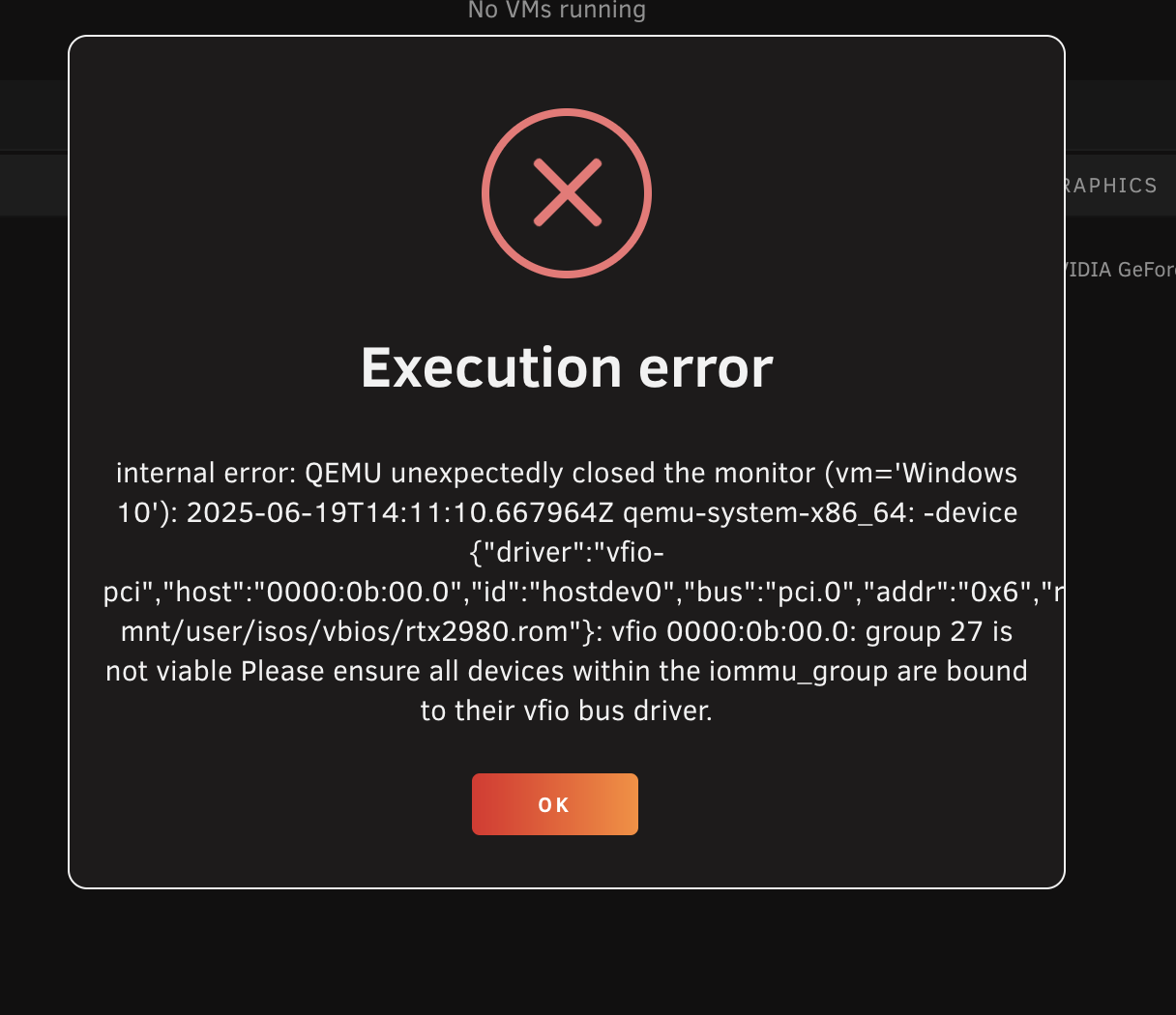

Vbios dumped from my evga 2080. I seem to be having trouble passing the GPU through. I haven't had time to mess with it yet. In addition, I have provided a screenshot of the new issue. I assume I need to bind the GPU, as described in the video.=)
rtx2080.rom
Edited by SlyJDM
