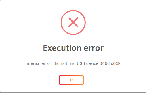

I have a monitor with KVM switch that is connected to a regular PC and to the Unraid server.
I want to pass the keyboard and mouse to a Windows10 VM on Unraid.
To do that I have to switch to another PC (or RDP to the reg PC) to make the keyboard and mouse available to the Windows10 VM Edit page.
So far, so good, no issue. But when I am on the reg PC, which is now the active keyboard/mouse of the KVM switch) when I want to start the Windows10 VM,
below error is thrown: "Did not find USB device..."
Yes, absolutely right! But, Unraid should discard any USB devices missing and not throw any errors.
Most if not all USB devices are plug&play and should not prevent the OS from booting.
So, is it possible to review the VM starting rules to avoid checking for missing USB device?
Please, let me know if you need +info on this issue or context
Thanks in advance
Just noticed that I can remove the USB keyboard and mouse while the VM is running
So, same rule here: why cant I add the USB keyboard and mouse after the VM has started?
You can either by editing the VMware while it’s running or by using the libvirt hot plug plugin
got ya! but that plugin requires that the VM is already started to attach the USB devices.
thats my dilema: the VM wont start if those USB devices are not connected at launch and the devices, in my case the KVM USB keyboard and mouse, wont show up in the device list until I switch them up
So edit the template so that they are not present in the template.  The VM will always start up.  Then attach them as required via the plugin.
I tried that and it does work. Still have to do it on another PC because the KVM keyboard and mouse only show in the list then
The best would be to have the devices dynamically linked once they are connected
