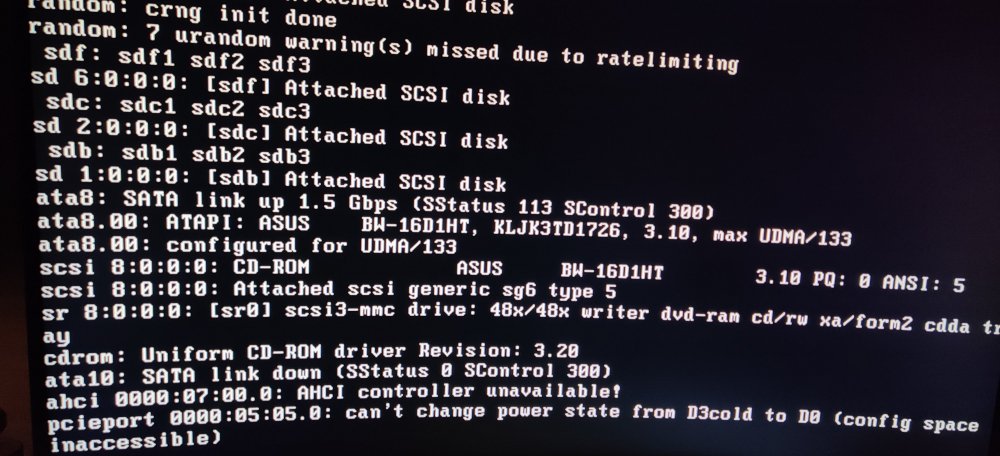

It recognizes the usb, and boots unraid, until it hard locks during boot. The last line on screen is:
pcieport 0000:05:05.0: can't change power state from D3cold to D0 (config space inaccessible)
Attached image of screen.
After this nothing happens.
I have tried enabling and disabling pcie power saving feature, and switching from uefi to legacy (and re creating the usb for legacy install)
Is there any way for me to enable logging?

UPDATE!
I disconnected the bluray writer, and now the server boots.
Do you know if this bluray writer model is incompatible somehow? link to asus website: https://www.asus.com/us/Optical-Drives-Storage/BW16D1HT/
The drive is connected to the SATA3_A1_A2 sata ports, page 8 (14) in user manual.
This is a shared port with the m.2 slot. Could this be the problem? I will try to set it to force sata to see if that helps.
Update 2:
I tried to force sata mode, and also swap to the SATA3_A3_A4 port, but still the same.
But when i connected to another sata port used by a disk drive SATA5 then it worked.
From my testing it seems to be some sort of conflict between the asmedia sata controller and the unraid kernel, any debugging or more testing for this is out of my technical skill level.
Last test im doing is connecting a drive to the asmedia sata ports to see if its just the bd drive or all sata devices.
From testing, it seems like the disk is recognized. I used the ssd.
This might be an incompatibility between asus bd writer and the asmedia sata controller, not related to unraid at all.
For now i will just connect them this way.
