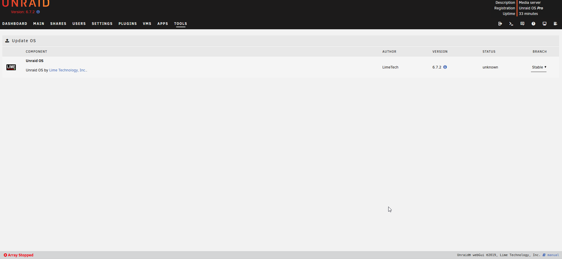

My server is currently running 6.7.2. I went to update the few plugins that I have (CA, cache_directories) and it would appear I can no longer do this from the GUI. It would seem that I need to be running 6.8.3. Is this the latest stable release? (This is what I've got ( "unRAIDServer-6.8.3-x86_64.zip")
I have a very old server. I am wary of changing anything because I'm not in the position to build a new one. I worry about upgrading because of this and the fact my resources on the server aren't high. Do I need to keep upgrading?? It would seem I do because all the plugins change.
I guess I should upgrade to 6.8.3. How is this done through the GUI (I've never done it through the GUI before). There doesn't appear to be anyway in the "Update OS" tab - or will it only show when the array is offline??
I saw this in a post "https://s3.amazonaws.com/dnld.lime-technology.com/stable/unRAIDServer.plg" to use the install plugin area. Will that work?
I saw this "If you are running any 6.4 or later release, click 'Check for Updates' on the Tools/Update OS page." - but there is no button for this (perhaps need to stop the array?)
Tools Tab
Yes if the above doesn't work.

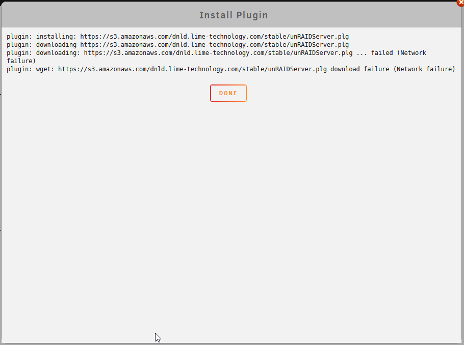

Tried for an upgrade this morning and it failed. There is NO button in the Tools>OS page (that shows as a button) I have to assume the Update OS Text at top left is it. I got a message as below. I am now suspicious that the server does not have connection to the internet. We have just changed our ISP - which meant a new router/modem. The new modem/router is registering the server (and I can login into it through the GUI), but there is NO IP address in the modem interface after the name of the server - but there is after the name of every other computer on the network.
My server has a static IP, which I left unchanged, but I had to change the gateway. I am suspicious that the static IP is NOT in the correct IP range for the new modem/router (which uses a slightly different range ".178" VS ".1").
I have just found a panel in the new modem/router interface where you can add a new device with a static IP. One thing I find a little confusing is the new modem/router has both an IPv4 and a IPv6 setting for each device. Chewing my nails 🤔
Any comments before I do this.
Just let your server use DHCP and it will get an IP from the router that will be compatible with the rest of your network.
Finally got it sorted out.
@Constructor - you are correct. That would be the easy way, but I putty into the server and knowing the IP is a critical part. I found out the same thing had happened to our HTPC (also a static IP and running linux - so putty again) and couldn't connect at all. I tried everything. In the end I connected back to the old router and bingo - away we went. The new router has a different IP range, than the old one as I suspected. I even tried to re-route the old one to the new one but it wouldn't work. Tech is sometimes way too complicated - unless your a genius!

Once I had the IP's all sorted out, the server was connected again to the internet - so I could upgrade via the gui. First time for me.
