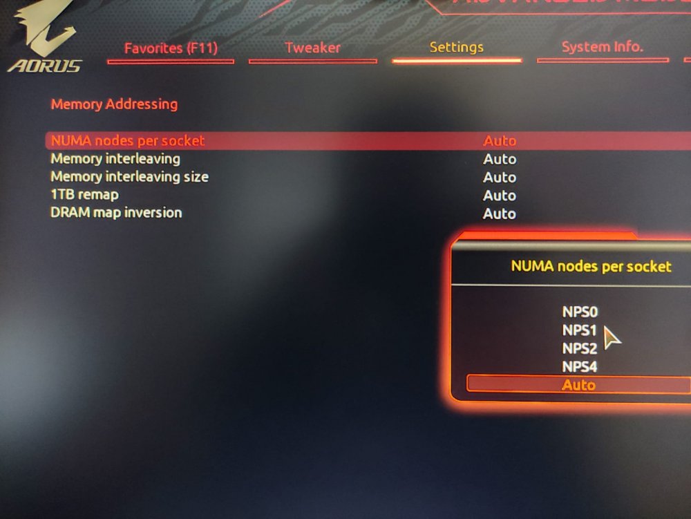

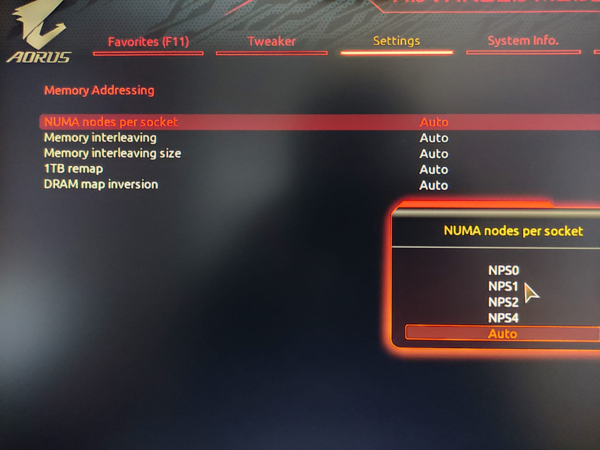

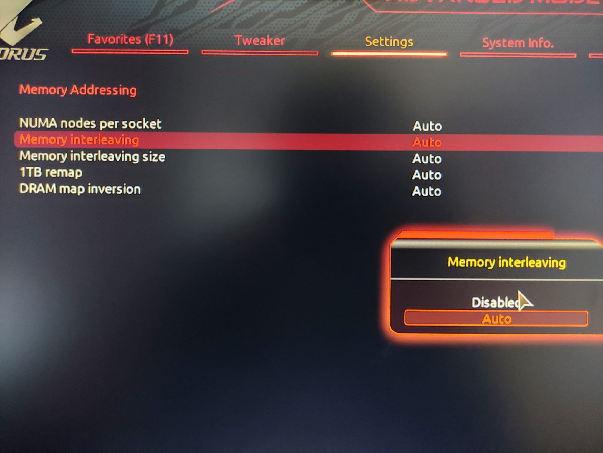

After some reading (that post you mentioned was really usefull thanks), I understand that it is in my best interest for the gaming VM to set the CPU in NUMA mode, and later set the cores of the VM to use the 8 cores of the CCD that the graphics card connects to. That will reduce latency and help in the games that try to push fps to the maximum (like the CSGO case I´m working with).
That said, I have been exploring the BIOS settings, and I can´t find the option mentioned in the post that is suposed to activate the NUMA mode, that being the AMD CBS/DF Common Option/Memory Addressing with 5 different modes: auto, die, channel, socket and none. With Channel being the one that I am looking for.
In my case I see 2 options that (I suppose) are related to this:
1509526841_WhatsAppImage2020-12-27at12_12.56(1).thumb.jpeg.5666a167af0889a6a70f7ddeafbdeb81.jpeg851054648_WhatsAppImage2020-12-27at12_12_56.thumb.jpeg.70c0f78331b7fc02e35f9757d6c617ff.jpeg
I have tried the 8 possible combinations, Memory interleaving AUTO and disabled, and the 4 NUMA nodes options in each case, none made Unraid see more than one node with numactl --hardware. And there is no channel mode to be seen anywhere (either inside AMD CBS or in any other tab), which leads me to believe that maybe the ability to choose NUMA node may be deprecated in thi BIOS version (F31q, the latest one as of December 2020). If thats the case, is this a dead end?
