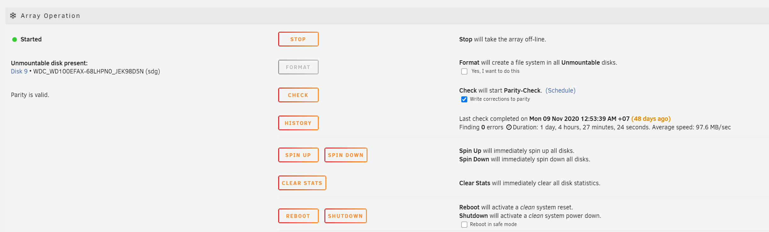

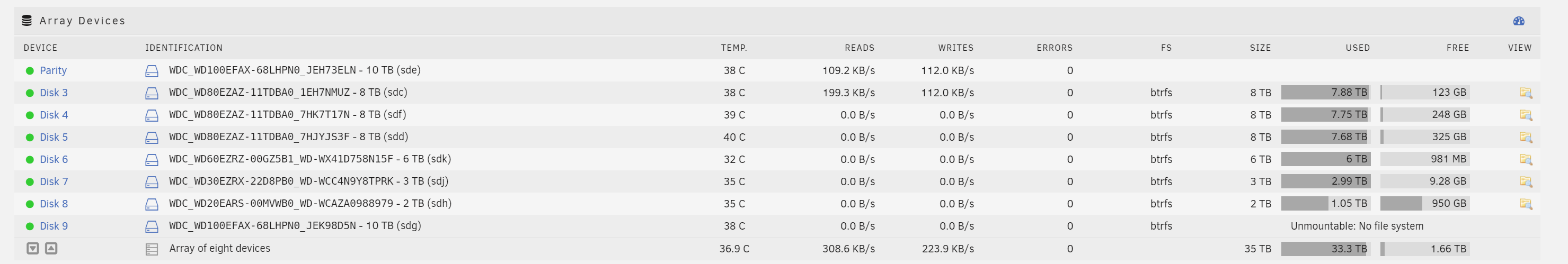

9.Reboot Unraid and now disk become "Unmountable:No FIle System"
Attached the Diagnostic file below
Did I just lost the file on disk ? It strange that the circle status indicator in front of the disk still show green.

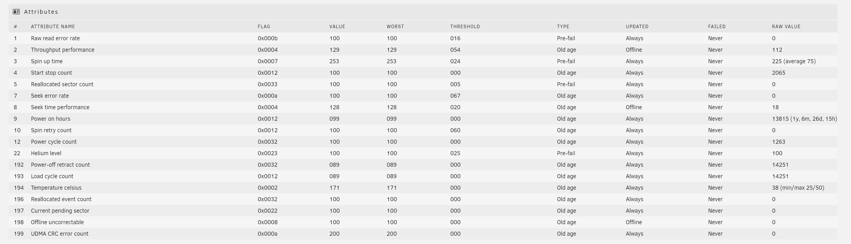

SMART did not show any sign of issue.
Now Unraid asked me if I want to format this disk.
That's the disks status, there is a filesystem problem:
parent transid verify failed on 22183936 wanted 519 found 510
This error means some writes were missed due to unclean shutdown or device issues, and it's fatal, there are some recovery options here, btrfs restore (option 2) is the most likely to work for this.
