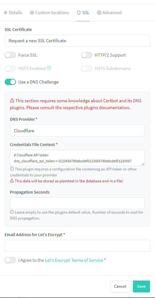

January 3, 20215 yr Author 22 minutes ago, ubermetroid said: I'm not following. How do you use the wildcard cert? When I click on "get cert" it just errors out for me. This is how you'd do a wildcard cert. You have to select Use a DNS challenge and then select who your DNS provider is. Mine is Cloudflare. I had to get my API key from their management dashboard and fill it in replacing that 0123456789... value. Im sure other providers are more or less the same. When it asks for the domain for the cert, you'd do *.your-domain.com or whatever. Of course, you dont HAVE to use a wildcard cert, but if you want to handle say, 10 services, then you'd need 10 certs.
