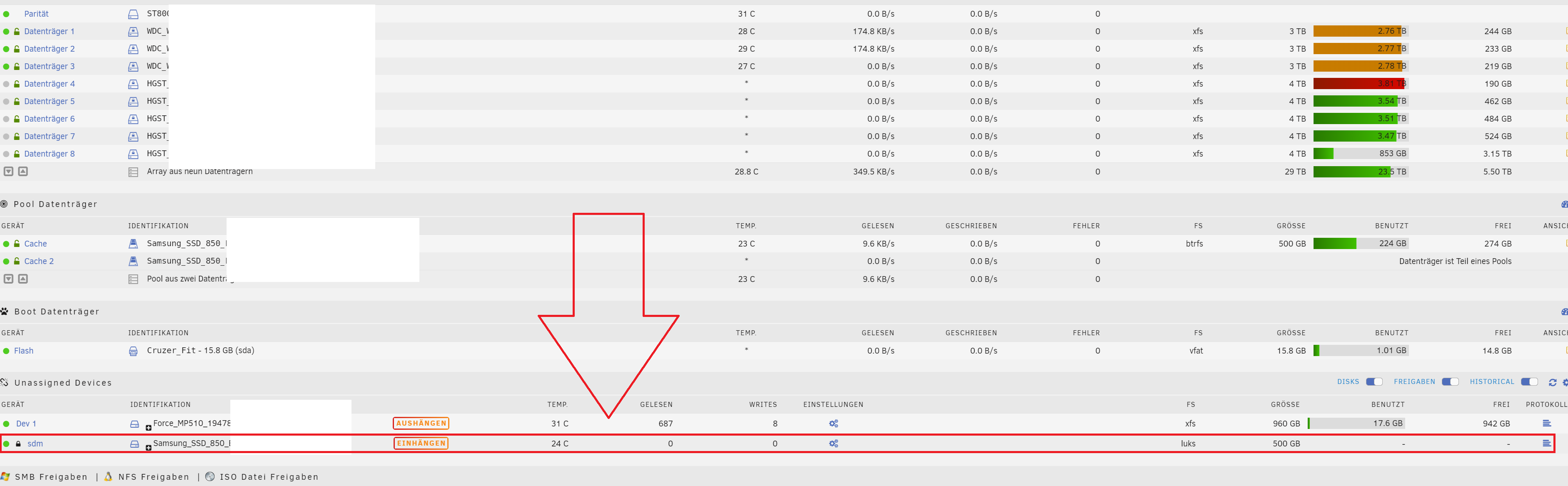

SSDs finally failing
Yeah so i guess my ssds are failing... i just ordered 2 new Samsung SSD 860 EVO 1TB, SATA
See the log.
I want to have redundancy again (thats why 2x 1TB)
1. so lets say i move all my data from the ssd to my array.
2. swap the 2 ssds and move it back? did i forget anythign?
I really wonder why unraid didnt said a single word to me (no notice, no email, no nothing) only thing i saw was that the drive suddenly showed under "unassigned devices"...???
I thought if a drive drops out, i get some notice?! System itself seems to run normal...
