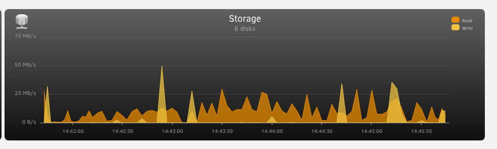

my disk is going crazy while there is no time machine backup running, looks like it comes from reading rather than writing
i tried to logoff from the server but the disk activity continues
while time machine is not running

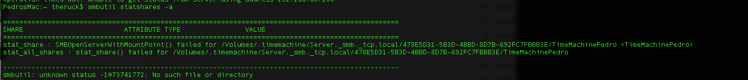

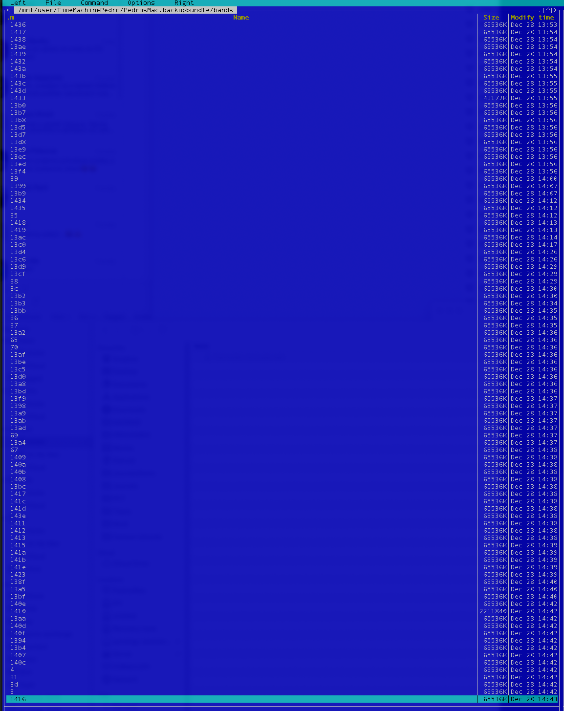

i noticed that my sparse bundle files get updated
is it some sort of indexing happening? if so, how is that possible if i have no connection to the server? and why is it editing the sparse bundle files?
any idea how to explain and avoid this?
looks like it is timemachine spotlight indexing indeed. and it looks like i am screwed here. so need to improve the unraid performance as this is crazy slow with these speeds
