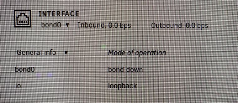

I just bought and installed a LSI-92078-8i in my Unriad 6.8.3. The card is flashed in IT and all the hard drive show up no problem but when the card is installed the onboard ethernet stops working. I'm at a complete lost as to why this is happening. I've gone through the few troubleshooting guides before posting with no luck fixing the issue. Any help would be greatly appreciated.
I have a Asus Prime B365M-A with the latest BIOS version 1605. The motherboard has only one PCIE x16 3.0 slot which the card is installed in.
With card removed.
With the card installed.
