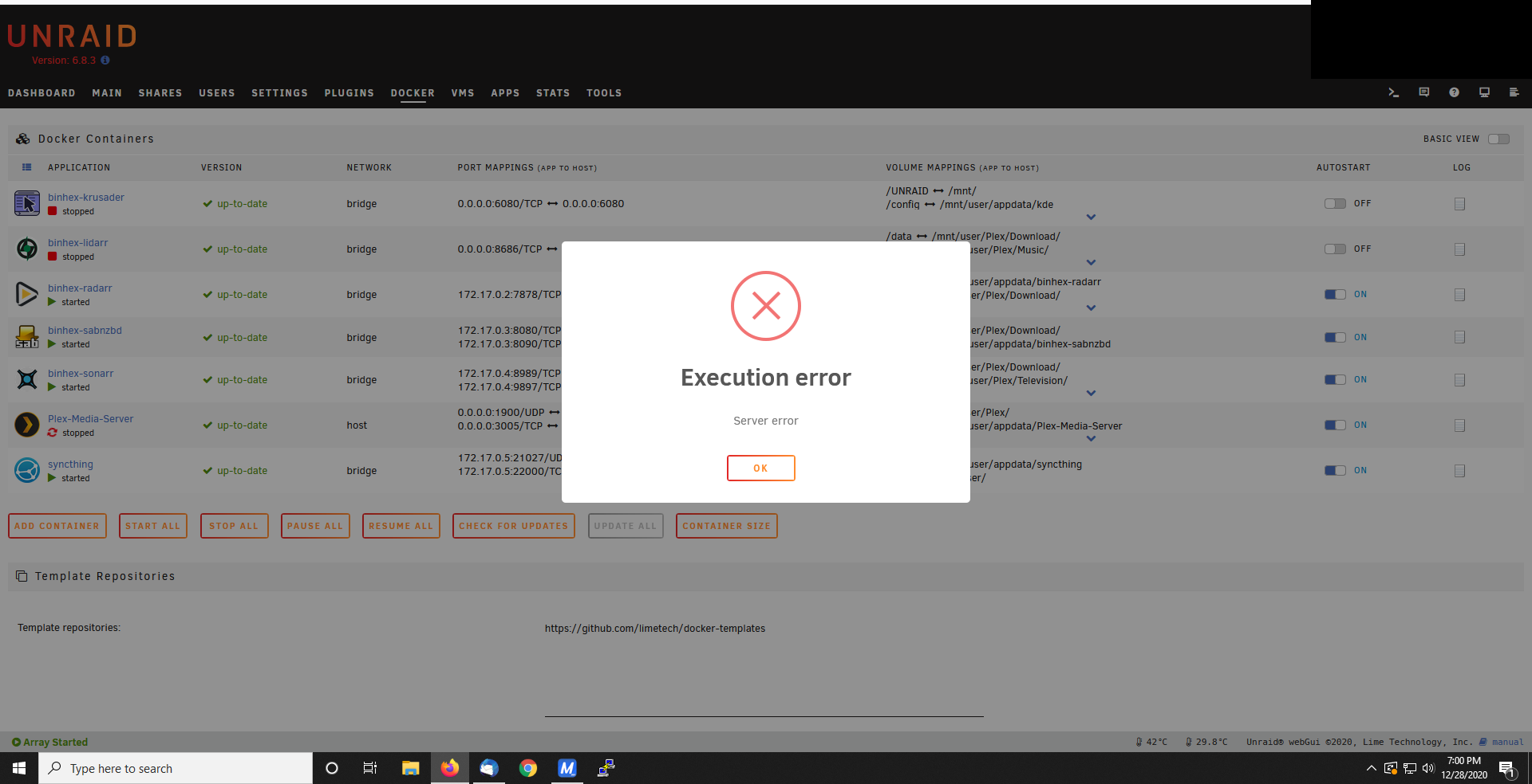

Made edit to Plex settings, now I have a server error
While trying to solve an error in this post I made an edit to the Plex docker settings.  I stopped the docker applications, stopped the array, rebooted the array, and started the containers again.  When I went to start I got a server error. Removed the docker application, including the image, and re-installed the application with the same settings.  same error.  Not sure where to go from here.1422662783_Plexedit2.thumb.png.991fc3dbf3d89c582b7c056bb936b155.png

Per FAQ I ran the
docker start cops
command and came back with the error
Error: failed to start containers: cops
which doesn't help very much
Ok, did it this time with right docker name, get the following:
Error response from daemon: error gathering device information while adding custom device "/dev/dri": no such file or directory
Error: failed to start containers: Plex-Media-Server
Solved. Removed the dev/dri path and it all works now.

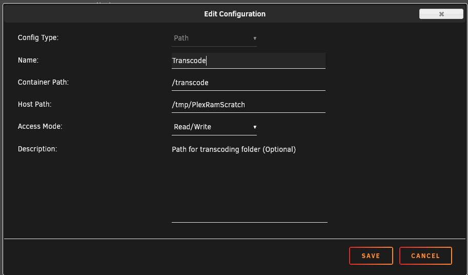

FYI - in addition to loading the i915 drivers from the go file, I also set up a folder in /tmp (RAM) specifically for Plex transcoding.  This allows Plex to manage its own limited RAM space and delete files as needed.  Just pointing transcoding to /tmp can result in crashing the server if it uses all memory.  This has happened to some.
I also have this in the go file.
mkdir /tmp/PlexRamScratch
chmod -R 777 /tmp/PlexRamScratch
mount -t tmpfs -o size=16g tmpfs /tmp/PlexRamScratch
I set up a 16GB PlexRamScratch folder but 4-8GB is usually more than enough.  I give it more because I also have TV records through HDHomeRun using that folder while recording and if Plex is doing its thing at the same time, a bit more RAM is needed.
Plex container setup looks like this:
