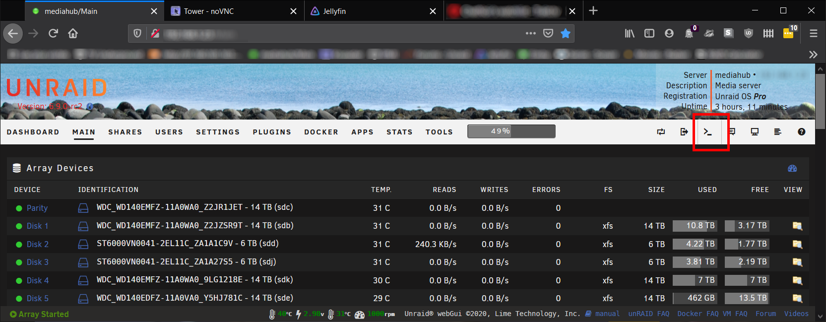

You can easily open the console with the >_ icon on the top right:

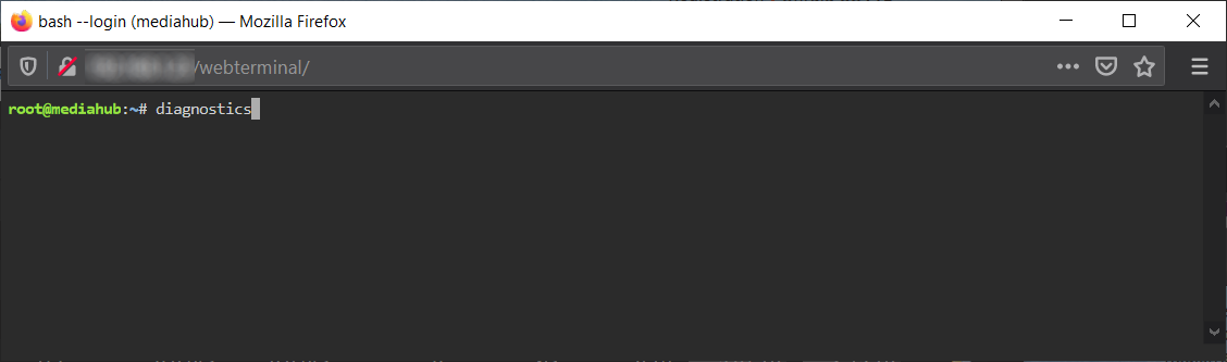

then type diagnostics
press Enter and the diagnostics file is created on the flashdrive.
