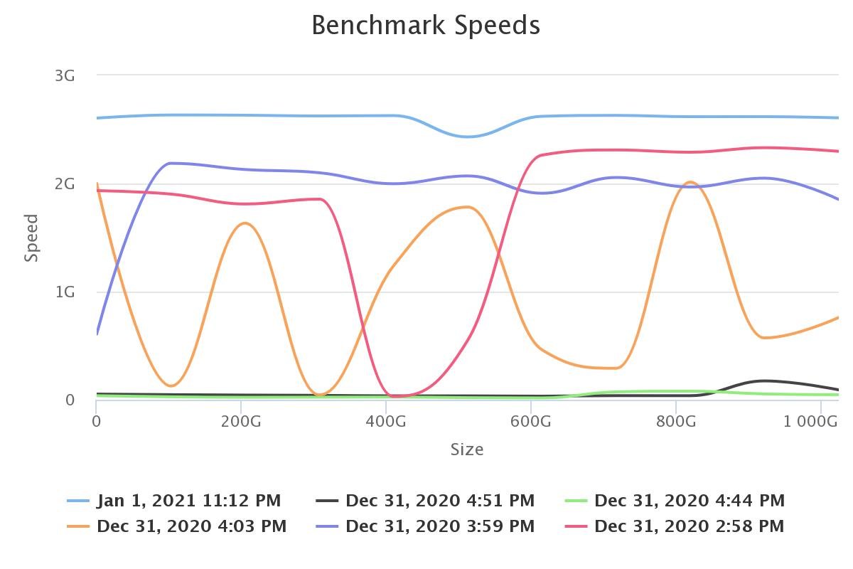

So after some more testing I found out that my nvme drive was acting up. I would sometime benchmark fine at other times it has atrocious speeds, down to 40mb/s. I had backed up the cache drive and reformatted it from btrfs-encryted to xfs-encrypted. Still had the problems after I moved everything over. I decided to replace that drive with a sata SSD and since the performance of both dockers and vm's is back to normal. Smart data doesn't show any problems for the nvme drive. The weird part is that I tested the drive once again in the unassigned devices and it performed beautifully.
Question is the drive bad (as in hardware?) or was it something to do with its place as cache drive and unraid?
How do you verify that the hardware nvme is bad besides smart data and simple benchmark?
Drive Benchmark is attached.

Hello @LittleLama... The problem was a bad nvme drive...while the drive worked somewhat it had slowed down to a crawl...I RMA'd the drive and replaced it and afterwards everything worked fine.

I too thought that it could be a btrfs problem. I formated the drive in windows and still had a problem with it. The next SSD installed I used xfs and had no problems since.
