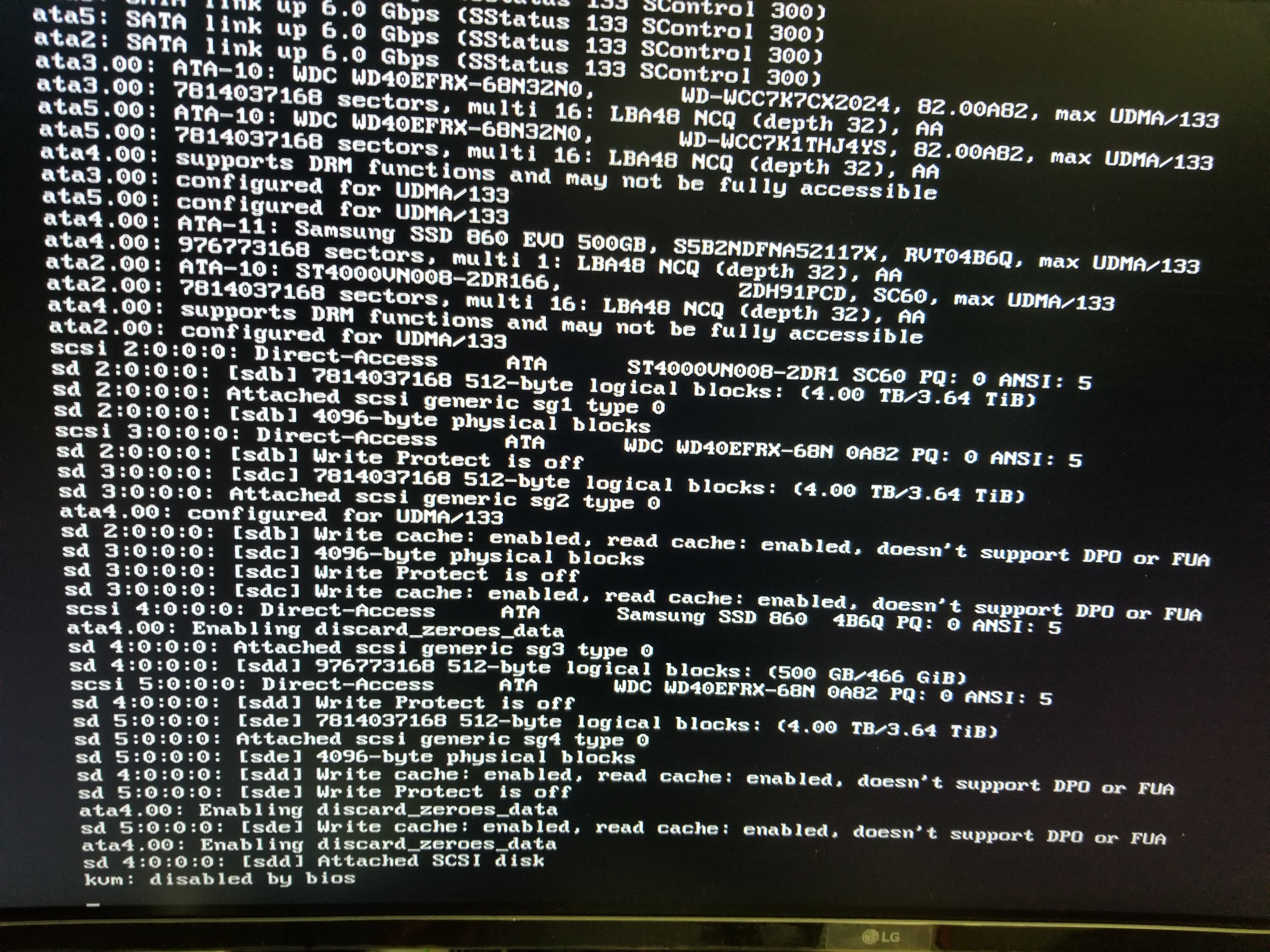

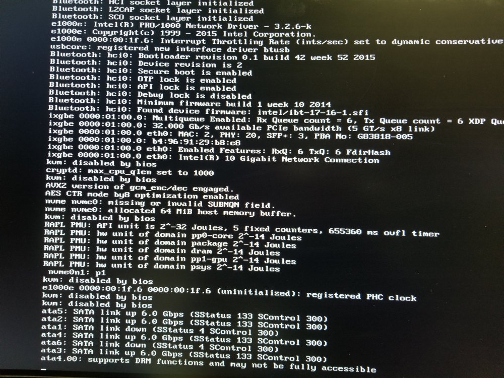

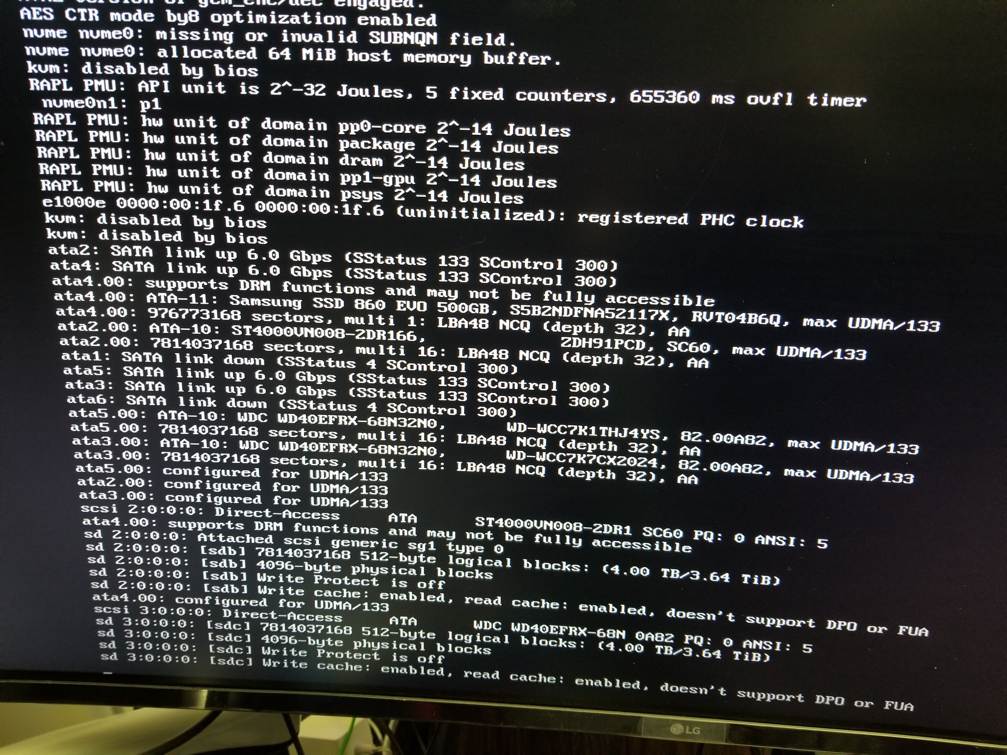

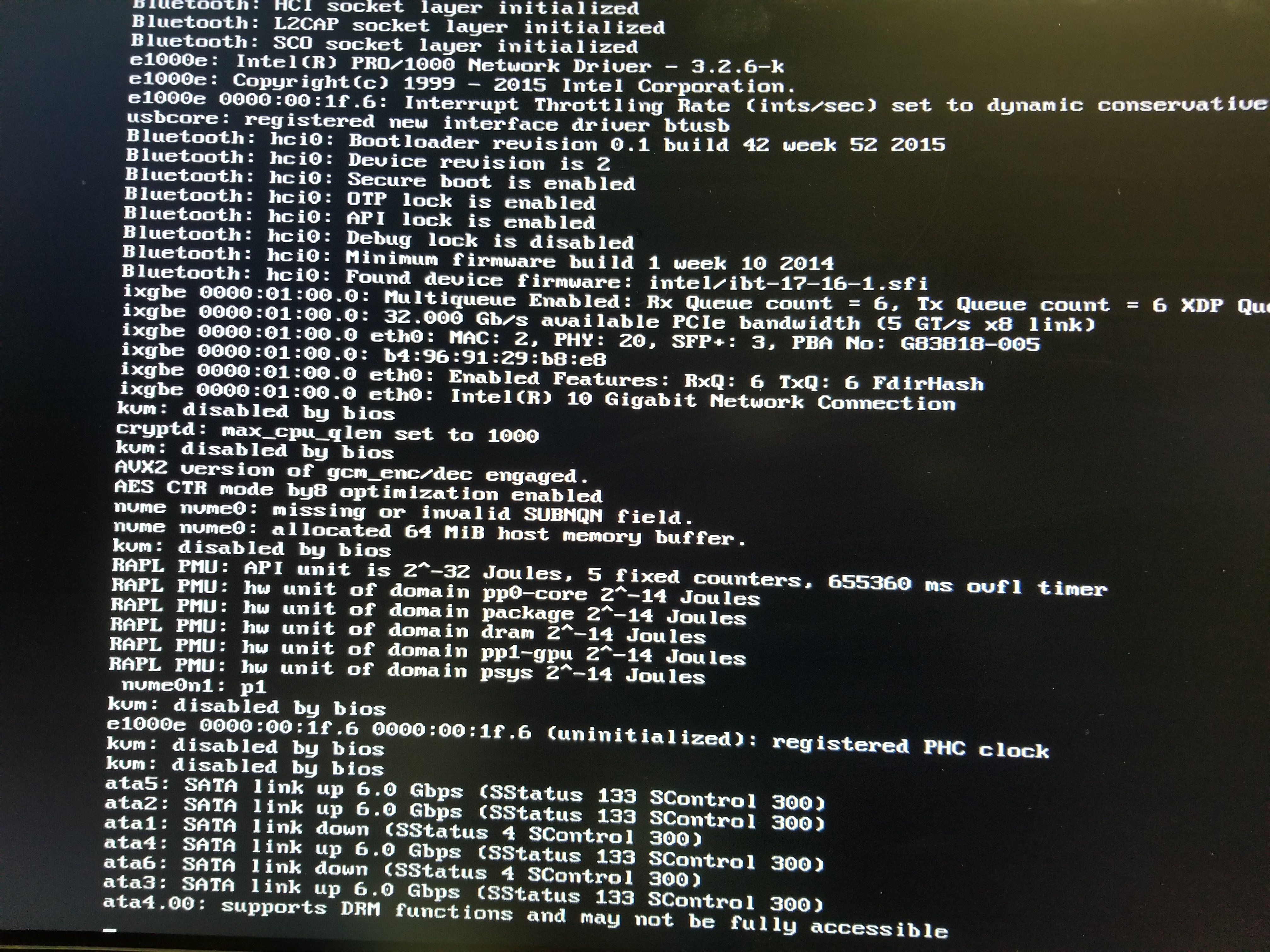

I just added a 4tb hdd and a 500gb ssd. I replaced my CPU too. All seen in the bios. Once the install os screen comes up and I selected. It froze up
See write cache enabled doesn't support dpo or fua keeps on coming up
Please help

What are you selecting from the Boot Menu? Have you tried other selections?
i selected unraid OS, it froze, boot incomplete
Restart...I selected unraid OS GUI mode , boot incomplete
Restart...I selected unraid OS safe mode no plugins no GUI, boot incomplete
Restart...I selected unraid OS GUI safe mode no plugins, boot incomplete
Restart... I selected memtest, it said loading ok, and just restarts.
