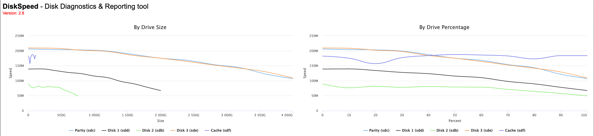

some fade away is normal. but from 200 to 50 it is probably some other activity using the drive. 4TB rebuild took me 8 hours on the HGST disk drives for me starting at 200 MB/s ending at 100 MB/s corresponding with below disk speed test.
