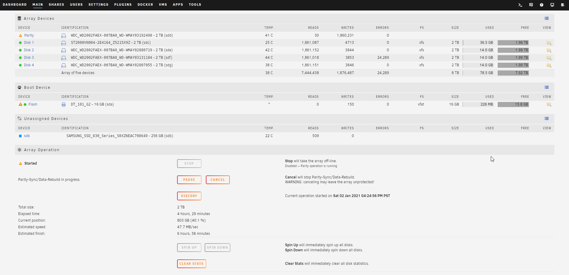

I very much like what I see with unRAID so far.  I'm setting the drive array up with 5 x 2TB drives (not 1.5TB as I stated earlier) - 4 data drives and 1 parity drive.  But now when unRAID is preparing the drive array, I see one of the drives is showing some signs of having problems.  The error count currently shows around 24,000.  What would be the smart thing to do about this?  Should I remove the drive immediately, or will the bad sectors be flagged so the drive is safe to use?
Also, I see it takes ages and ages with the Parity-Sync / Data-Rebuild process.  It's been chewing at it for over four hours, and it says it has several days(!) left.  This is a new array and the drives have been formatted.  Why does this step take so long?  Is something wrong here (e.g. if the troubled drive mentioned earlier cause problems)?
734303955_2021-01-0305_54_03-Tower_Main.thumb.png.edcbbf5be86c84efd4d8179addafc371.png

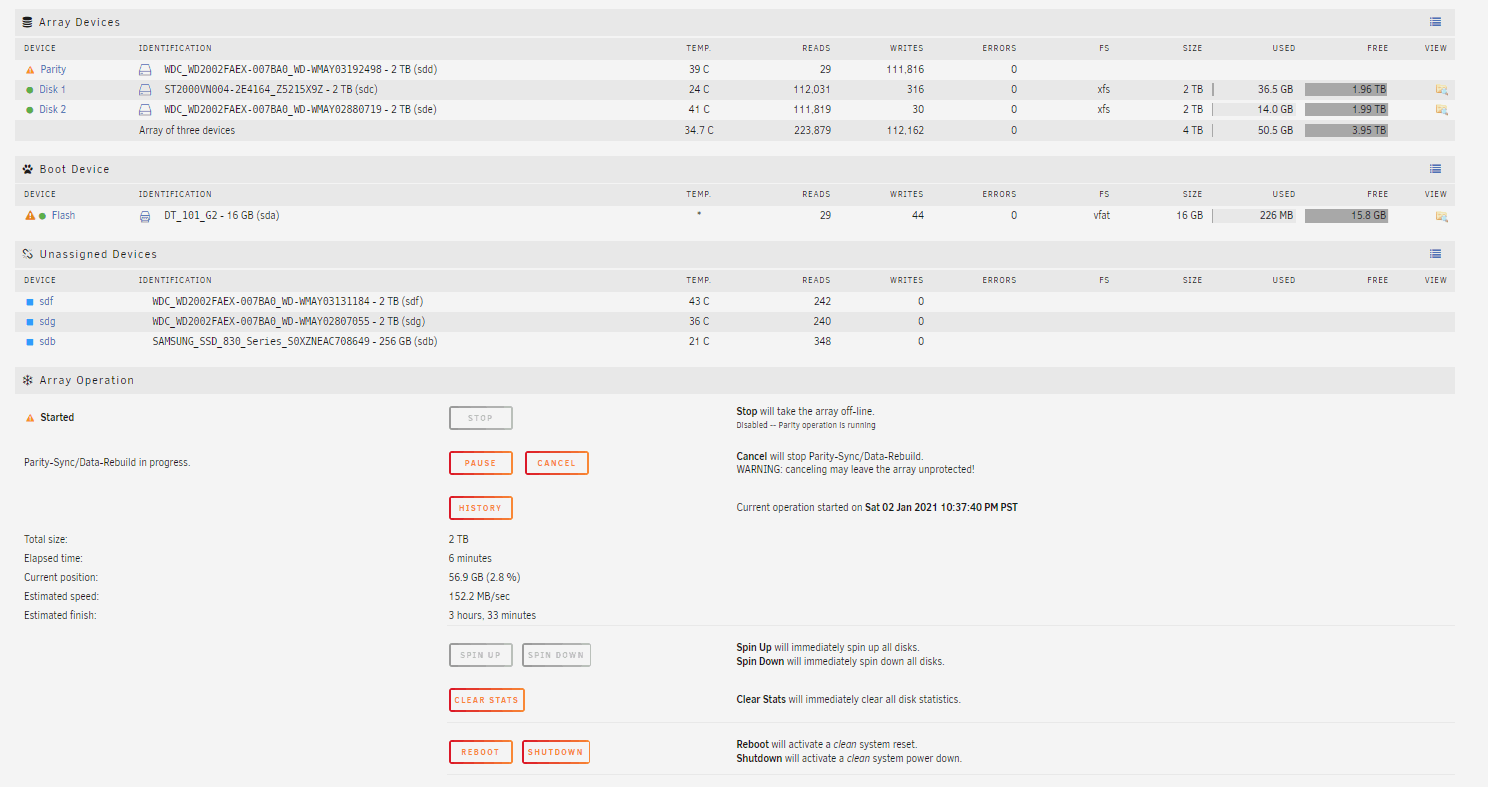

I read up a little on the SMART tests, and ran SMART short tests on all the drives.  Two of them came up with errors during the tests, so I excluded them from the drive array, and restarted the parity build.  Now it's steady on ~150 MB/sec and should be finished in about three hours.
In regards to the drives, they are all fairly old drives that I bought for a Synology NAS perhaps 8 or 10 years ago.  So time to buy new drives, I'd say...
