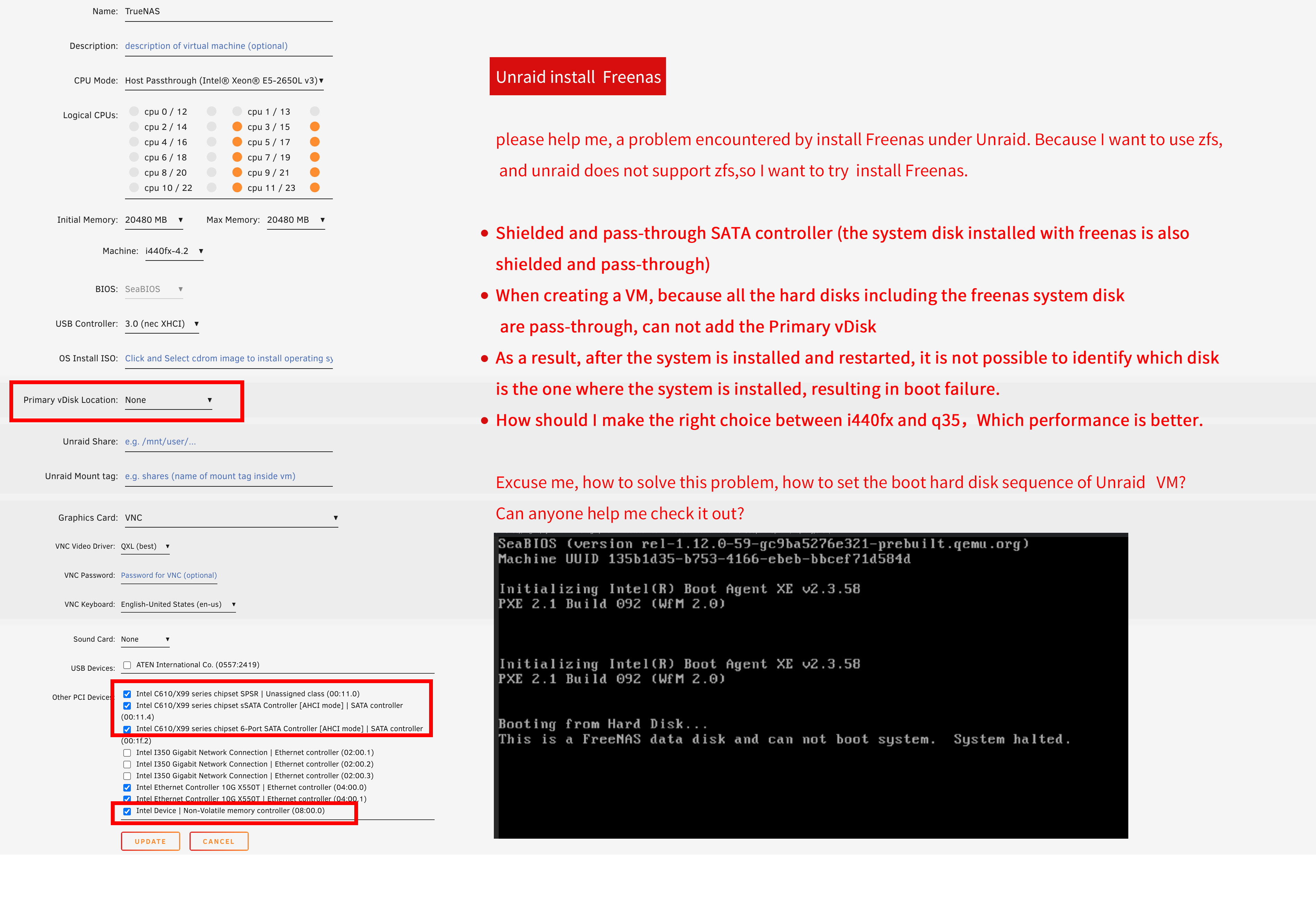

Because I want to use zfs, and unraid does not support zfs,so I want to try  install Freenas.
  1. Shielded and pass-through SATA controller (the system disk installed with freenas is also shielded and pass-through)
  2. When creating a VM, because all the hard disks including the freenas system disk are pass-through, can not add the Primary vDisk.
  3. As a result, after the system is installed and restarted, it is not possible to identify which disk is the one where the system is installed, resulting in boot failure.
  4. How should I make the right choice between i440fx and q35,Which performance is better?
Excuse me, how to solve this problem, how to set the boot hard disk sequence of Unraid VM?
Can anyone help me check it out?
Thanks!

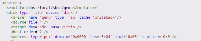

Or you can just add
<boot order='1'/>
under the  </source>
of the correct drive you want to boot from

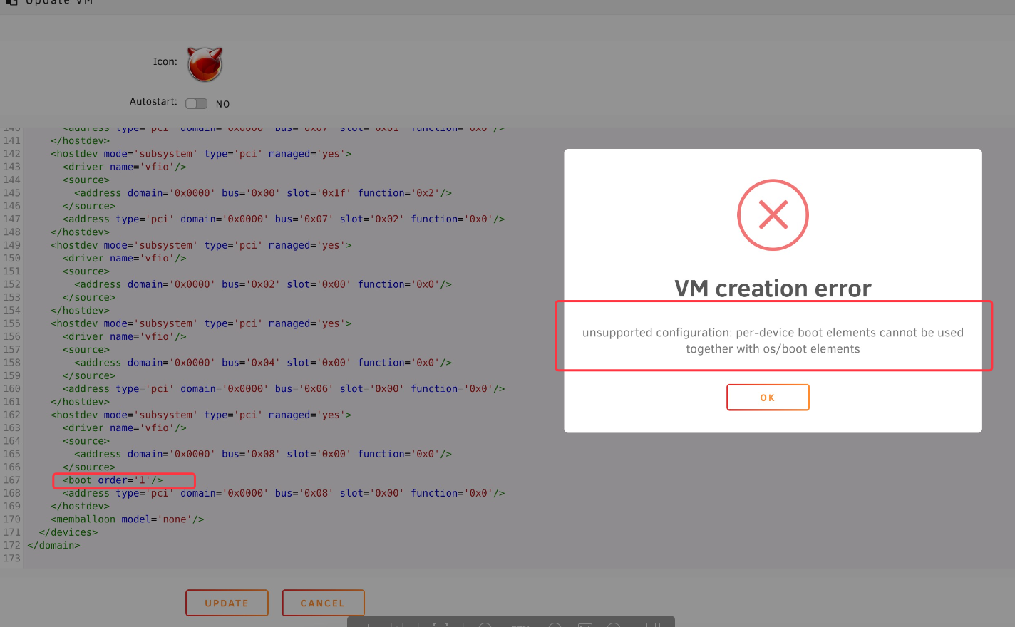

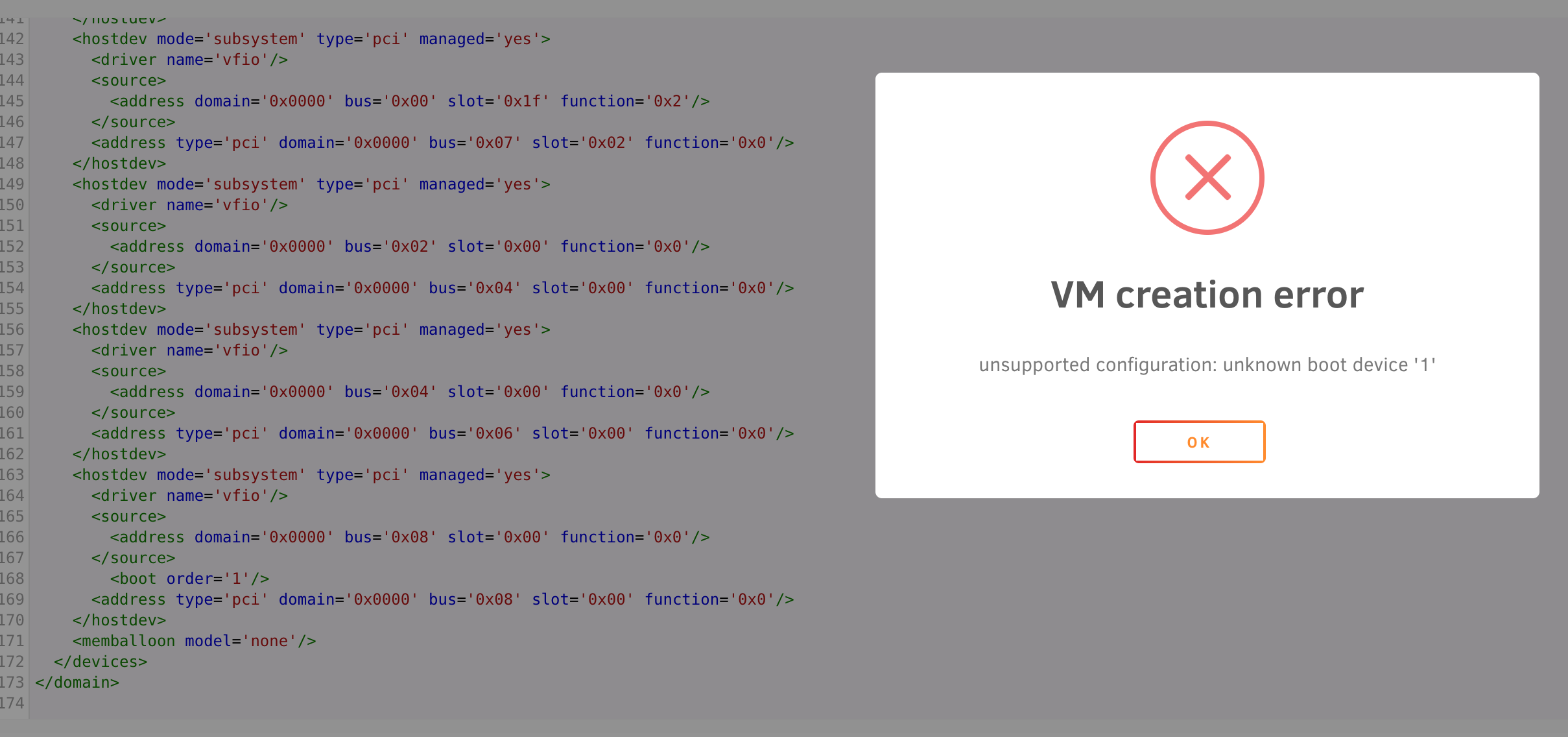

I tried adding  <boot order='1'/>  under the  </source>.
But there was an error.
I want 08:00.0 to be the first boot disk of freenas.

Sorry for the delay, work got super busy. Try this.

      </boot order='1'>
      <address type='pci' domain='0x0000' bus='0x08' slot='0x00' function='0x0'/>
    </hostdev>
    <memballoon model='none'/>
  </devices>
</domain>
Changed your <boot dev='1'/>       from hd
Added boot order line.
Edited by runamuk
Thanks for your reply.
Changed  <boot dev='1'/>      from hd
Added  <boot order='1'/>
But it does not work.

Ok I am home now, no longer trying to do this from my phone.
This is what i would like you to do.
Make a V-disk
(don't worry we wont be using it)
This will change the XML to include the sata driver.
after that we will add the boot priority to the freenas hardrive and change the boot priority of the vdisk
You can repost the XML after adding this or do the following
 and then change the boot order  of the vdisk
Edited by runamuk
Make a V-disk
Great.
It worked and successfully set the boot sequence.
Thank you so much for your help.
