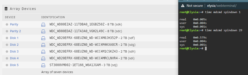

If when the drive is spun down (according to Unraid) I go to spin it up by selecting the grey circle on the Main tab, it "spins up" in 1 second. On the other hand, if I then spin it down, and then up again, each operation takes ~8 seconds.
I've tried to demonstrate this in the Unraid terminal;
If I issue a spindown command to a different disk that is spun down (not on the LSI card), using the time command, it takes 0.005s.
If I then issue the same command to this HDD, /dev/sdc, it takes ~0.600s.
Below is a snippet of the log again which shows my spindown command and the drive spinning itself up unbeknownst to Unraid.
Each time the block starting with "attempting task abort! scmd(0000000016cce60b)" occurs, the drive is now spun up, as the spindown command will take ~0.6s. I did this twice in succession at 22:53:27 and 22:54:05. If I issue the command again quickly (at 22:54:10), the drive has not yet spun up, and the time for the operation is 0.003s, and there is no "Power-on or device reset occurred" message.

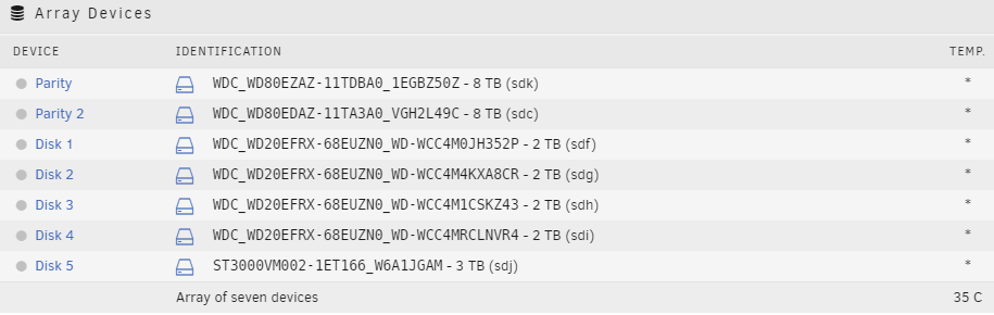

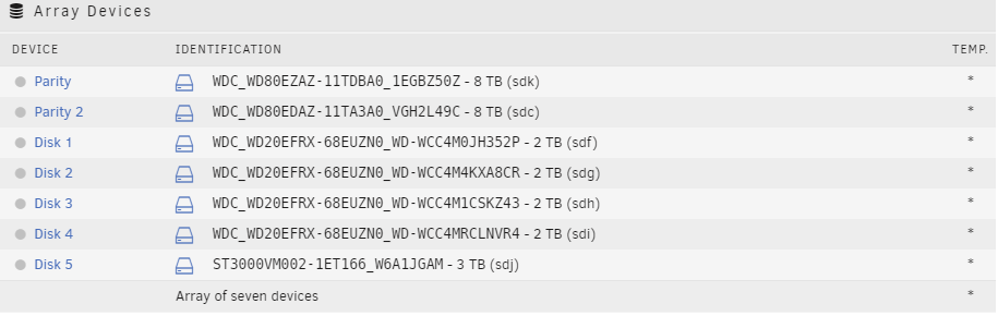

Also, while the GUI shows the drive is spun down, it reports an average temperature of 35 C (which is the temperature of that drive)
It only changes to a * when I then issue the spindown command
