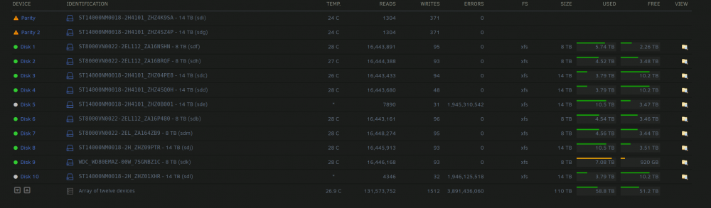

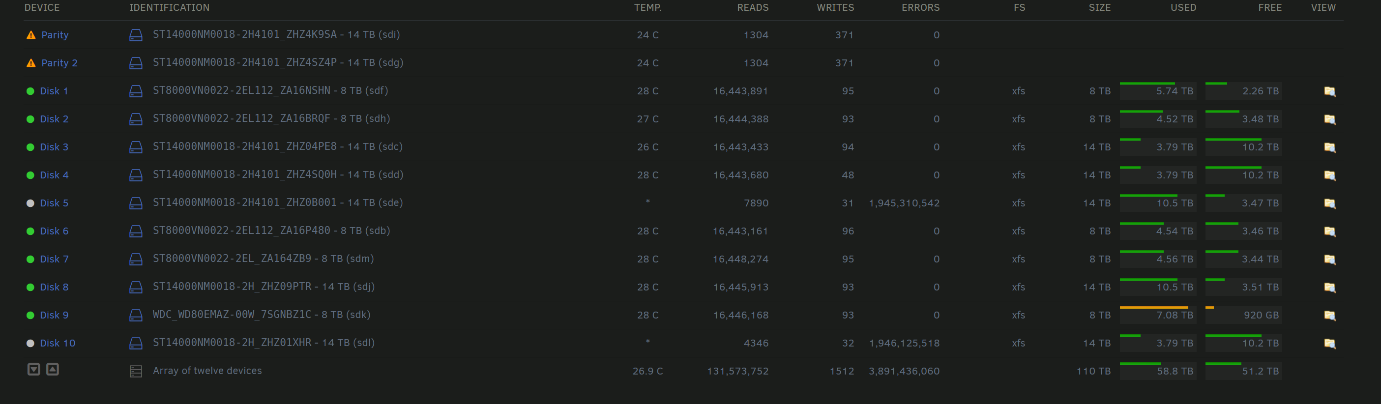

I recently moved to a new house, the server has not been on for a couple months. Today it booted and I noticed 1 drive disabled. Figured it was a loose sata cable from transit. I installed 6.9.0-rc2, updated all my plugins and restarted. I swapped some sata cables around, this time 3 drives were detected with read errors and unable to write to the drives. I ended up using new config and trusting all drive assignments to recover. Currently the parity rebuild is half way done and will take another day.

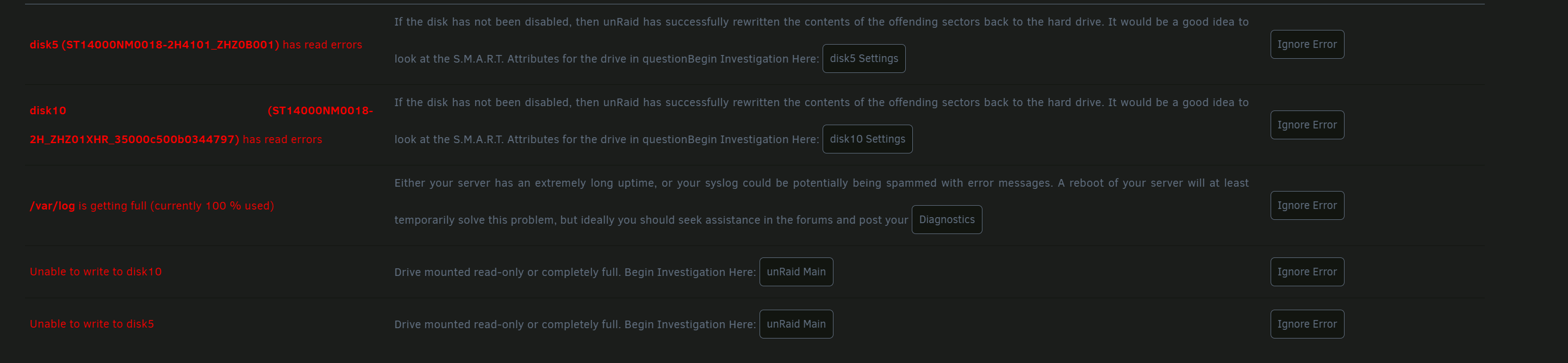

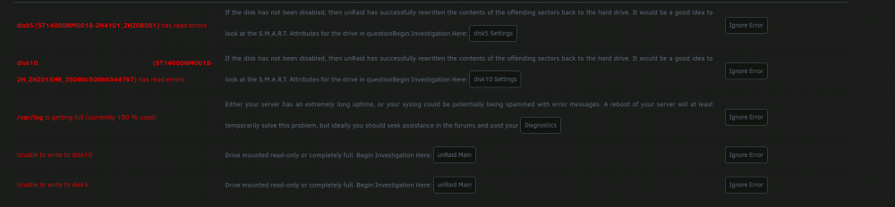

My 15GB log is 100% full due to drive errors from 2 drives, which are currently in standby. What is the path to resolution for those drives? I read somewhere that standby mode means that UNRAID was able to rewrite the offending sectors and thus did not disable the drives, so will it reenable them after the parity rebuild is complete so they can be overwritten?

Multiple disk errors may be a power or controller issue. If you were mucking about in the case it might just be a case of bad connections on multiple disks.
im going to try a direct sata connection bypassing the hba.  I strongly suspect a bad connection on multiple drives due to the nature of my ....installation.  I do not have a clear understanding of the criteria when UNRAID decides to disable a disk or force standby (disks will not spin up) is there documentation for this feature somewhere?

Unraid disables a disk whenever a write to it fails, because it is out-of-sync with the array at that point and needs to be rebuilt. You can't have more disabled disks than parity disks.
Your screenshot is showing both parity invalid because they are being rebuilt, and it is showing disks 5 and 10 not spunup because it can't communicate with them.
