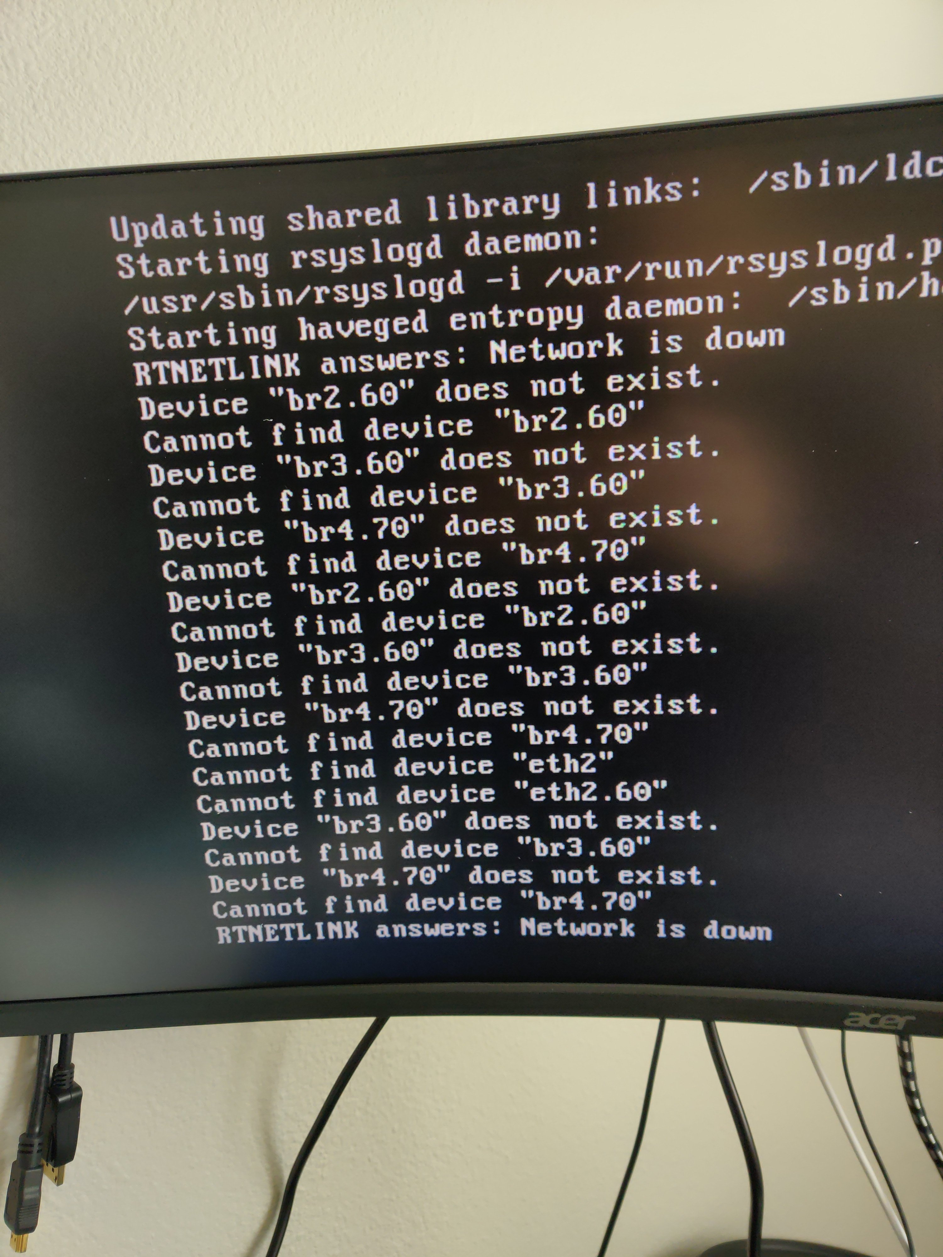

If that's generally correct, how can I delete br2.60 and maybe even also get rid of eth2 so that I can keep my Intel NIC ports contiguous?  On a separate, but possibly related note, I've been seeing additional messages about devices and bridges missing (pic attached), though based on my config with VLAN 60 on eth3 and VLAN 70 on eth4 at least those SHOULD be there and do appear to otherwise work fine, unlike br2.60.

So I just decided to delete the network.cfg and start over.  It got rid of the br2.60 issue, but I still get the warning on those other items from the pic above.  It's been that way for a while and it's worked fine, so I guess that's just an Unraid issue with the timing as it brings things up or something.  I had to change the networks for my containers to reflect the new ones, but they're all working now, too.  Looks like the last challenge is my VM, which doesn't like something about the change.
